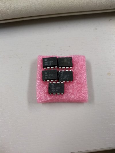

The new epoxy backing is strong enough, but I will conformal coating this repaired area of the board for dust/moisture resistance. We use a flexible silicone coating which doesn't offer much mechanical resistance but does offer excellent moisture resistance

Let's hope some industrious person hasn't taken some 555's and "re-branded" them!
Nope, discontinued product...^^^^^ do they not make them any more ?
Hahaha, yeah, let's hope not.Let's hope some industrious person hasn't taken some 555's and "re-branded" them!
