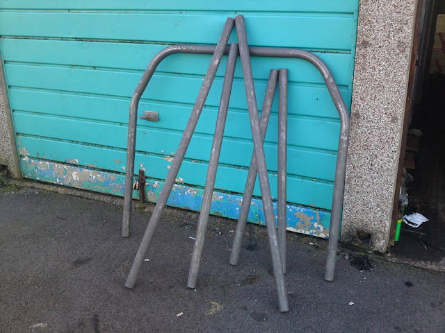

Glad to say that the cage has been ordered so now I can get back on with this project. Also here is a quick capture of the FEA which I performed on the cage design.

From today, in went the rest of the cage and the seats just to ensure that there is enough room and also to get the harness points correct. Very happy with today and hope to finish polishing the frame. Hope to be placing the roof skin on soon and then everything from there on is easy
I added a B pillar attachment to both sides of the main hoop as another fixing point and then I started to polish the roll cage and the welds
