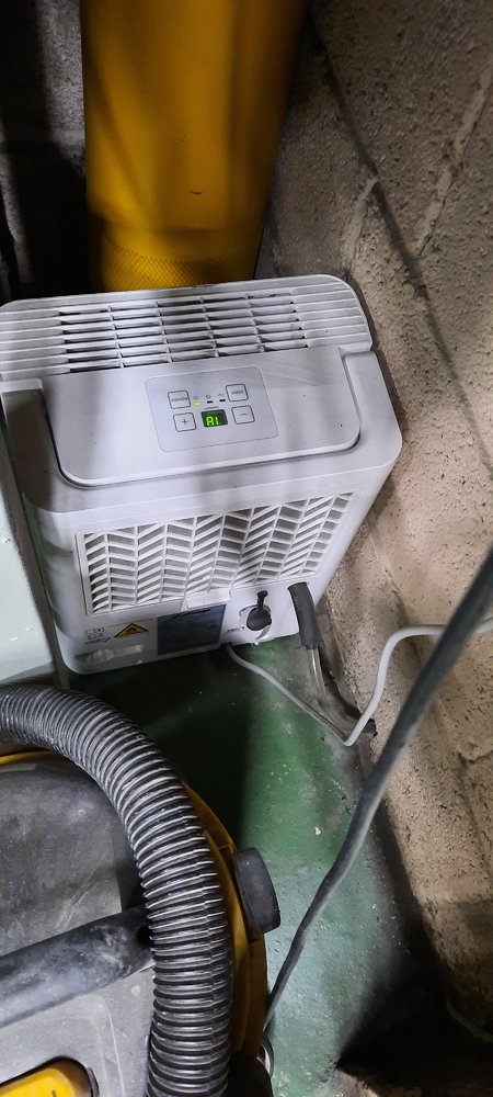

as the temperature had dropped below 0C and frozen the water in the outlet pipe.
That's what I had on mine this morning.In my old stone-built workshop, condensation was terrible. The best non-powered defence I found was to drape an old cotton bedsheet over the lathe and mill.
That's why I have a heater in the workshop now. The fins iced up on mine last year. A small heater simply keeps it at a tolerable temperature for the dehumidifier, in there.

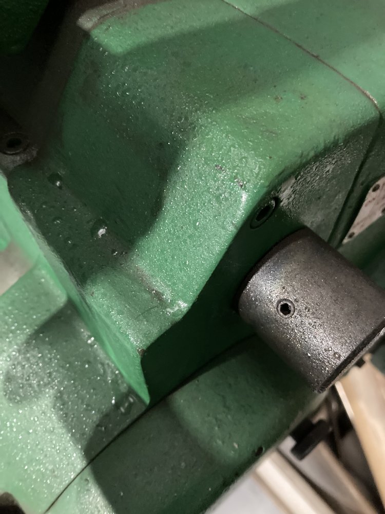

It does make me feel a little betterIf it makes you feel any better, mine is just as bad. The only thing that seems to have escaped is the surface grinder as I keep it soooooo well wrapped up when it's not in use.
I have a lidl plastic motorbike cover over my myford and it stops the moisture condensing on it.its pretty obvious the outcome after a hard few days frost. it gonna thaw and soak everything it will probably happen again shortly unfortunately. might stick a lightbulb under my myford lathe with a cover over it to stop it as its in mint condition and i got it from new 52 years ago the others are covered but it will still happen
That’s very true! I can’t think what else it could be. I’ve only noticed this happening within the last 3/4yrs I’d sayA through draught can be a bad thing, as it will bring a constant supply of moisture-laden air into contact with cold machinery, during weather patterns similar to those experienced over the last few days. The machinery will end up warming faster in a through draught, but not before it becomes dripping wet with condensation.
