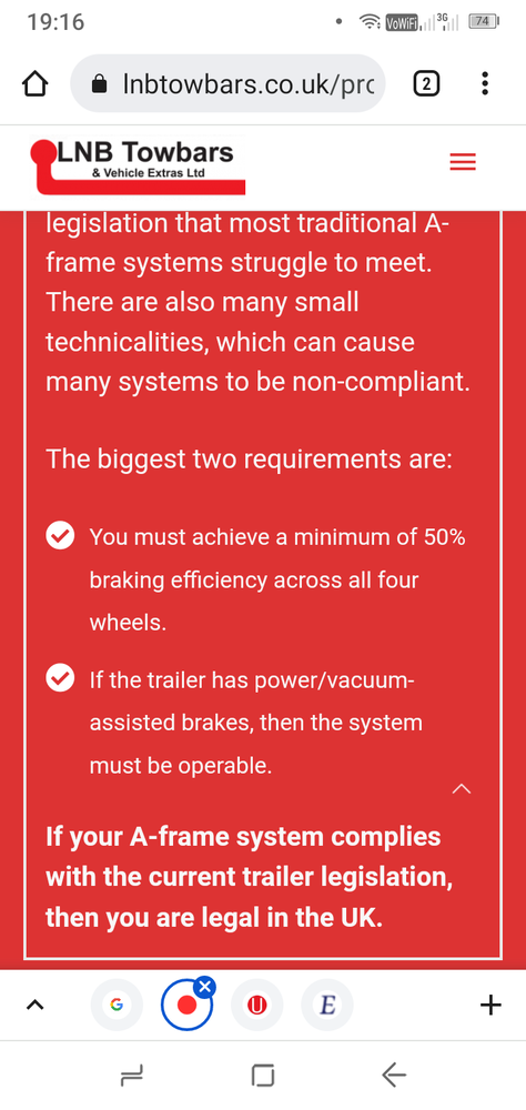

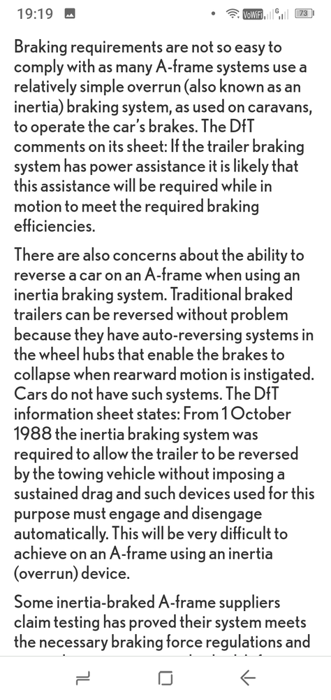

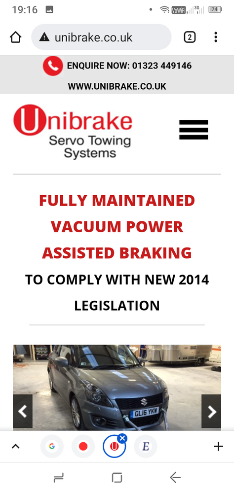

Um., none of the A frames I've seen have servo assistance. They operate in the same principle as a trailer brake - the overrun cylinder in the A frame pulls on the car's brake pedal which in turn activates the cars normal brakes. Without the towed cars engine running you get no servo assistanceLook at car A frames. you cant have a non servo assisted one as the over run does not create enough "pedal" force.
