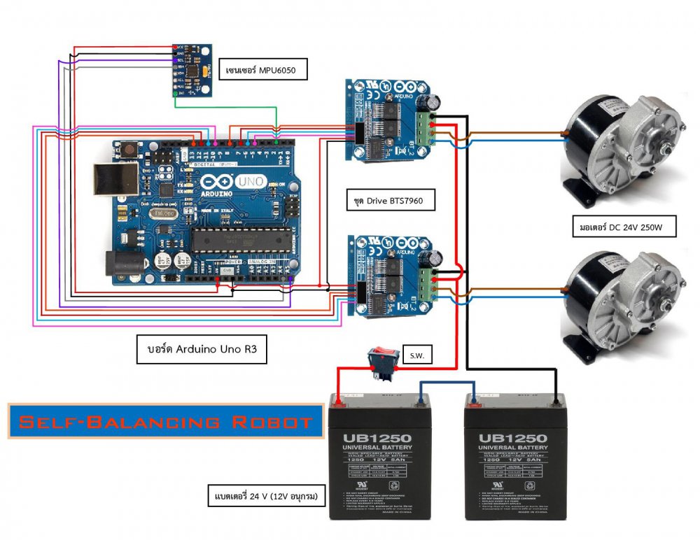

My first version took 3 months before I got it going - main problems were glitches on my custom motor controller and getting motor and wheel aligned.Hi Ovaltino...and well done..you've beaten me to a working segway!!
Yes, I now am using exact same components. But I am using 2X MPU6050. One for board tilt, and one for steering. I think it is much better than using a potentiometer, and at only $4 from ebay, not much more expensive.You are using the same motors, wheels, motor controllers and I presume Arduino Mega?
What giro/accelerometer are you using..we have the MPU6050.
I will post my code, but first I will change it to work with the BTN7960 controllers.
