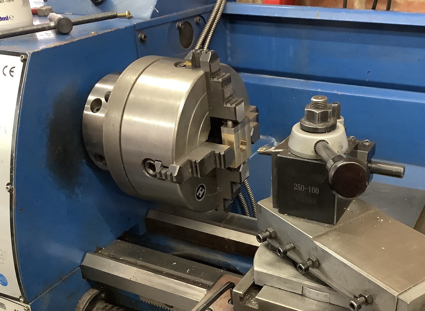

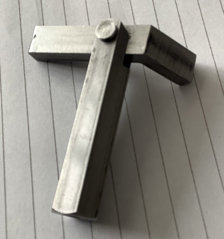

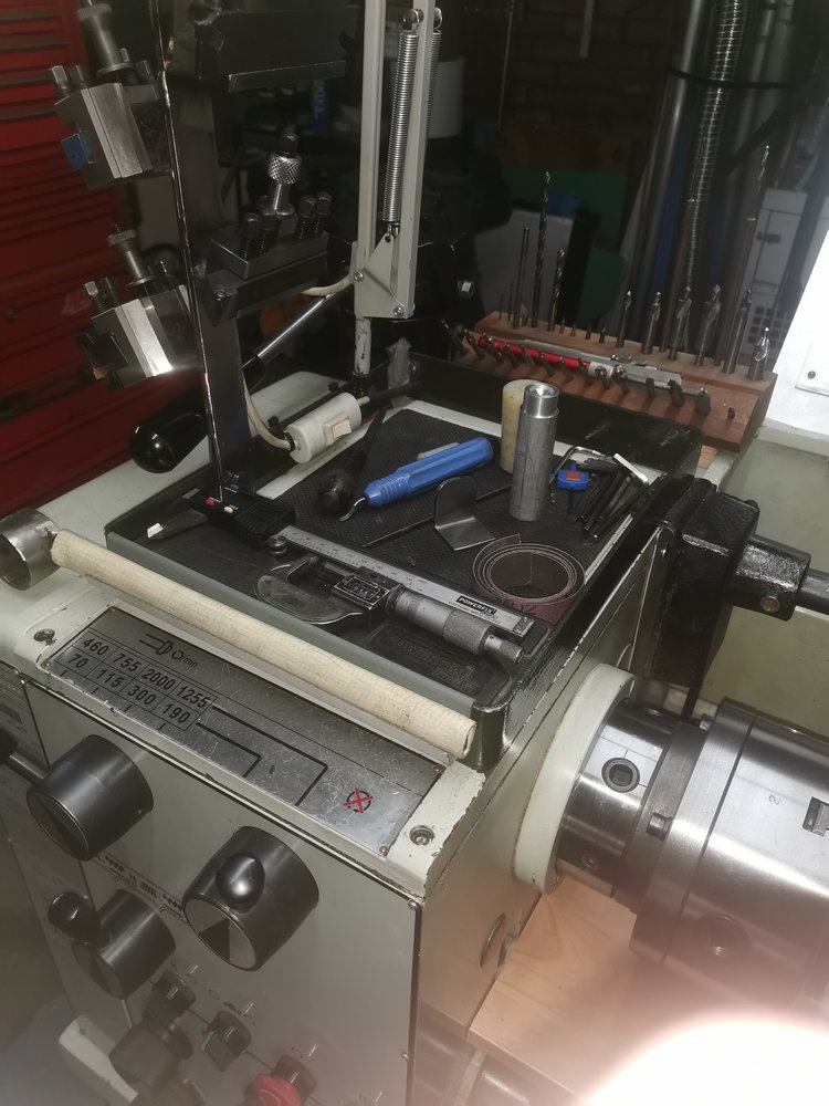

have a good look at the sliders on this
this is while in use
You mean, 'so things can fall on to the rotating chuck? '/Hate lathes with no raised edge behind the chuck.
I always make a fence around the head stock if flat.

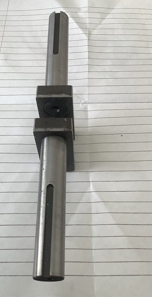

did you cut them keyways? nice jobContinued…….

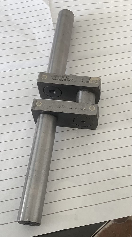

Finished the crankshaft today….
A pressed assembly, then cross drilled and pinned, with the pins silver soldered in….
The webs are black mild steel, look to have been laser cut/profiled. The main shaft and crank pin are made from EN3A….bloody hard stuff! When it came to cutting the 4mm keyways….had to use a Carbide end mill…
View attachment 421488 View attachment 421489
Yes, milled out with a 4mm Carbide end mill….nice and sloooowww….plenty of lubricant and keep clearing the swarf….EN3B seems very hard to cut..did you cut them keyways? nice job
I don't like using it. I bought some 'bar ends' from ebay that were supposed to be EN1, but I'm pretty sure they were EN3 - they were very silver, had pale blue paint on the ends and machined like poop.EN3B seems very hard to cut.
