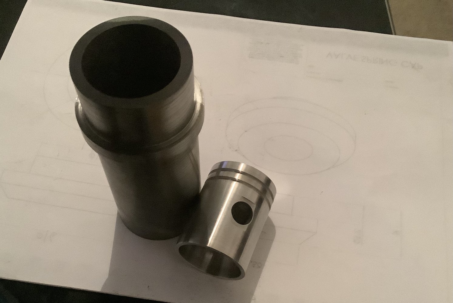

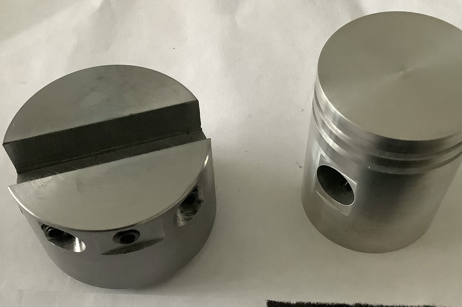

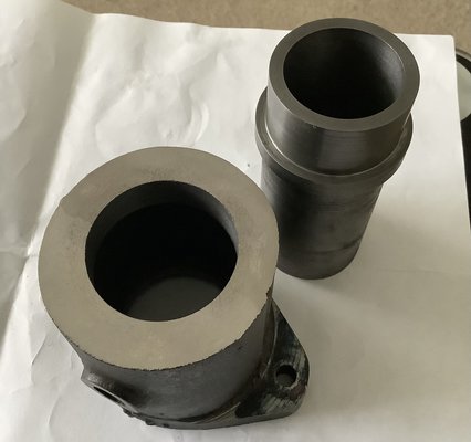

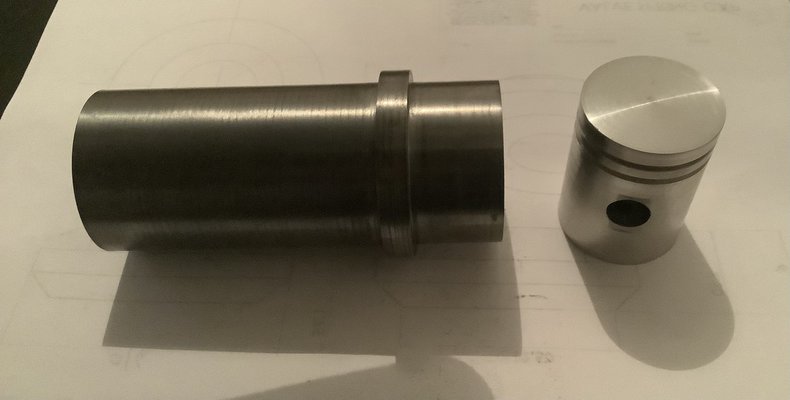

The cylinder, bored to 38mm, actual size is 37.8 allowing for honing and lapping….the outer dia. is 48mm, the larger diameter is 54, locates in the cylinder and is sealed with an O ring for the water jacket. There’s a gasket at the opposite end…meeting the cylinder head …..eventually…

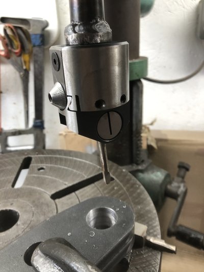

Boring was a challenge, the overall length being 115.45mm….had to make a ‘special boring bar’ from a length of 3/4” bms round….

The other thing that surprises me is the supplied rings, making the piston and bore a closely defined measurement. I would prefer to have simply made the piston and bore to fit and made the rings to suit the finished diameter, whatever it finished at. Presumably you made a boring bar for between-centres boring, to make the cylinder bore?

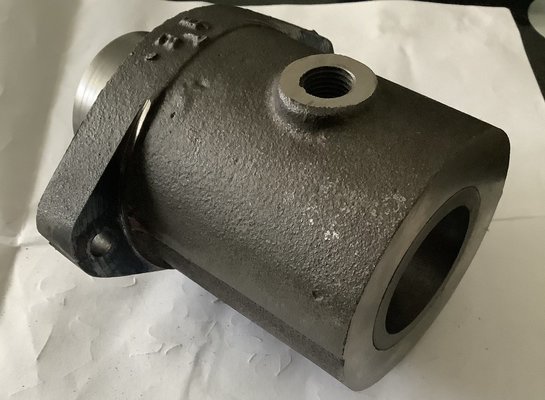

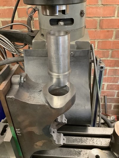

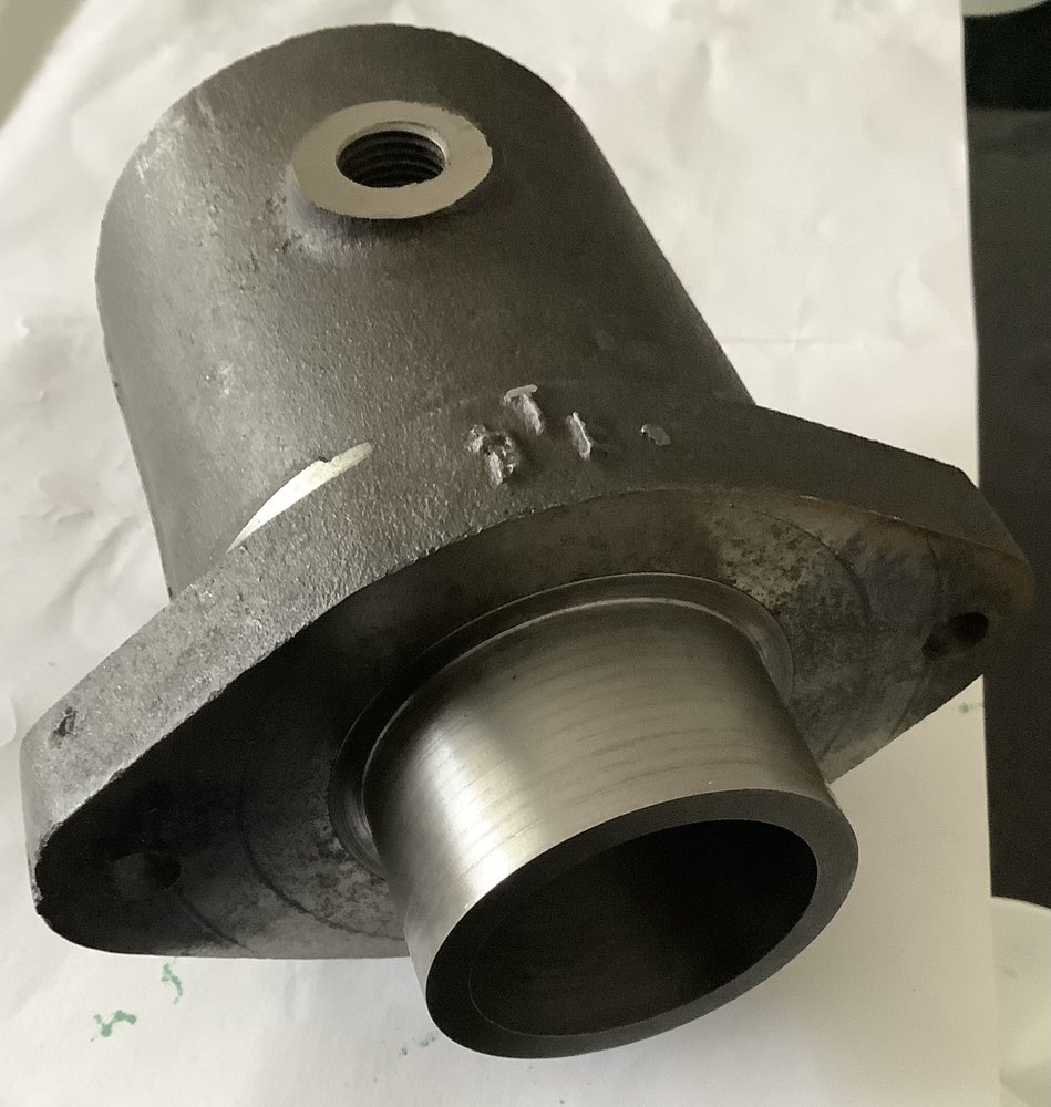

Some work done on the cylinder jacket this time. Quite a challenge as the finished length is 90mm and requires boring through to a finished size of 48mm, which is the o/d of the cylinder liner.
Then the flanged end needs a recess machining to accept the liner shoulder, at 54mm.

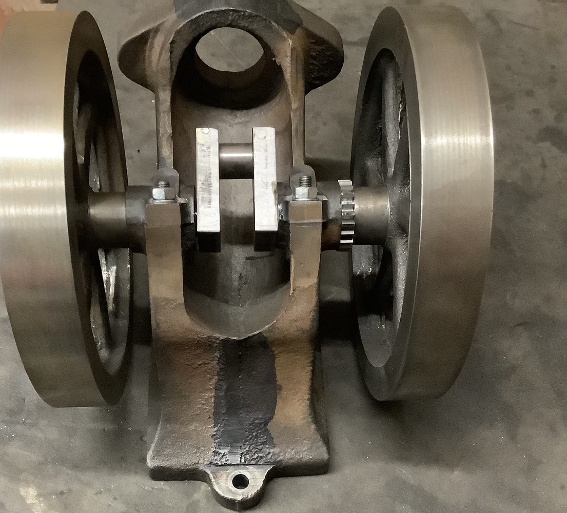

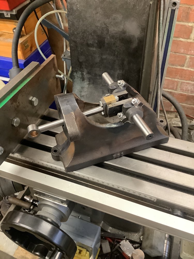

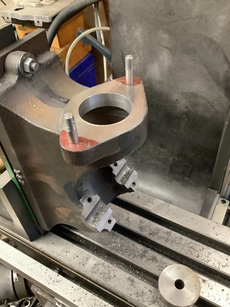

Further progress, I managed to drill and ream the bearing supports and caps, (if you want to call it that…) without any major dramas..

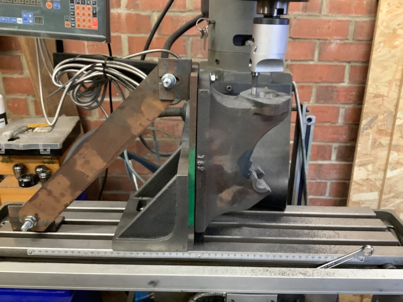

The main thing is to ensure that the bearing support is relatively true to the base, and the supports are true to each other so that the crank is at 90 degrees to the axis of the cylinder and piston…Hence the ‘cobbled together, mounting plate with angle plate on the mill table…

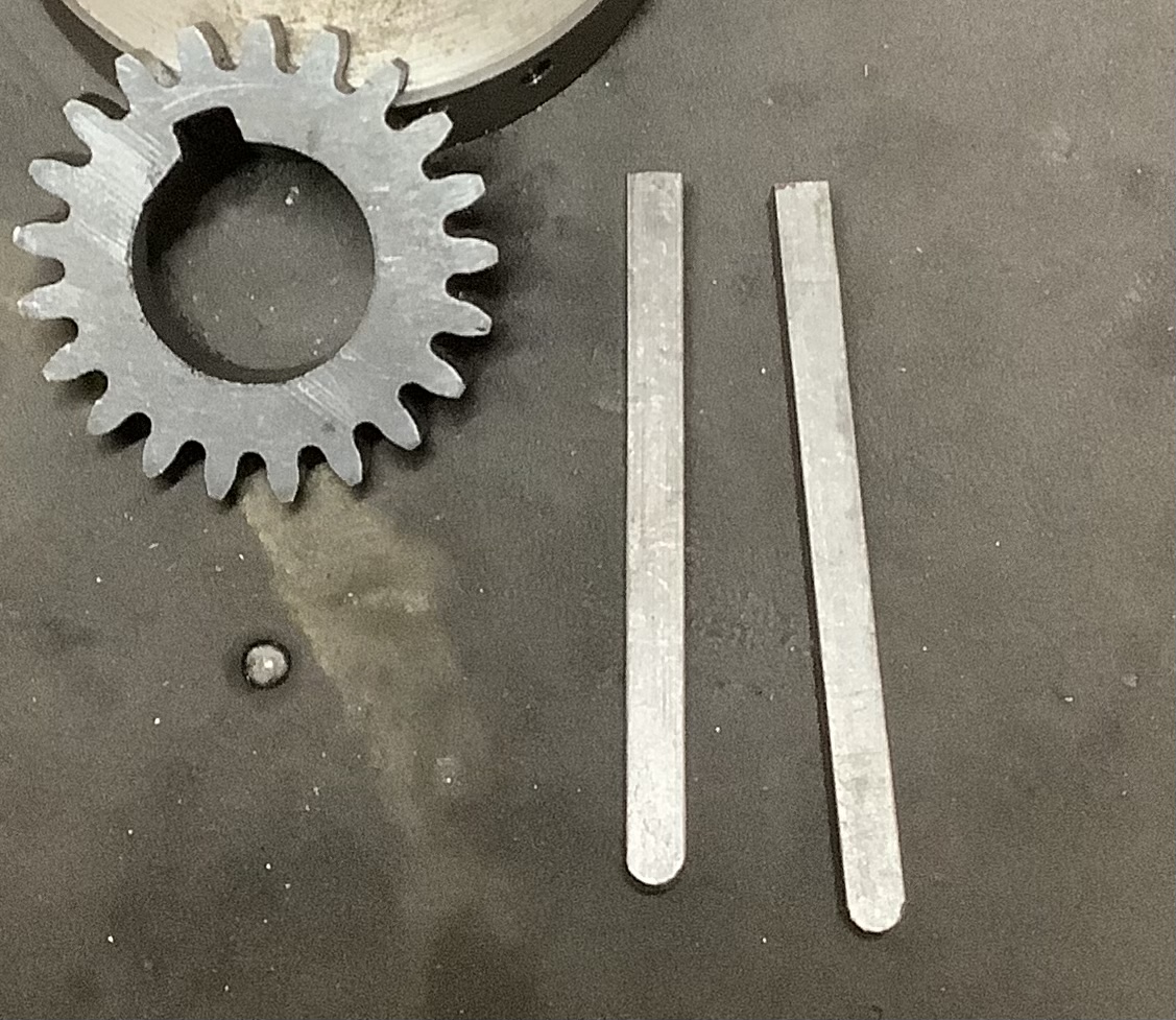

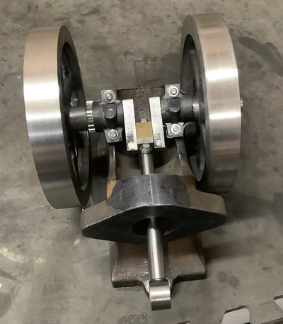

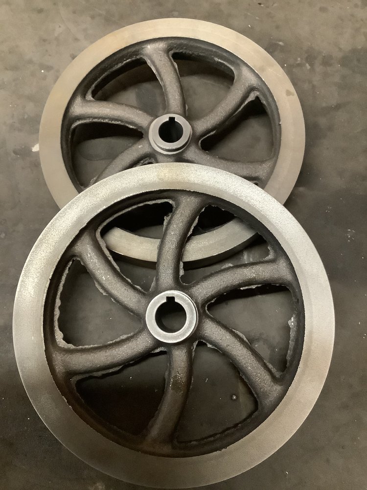

The crank timing gear has its key way broached and keys cut to length (approx..)

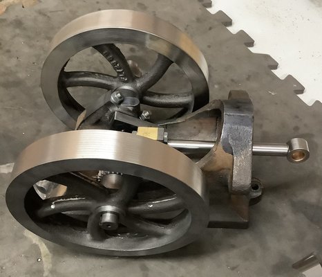

The flywheels now have keyways broached too…
Broaching was done in the lathe, flywheel held in the chuck, then the broaching tool made up from a 1/2” boring tool with some 4mm hss held in as the ‘cutting tool’….I couldn’t justify spend ££££’s on a set of broaches that would be used once in a blue moon….

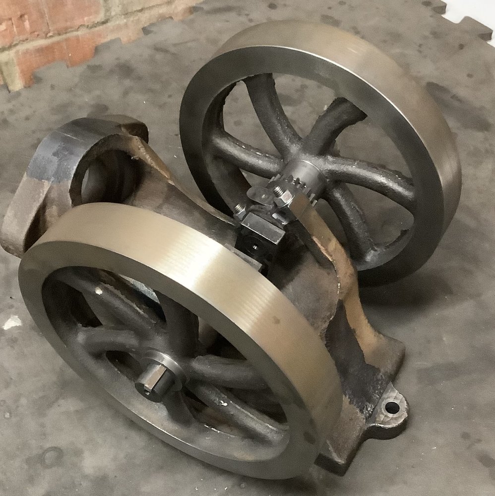

Satisfied? Absolutely, jobs a good ‘un….
All assembled and turns over fine….

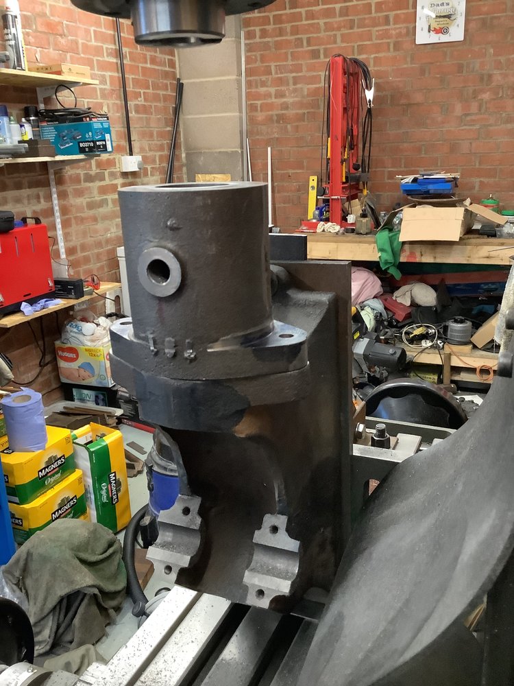

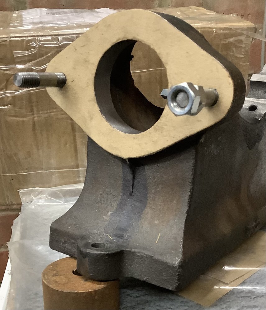

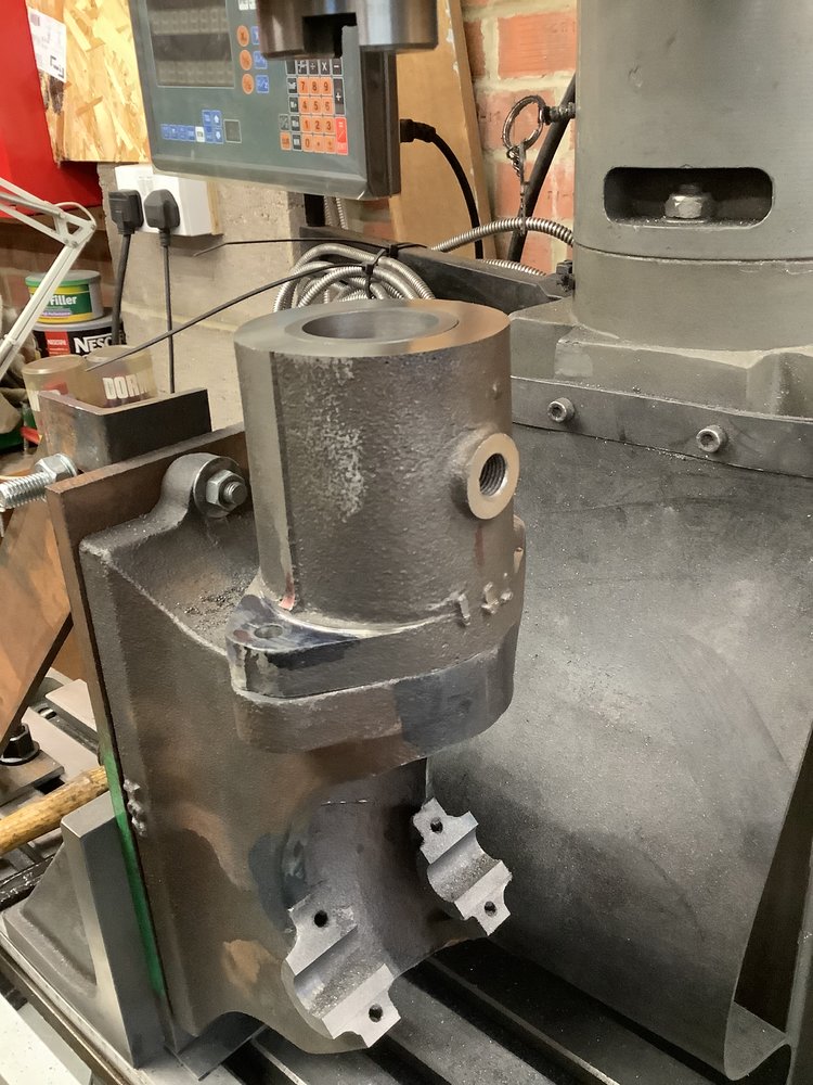

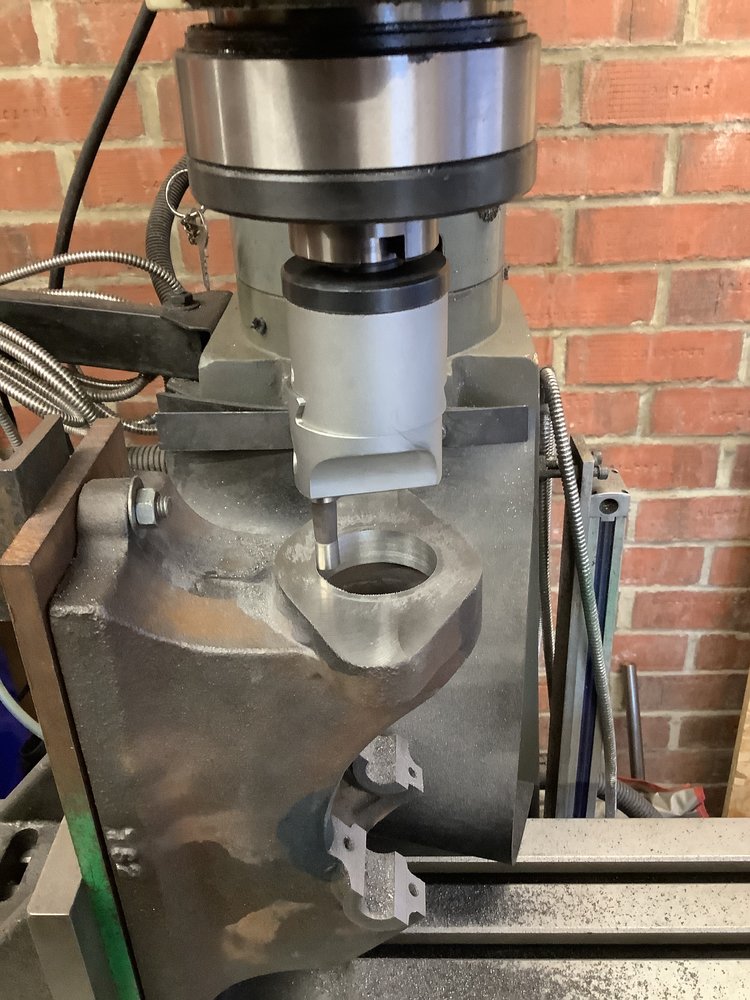

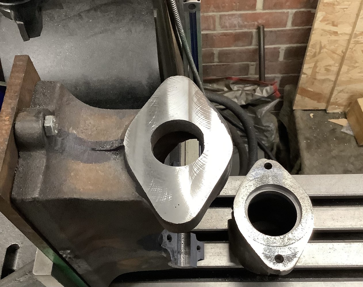

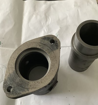

The mating face for the cylinder requires facing as it’s not flat enough for the cylinder to bolt to, although there is a gasket (joint?) in between them.

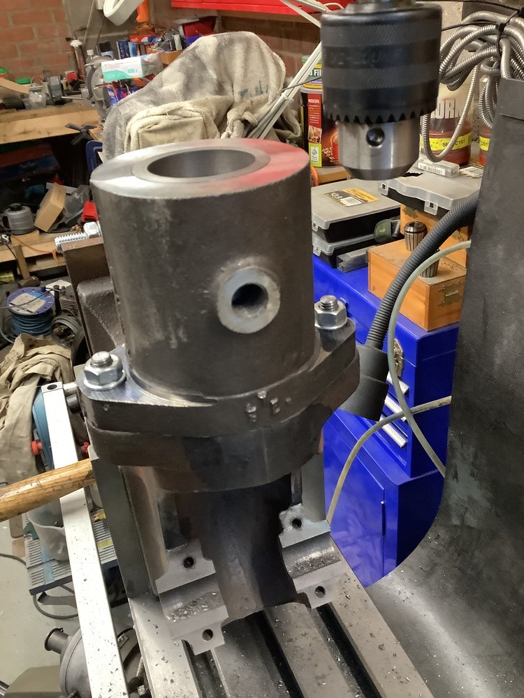

So a few thou machine off with a face mill and its done!

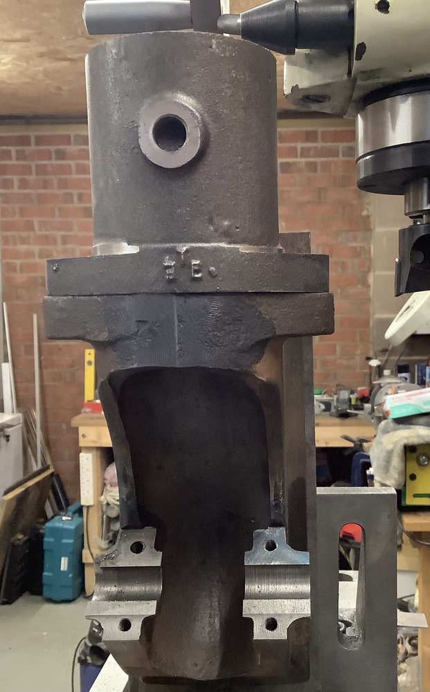

While the casting is setup like this, I‘ll bore the hole to accept the spigot on the cylinder liner, before drilling/tapping the holes for the cylinder bolts.
This ensures the whole assembly looks ‘right’…when bolted up. ( I hope ! )

Some of the parts require a degree of accuracy, such as the cylinder bore, the liner’s outside dimension and it’s internal bore and the piston. Rather than shooting for an exact dimension, although there are tolerances on some measurements, I’ve gone for the ‘fit‘ approach although care has been taken in achieving the desired sizes.

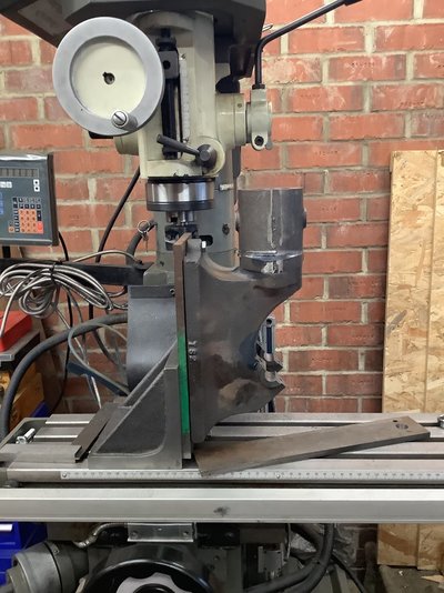

One of the items that does require an accurate size is the main body casting, as many of the items that are attached to it are referenced from the crank housing and the cylinder face.
I guess the setup shown for the main casting above doesn’t reflect the care needed, but let’s not forget, this isnt about building a high speed jet engine more of an agricultural piece of machinery…and built from castings!
We shall see how it turns out on completion, but there’s still a way to go yet…
I started this yesterday, but the assembly wasn’t rigid enough…could have done with a bigger angle plate….but you can only pee with the cock you got…
So some added metalwork….working well….

I did some successful boring in my cheapie home drill press a few days ago, not quite in your league though.

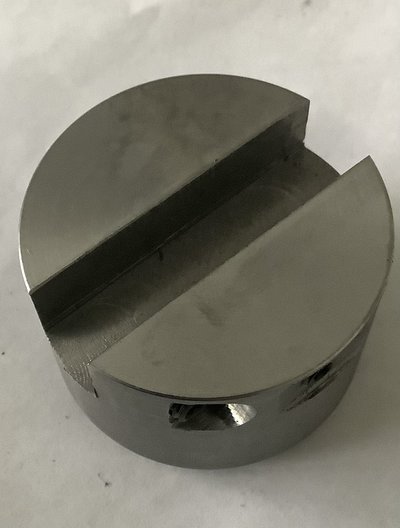

Theres a selection of other loose material to fabricate/machine the piston, conrod

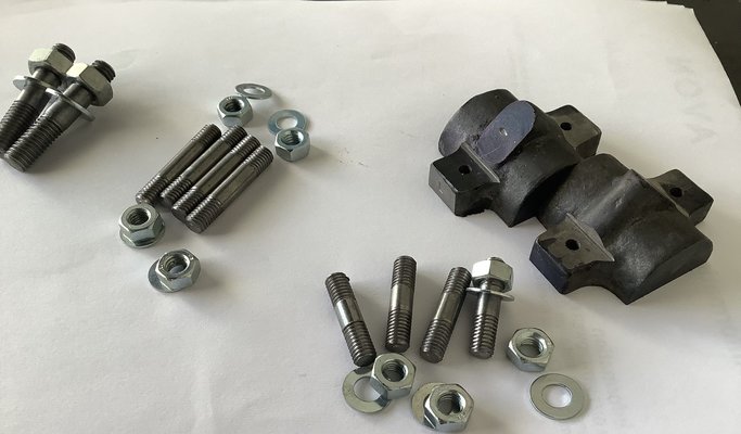

The constructor needs to provide other material not provided to make the valves, gudgeon pin, studs nuts and washers….

Gasket made for the mounting face on the main casting…

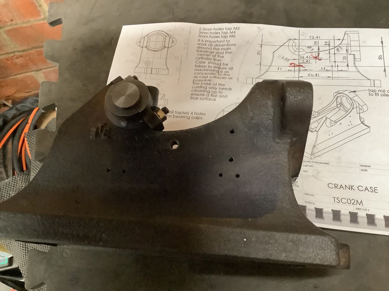

So, to finish off, the main casting required 7 holes to be drilled and tapped before being put to one side.
The eagle eye viewers maybe wondering what the round metal object is in the crank bearing housing…..it’s the datum point for referencing all the holes…
