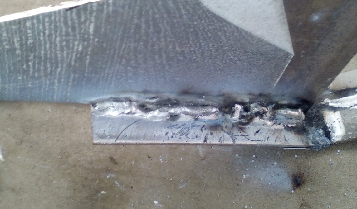

always thought that with synergic programmed inverter machines you switch it on and weld, now I know differently

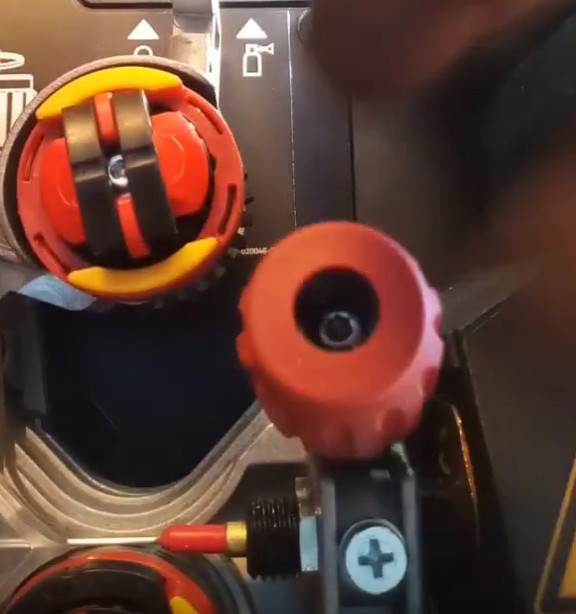

I have played with teflon right up to the contact tip with a push pull gun only to find that the liner melts and jams the wire, when things get hot
THE BRASS TUBE IN THE EUROBLOC and the liner is 1mm, i fail to see that this is the cause, it is now running ok, but not on synergic, pulse twin pulse ok, or as good as i can make it
