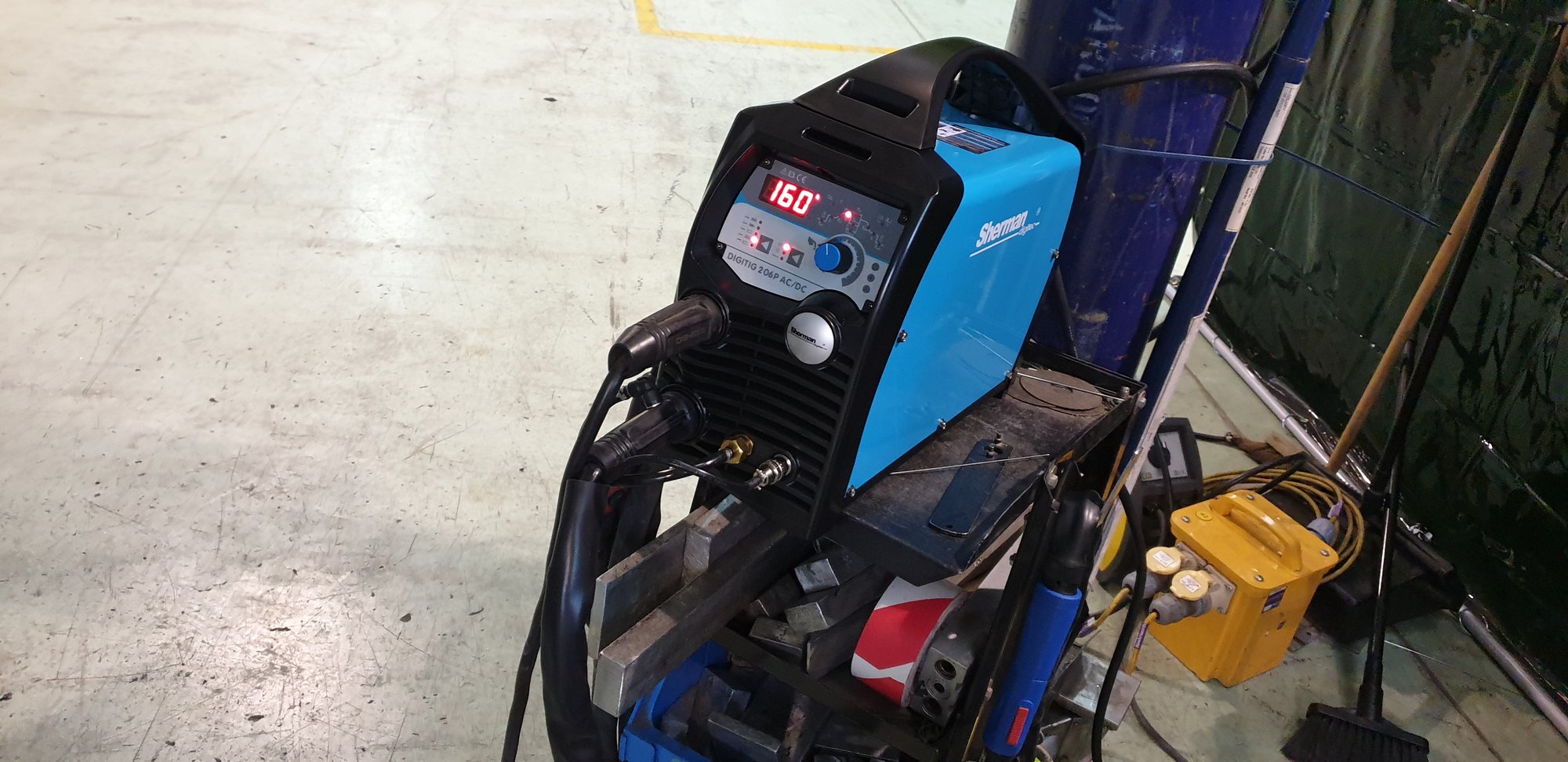

very tempted to get one for site work, save lugging the castotig 2002 out of the workshop
Do it!!!! Do it!!!!
