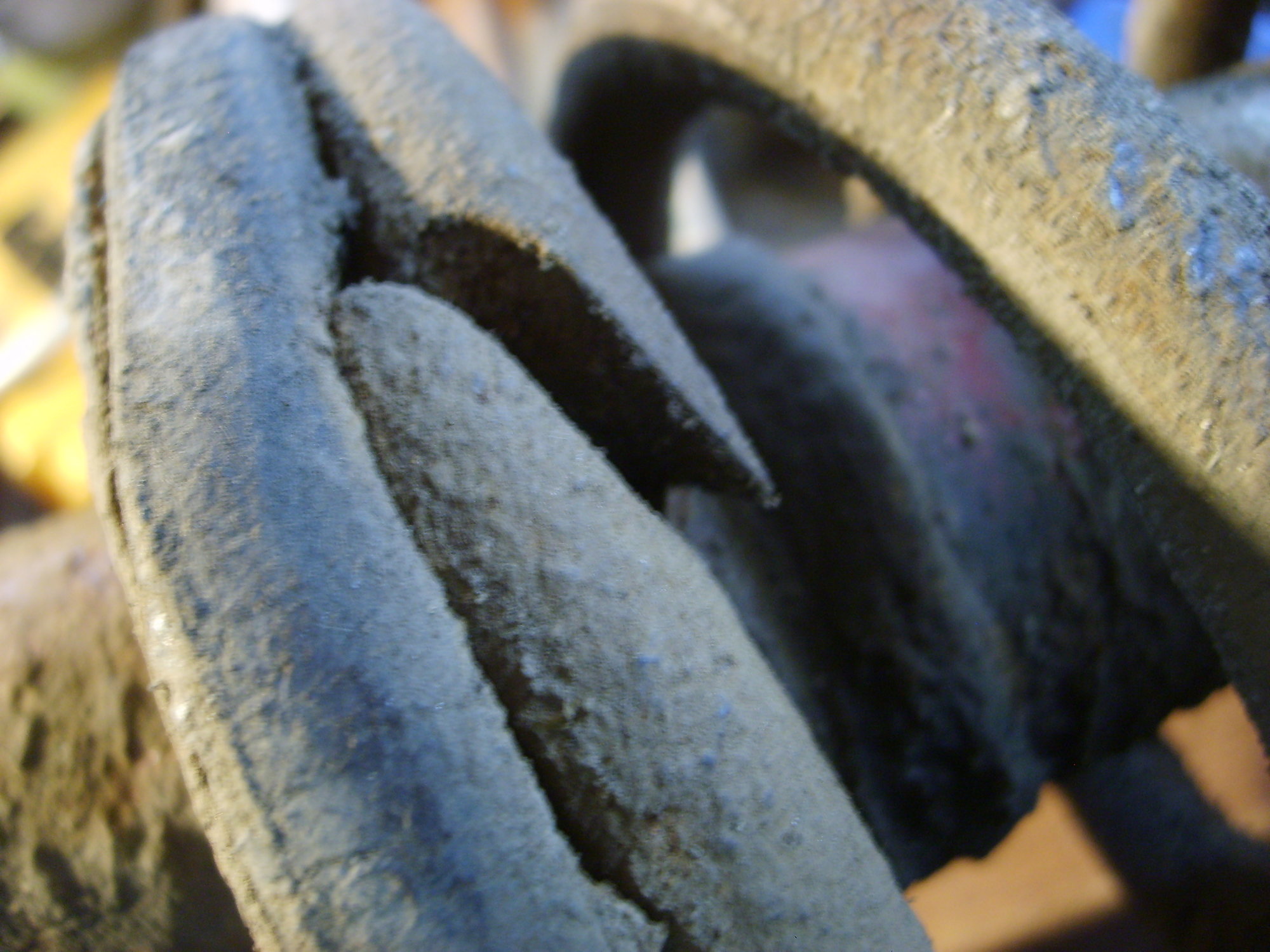

It is possible for springs to become unseated after fitting shocks but this is usually on the fronts on some cars.
So perhaps your wife heard it moving into place and now the noise has gone.
But yes IMHO if you want greater ride height you will need new springs. In my experience uprated ones if your car is loaded more than not.

We’re the original ones self levelling ones? If so the springs maybe different. They were on the 240 & 740’s they were shorter & pumped up with the self levelling. If you put the shocks off a non self levelling one on, the car sat too low.

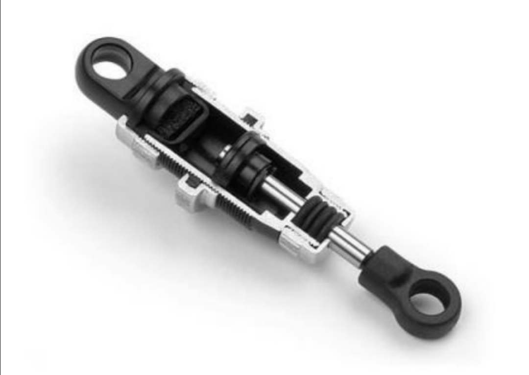

I am not an expert (but my lad raced RC cars and not only do you change springs for different tracks but also the viscosity of the oil in the shocks AND the holes in the pistons inside.Thanks, I'm not bothered about ride height.
