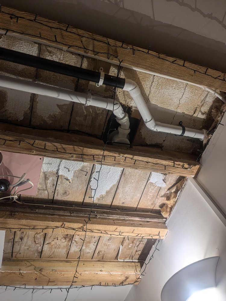

Nooooo don't worry guys I've seen enough hidden bodges from the last owner /"renovated" . Originally the tray was very slow to drain and you showered in a puddle , ripped the ceiling to expose the waste pipes and they fell the wrong way and were held up with cable ties and other bodges FFS
As you can see from.the picture the underside is just old floor boards so I'll prob rip them out and make a level section with 19 mm plywood View attachment 481132
thanks but it does answer why you have flex in your floor thats why i askedGaz there 6 " deep X3 " built into the walls either end 3.5 m span . I'm not about to alter them tho !
