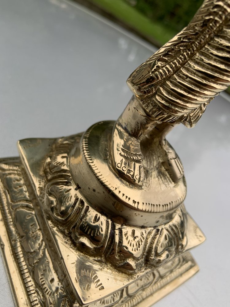

good luck on that one whats wrong with silver solderI’m gonna braze it properly with brass rod and gas.
The part has been repaired before and isn’t a tight enough fit for silver solderinggood luck on that one whats wrong with silver solder
No the zinc bubbles out too readily.tig braze?
Silverflo rods will be fine for that gap.The part has been repaired before and isn’t a tight enough fit for silver soldering
Either wrong flux or too much localised heat? For the low temp silverflow you need 650c and easyflow flux, its active 550-750c (dull red). Above that itll turn black and wont stick. Silverflow will stick well before the part is red hot.It’s a no to gas brazing it. No matter how hot I get it or how much I wire brush it and douse it in flux, the braze just rolls up into a ball and sits there or rolls off the part.
So we are onto silver soldering with HT flux or glueing.
hopefully it will be clean metal or it wont take it looked a bit rough when you saw the break as though it wasnt quality metalIt’s a no to gas brazing it. No matter how hot I get it or how much I wire brush it and douse it in flux, the braze just rolls up into a ball and sits there or rolls off the part.
They appear to be around 900c melting point, not the 650c of the high silver brazes?I’ve tried SIF rods and SIF flux, castolin 16 and castolin 18

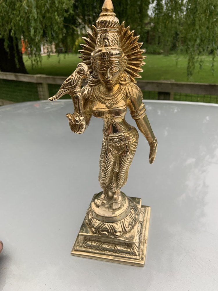

Finito. Not happy with it really. But it’s the best I can make of it.
View attachment 297201 View attachment 297202
he nailed ithe pinned it!
