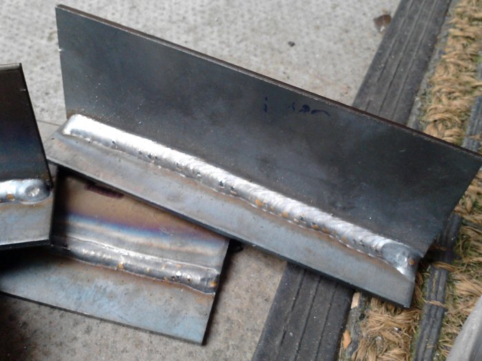

yeah i see your point in those pics, we arent too bothered by neatness just yet as we just want to do odd jobs with.

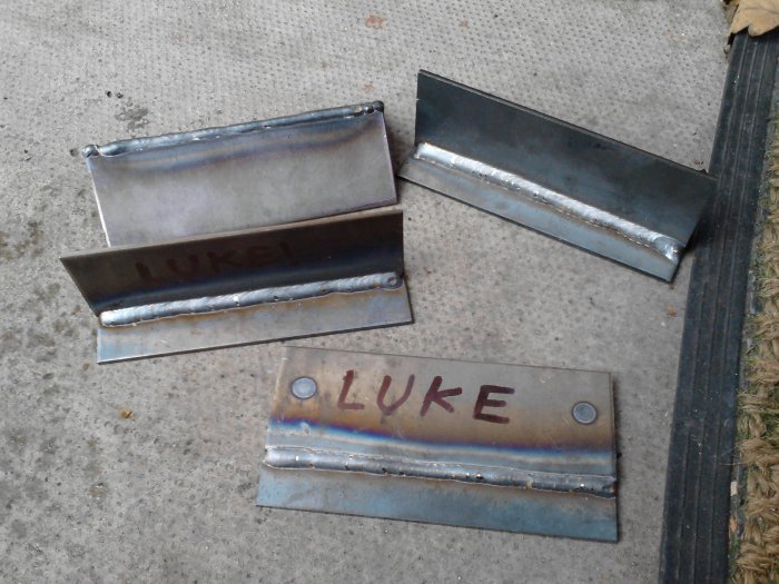

Will be waiting for some photographs of your welds, doesn't matter how bad they look at first, its all about learning!No problem!Will be waiting for some photographs of your welds, doesn't matter how bad they look at first, its all about learning!

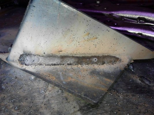

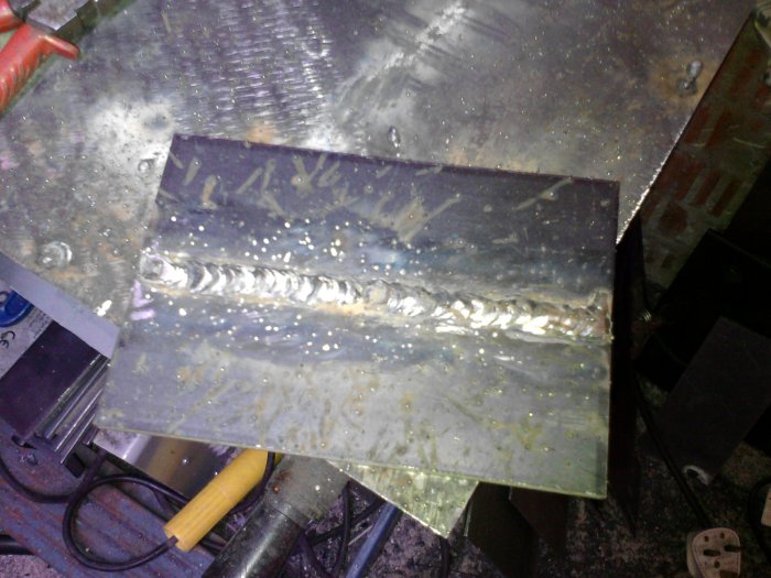

will get some pics aswell, yesterday we struggled to get a solid weld, it just made the metal bubble up but not actually weld the 2 sheets toghether![]()
Hopefully that won't happen once you get hold of some new rods.
when you say sheets, how thick are they?
erm, not sure sorry around 3mm-ish
