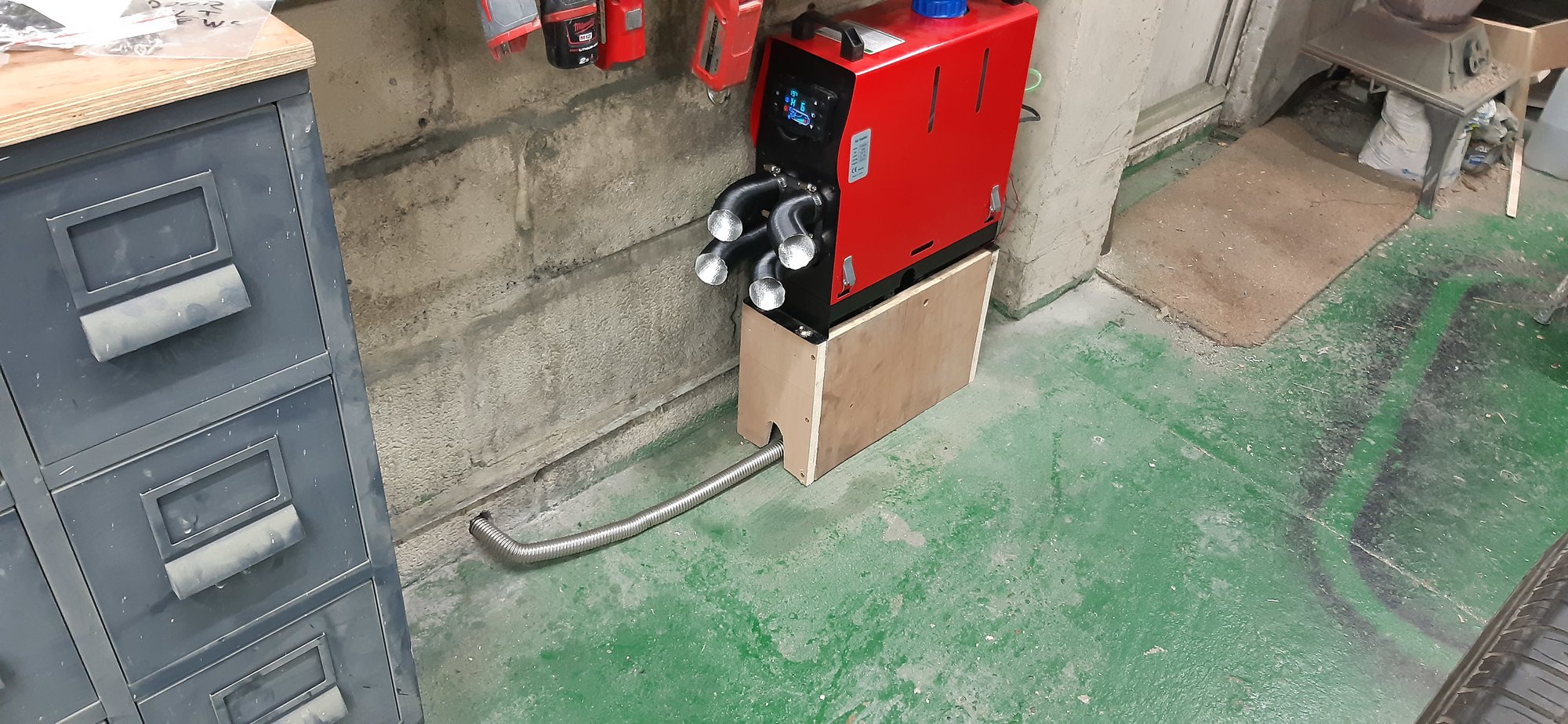

Yeah - that's a recent "mod" as well! Previously, the press sat outside the shelf, face-on, but then I decided that was where the heater was going so it needed to get under the shelf. One multipurpose tool and a bit of bracing later...First pic. Ain't it a bugger when something's just a gnat's too tall to slide under your bench.
Hmmm... you think?maybe set the fuel a wee bit further from the heater and run a copper pipe , with an off tap on it jic.
No reason at all ,, they are that far in a lorry , and the ones in my boat were twenty five feet fron the tanks ,,, be an awful shame if all the heat from the heater was in the first three mins and the next two hours was from the workshop burning down ,,, Id also add a fire extinguisher by the door again jic , way easier looking at it than looking for it.Hmmm... you think?
Suppose it would be a bit ironic (and fiery) if the heater melted the tank...
Good thought re copper pipe - I've certainly got plenty of it. Presumably there's no reason that the tank couldn't be 6-8 feet away?
Sold. I'll move it - cheers.No reason at all ,, they are that far in a lorry , and the ones in my boat were twenty five feet fron the tanks ,,, be an awful shame if all the heat from the heater was in the first three mins and the next two hours was from the workshop burning down ,,, Id also add a fire extinguisher by the door again jic , way easier looking at it than looking for it.
drill it in a clover leaf chip out the other bits and sleeve the hole , then put the exhaust through with some asbestos type packing to stop draughts ,,, probably not actually needed but its good practice.Question for the experienced masses...
The exhaust is 25mm diameter and it's going to go through 250mm thick breeze block. I have a 25mm SDS bit so was going to wrap the exhaust with exhaust heatwrap up to the brick, but now I'm starting to wonder whether the brick will be ok with the ~300-400F exhaust going through it.
The alternative is to splurge £36 on a 30mm bit that I'll never use again and poke it through the brick with heatwrap all the way.
Any thoughts on whether the breeze block will cope with that kind of heat?
Yep - had already planned to drill it down (inside to outside) to keep the rain at bay, but that point about unburned fuel ((shudder)) is also a good oneI also tend to drill holes like that at a downwards angle too , if you can . Then if anything does go wrong unburned fuel runs out side and not inside , again probably not needed , but its as easy to drill at an angle as not. and it stops water running in from outside on wet days too.
Had mine through the wall with a 25mm hole for 3 years with no problem at all.Question for the experienced masses...

Personally I'd insulate it to prevent condensate build-up due to rapid cooling, also have a bit of a drop on it to the outside for the same reason. Eventually the condensate will corrode the exhaust tube, letting combustion gases out in the wall or before it, a CO detector will help but you'll be getting unexplained headaches well before the detector is activated.Question for the experienced masses...
