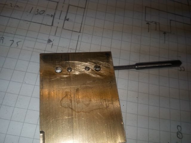

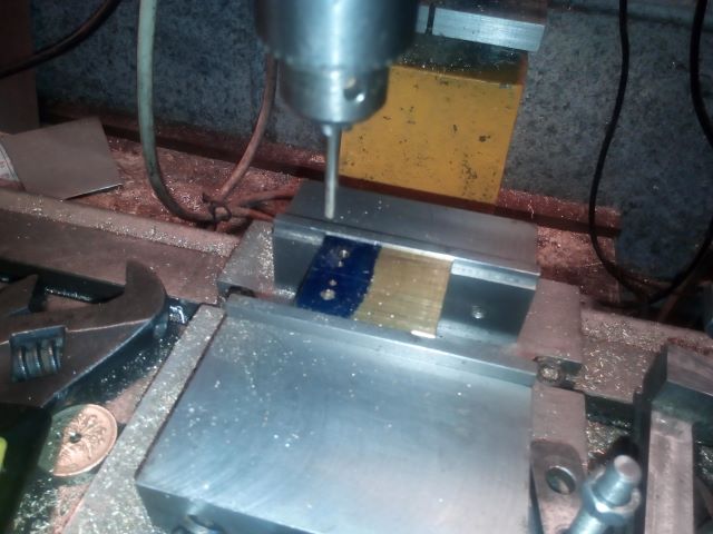

the flywheels were made from an offcut of 1/8" thick brass plate, the holes for mounting the crankpins and axle were reamed using precision ground stainless steel rod with three flats filed on them, to get the best fit possible.
and a m2 hole was drilled and tapped for a allen screw in one of the flywheels so that it can be mounted to the axle, the other flywheel would be loctited to the axle. this 2mm grub screw was the only part of this engine not made by me.

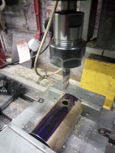

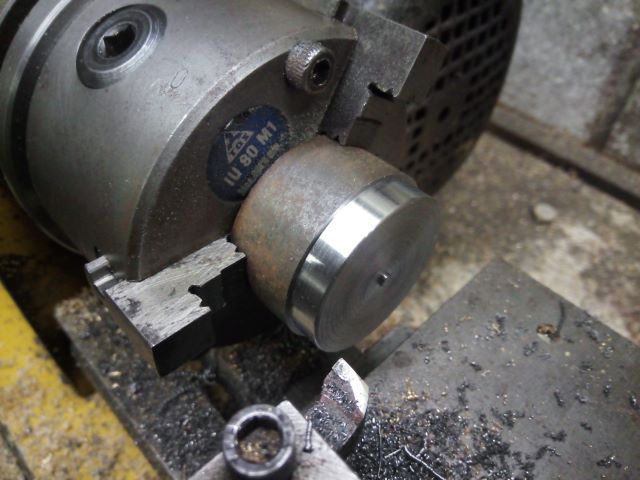

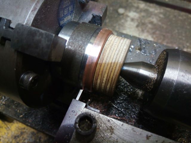

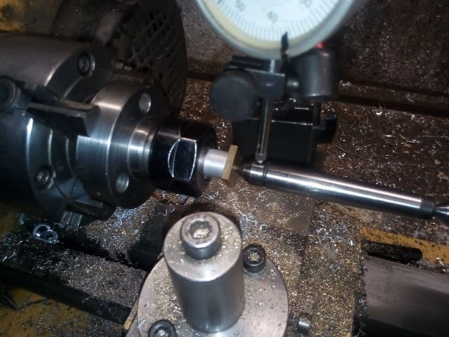

the flywheels were then clocked up on the centre bore and the outside was machined. The flywheel blank was superglued some aluminium so that I could machine it.

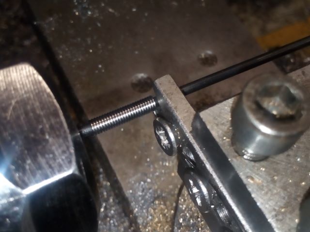

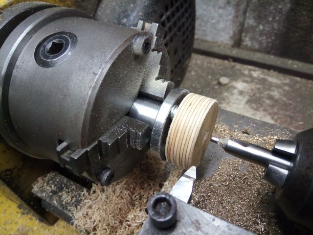

I also needed a couple of tensions springs and a compression spring, so here's me making them using a transfer punch as a mandrel and they are hardened, so that would minimise the flexing as the spring coils get further from the chuck. small compression and tension springs are easy to make and only take a few minutes. heres my way of doing it.

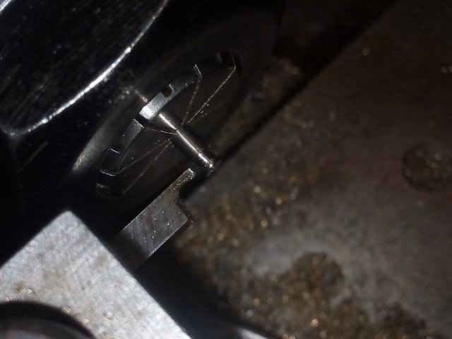

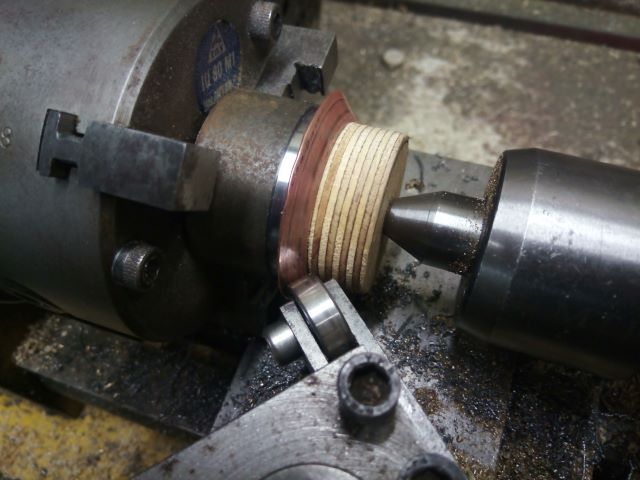

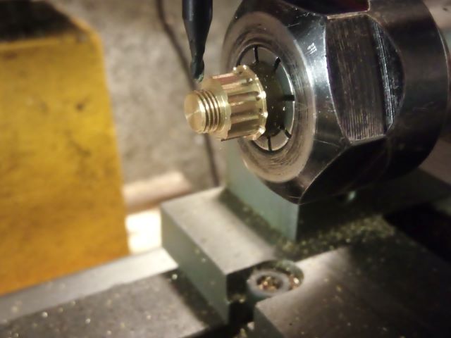

as this engine was being assembled using loctite, I needed to make some grooves on the shafts for it. this is making the groove on a 2.00mm diameter shaft using a 0.6mm wide parting tool.

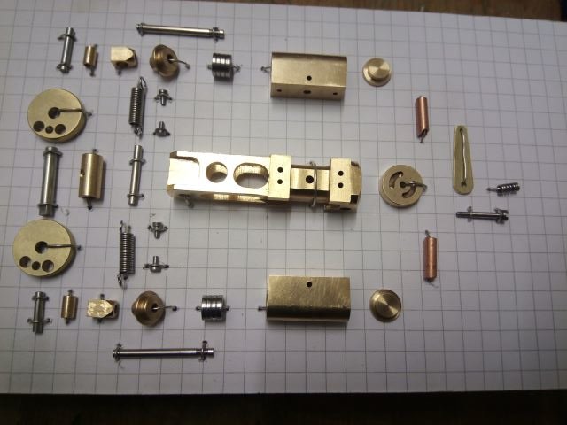

then a couple of weeks ago I went to a steam punk event at Leeds Industrial Museum with a stand for a model engineering club. so I though it would be good to take it in pieces in a small container so people could see the parts, and later that day I was given an airbrush and the display box for perfect for doing this. The 5mm squared paper just made it easier for me to position the parts.

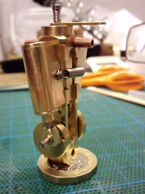

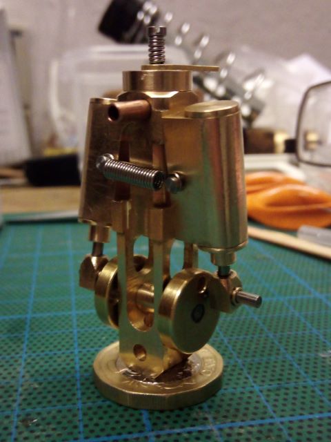

the engine was then assembled, using Loctite 648, to hold it together, and ended up using it like superglue, using a wooden cocktail stick to apply it to the grooves, then assembling it. After a couple of minutes the excess Loctite was then wiped off, which gave a very clean finish, and the final engine looks like this (on a pound coin for scale).
and compared to the original engine that its a smaller version of

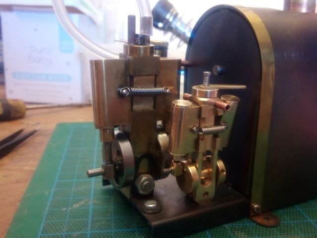

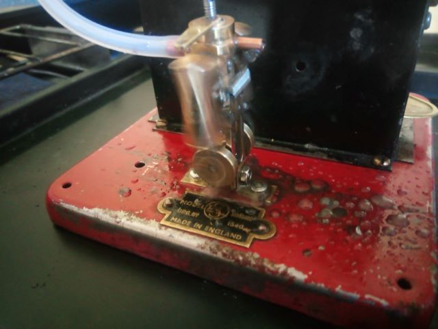

it runs very nicely on compressed air, just need to get on with trying it out on steam and making a new boiler for it. The drive for a propeller shaft is taken from the extended crank pin. on the propeller shaft there will be a disk the the same size as the flywheels but has a slot in it to take up the drive. this also makes it very easy to remove the steam plant from the boat if required.

Making Small Compression Springs
today I had a go at making some small compression springs as I wasn't prepared to pay the minimum order quantities for half a dozen so thought I'd have a go at making my own. I need stainless steel springs so got some hard drawn stainless steel. this is available from the far east via ebay etc...
