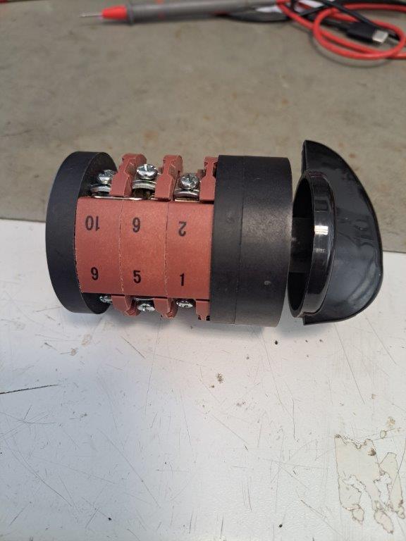

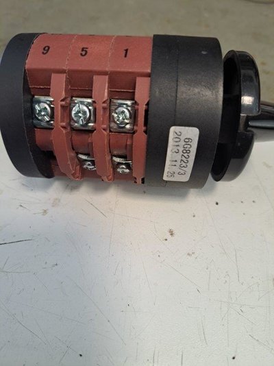

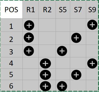

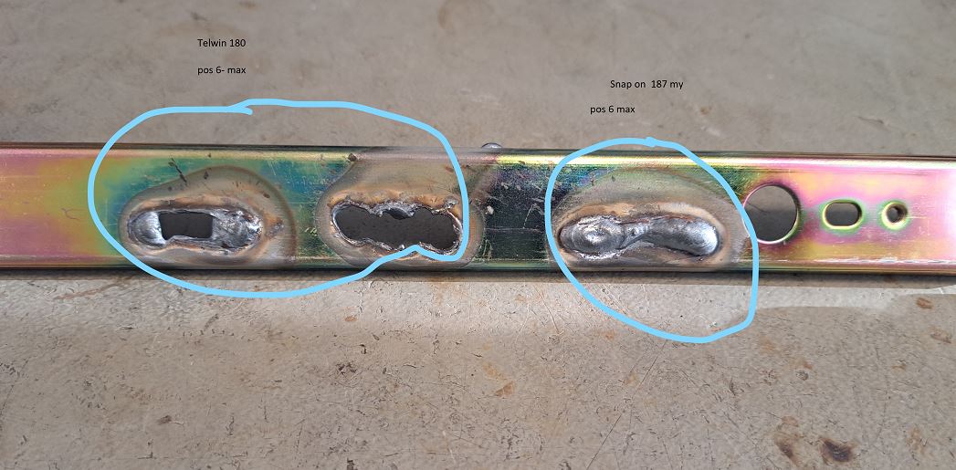

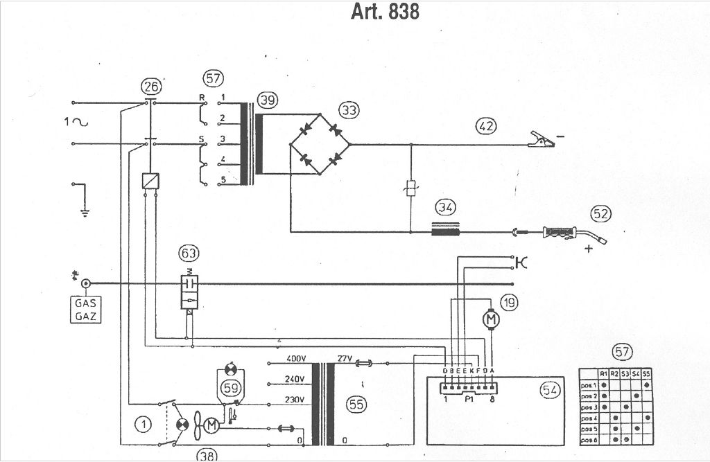

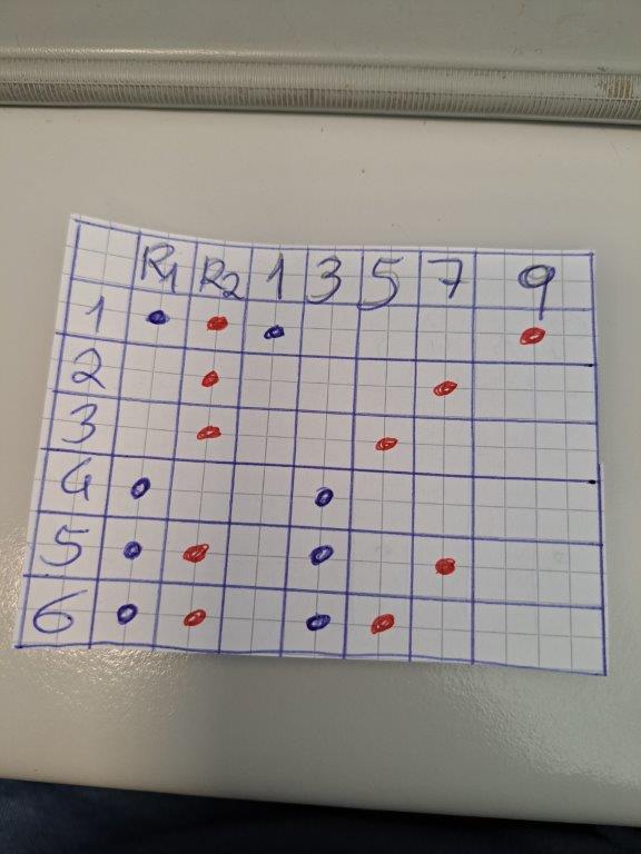

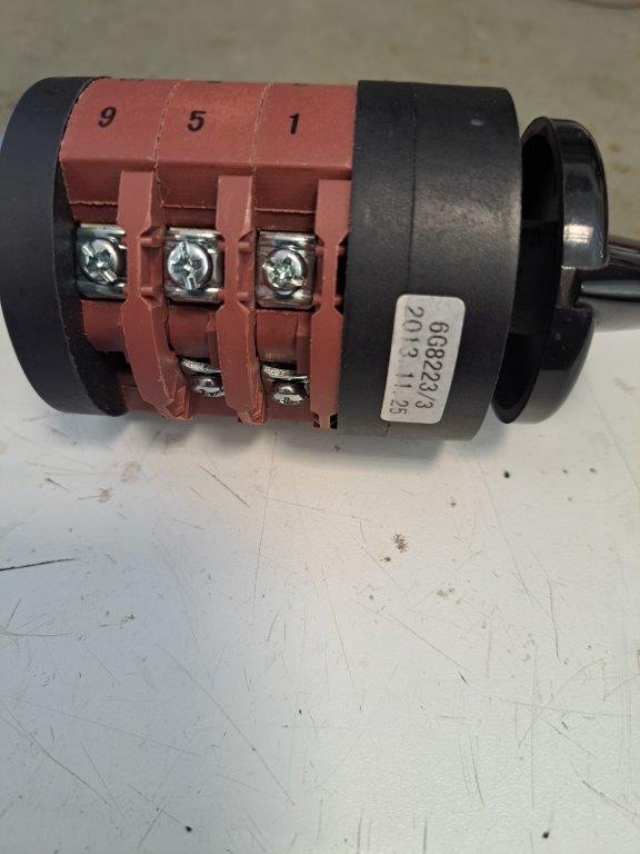

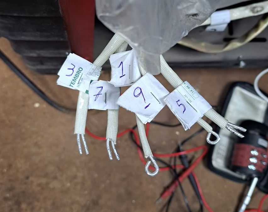

Did you try the 3 x car headlamp bulb load test?
I'm beginning to suspect that the transformer primary isn't getting full power in. You'd need to trace where the AC mains goes into the primary when the mains is on, the trigger is pressed, and the power selector switch is at the highest setting. Then disconnect those wires and rig up a direct 13-amp fused new mains lead direct in to the transformer at those points.
