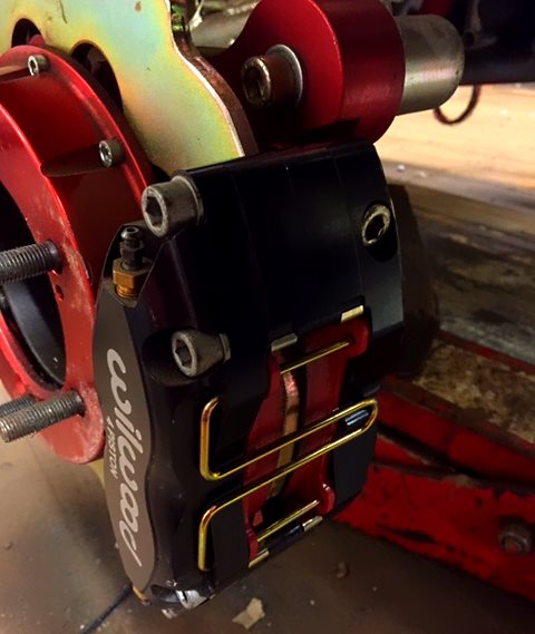

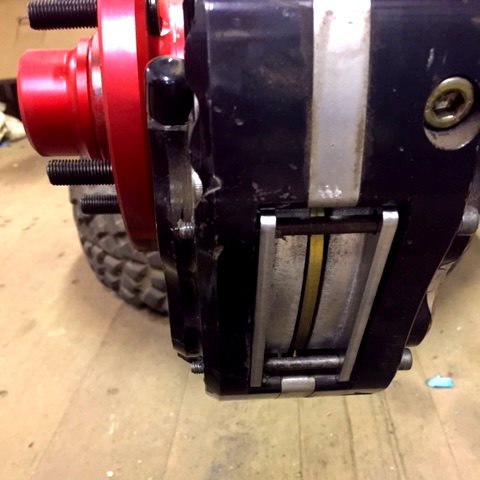

Oh, and we re-made the front mudguard mounts too, the surplus steel tube is gone, it's now on ally mounts inside the guard instead of those big external mounts - also realigned them as the new suspension and wider track meant they weren't quite right at full bump any more:
You can see the other side being mocked up there before the angle grinder chops the steel bit off.
This was before we made the new side panels, obviously....
