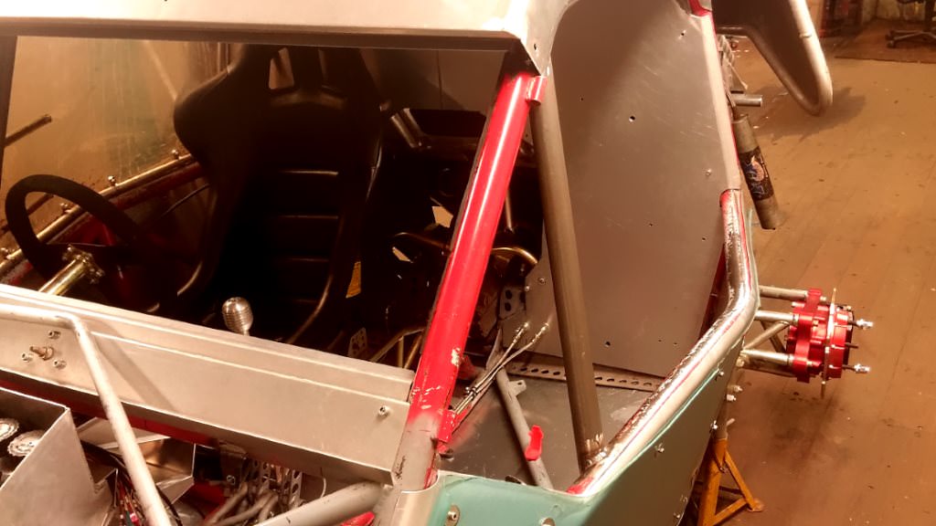

Everything is going back on/in - cabin is looking a bit busy!
If they are ally, how thick are your floors? I always try to advise people to have thick ally or steel floors. Reason being, we were doing the Welsh Hill rally about 20 years ago and I was navigator in my mates LR Bowler when a 2" thick branch unseen in the mud, came through the floor and up between my legs just in front of the seat!!
He had used 3mm ally but we changed them to 6mm dural! I think I remember someone being seriously injured by this happening to them?
I was doing chase for Phil Collins on RAC one year and he slammed sideways into a log pile in the manta and a rogue small branch was stuck out and that went through the fibre glass door and into the car to the prop tunnel just behind my mates the NAV seat at pelvis height the seat wouldnt have stopped that either, sometimes luck is with you BUT it wasnt a few years later (2003) when he slammed a red wood tree and him and the driver where killed instantly on the Oregon trail rally.
Floor is 3mm 5251, but it's got sections where it's thickened up to half an inch in some places under the front and read edges and centreline. There's also a pair of front bulkheads at 2mm each.
Under the seats has an inch crossbar in T45 specifically to stop anything coming up through the floor - we've had a few rocks punch through before - I'll get a photo of the cracks in the old one if I remember - you'd have to make the whole floor far too thick to mitigate the risk completely.
Simmonites father was killed by a pole coming through the bottom of the car, that was actually up here, just a little further down that lane in the testing videos.
And yes, I know, the old seats and mounts look rather tired at the side of the new bits.
Don't worry, shiny black and red ones are en route....we needed dated seats to run internationally and those vinyl ones are now 20 and 30+ years old...

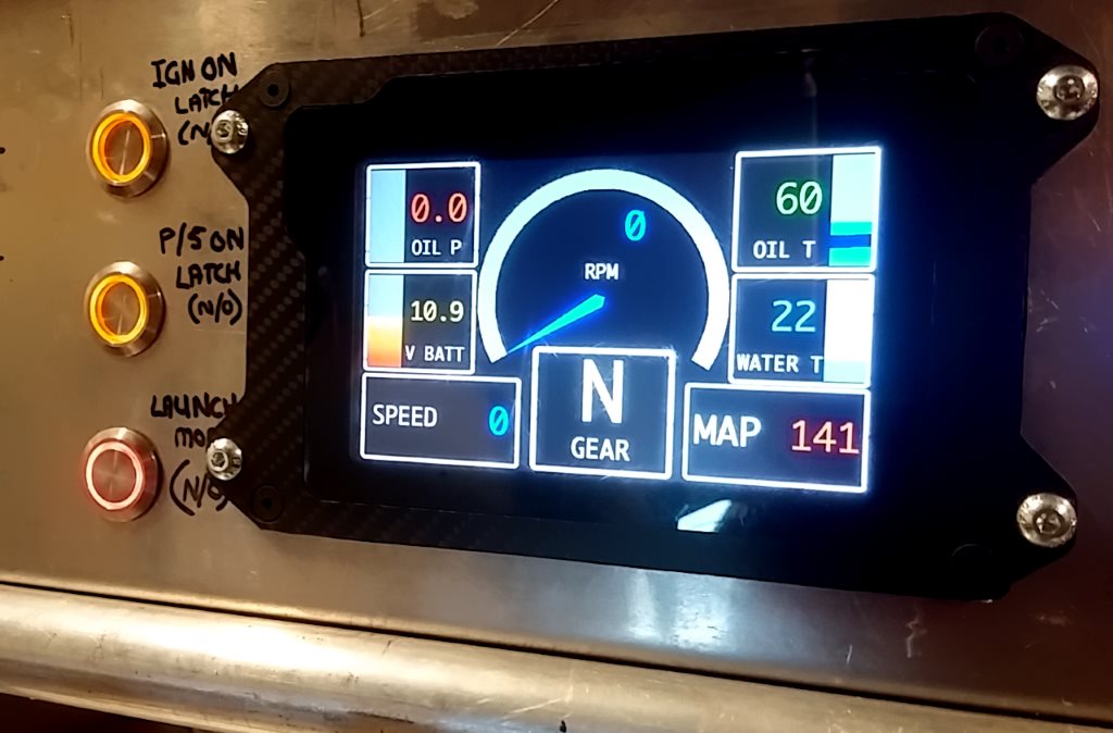

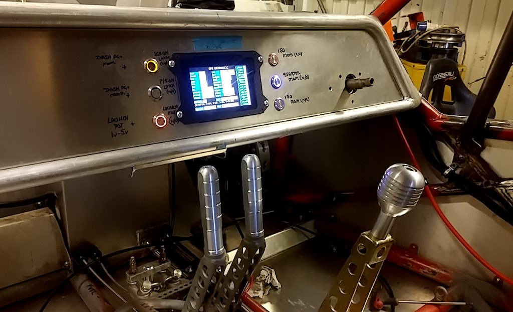

Off the shelf, it was one of the early prototypes for DTA's new dash, so we got a good deal.
I have been considering making a DIY one with a tablet for touchscreen and then an arduinio I/O shield to control all the switches and relays though....I'll have to leave that for version 4...
