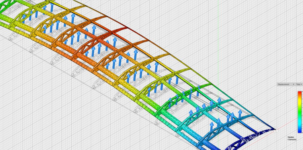

And probably as far as the endplates will get refined - at this point they're still easy to make, rapidly into diminishing returns in the case of time vs benefit otherwise:
