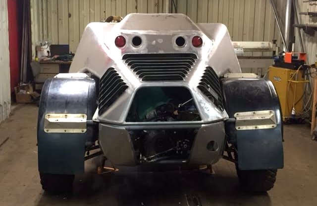

Been playing in Paint, interested to hear any thoughts or suggestions - was just trying to see what it looks like with a bit of colour on, and trying to break up the bulk of the bonnet/scoop from being one slab of colour:

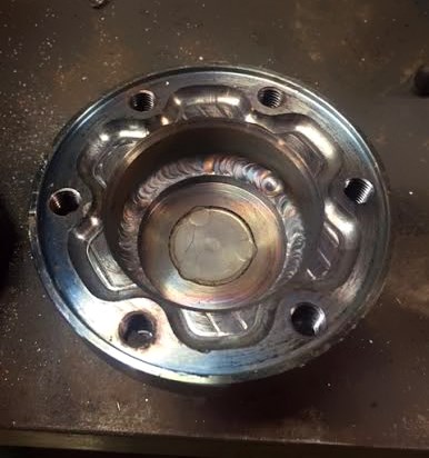

New CV cups made up - the old ones were getting tired where they push on the output splines - big CV joint angles and a lot of driveshaft plunge take their toll there, and the OE fit on the splines is fairly loose to start with, then gearbox seals start weeping. Anyway, after a few years of abuse some new ones were due since everything else is new, these adapt from the Renault internal spline out to the right bolt pattern for the Porsche 930 CV joints we use, along with enough clearance to let the driveshafts plunge through the CV and into the flange.
Will be sending them off for plating this time as well, to tighten up the clearance where they slide on the splines and hopefully reduce some of the movement/wear there.
Bad news, they're the undercut 'race' ones with undersized CV balls that we don't want, as they're crap for wear and distort where the bolt heads are undercut. Ordered genuine GKN outers, got chinese ****e.....hmm.
