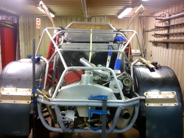

Ed's been busy again, yep, he's started chopping the front out now the rear's going back together. May as well have built a new car....
New front cross going in that mates to the beam stiffening bars we added a few years back, and is higher to clear the new pedals and fuel tank/battery/PAS which have been shifted backwards for better weight distribution:
(Yeah, in situ welding pic, we're back to forum relevance again, whoo!)
