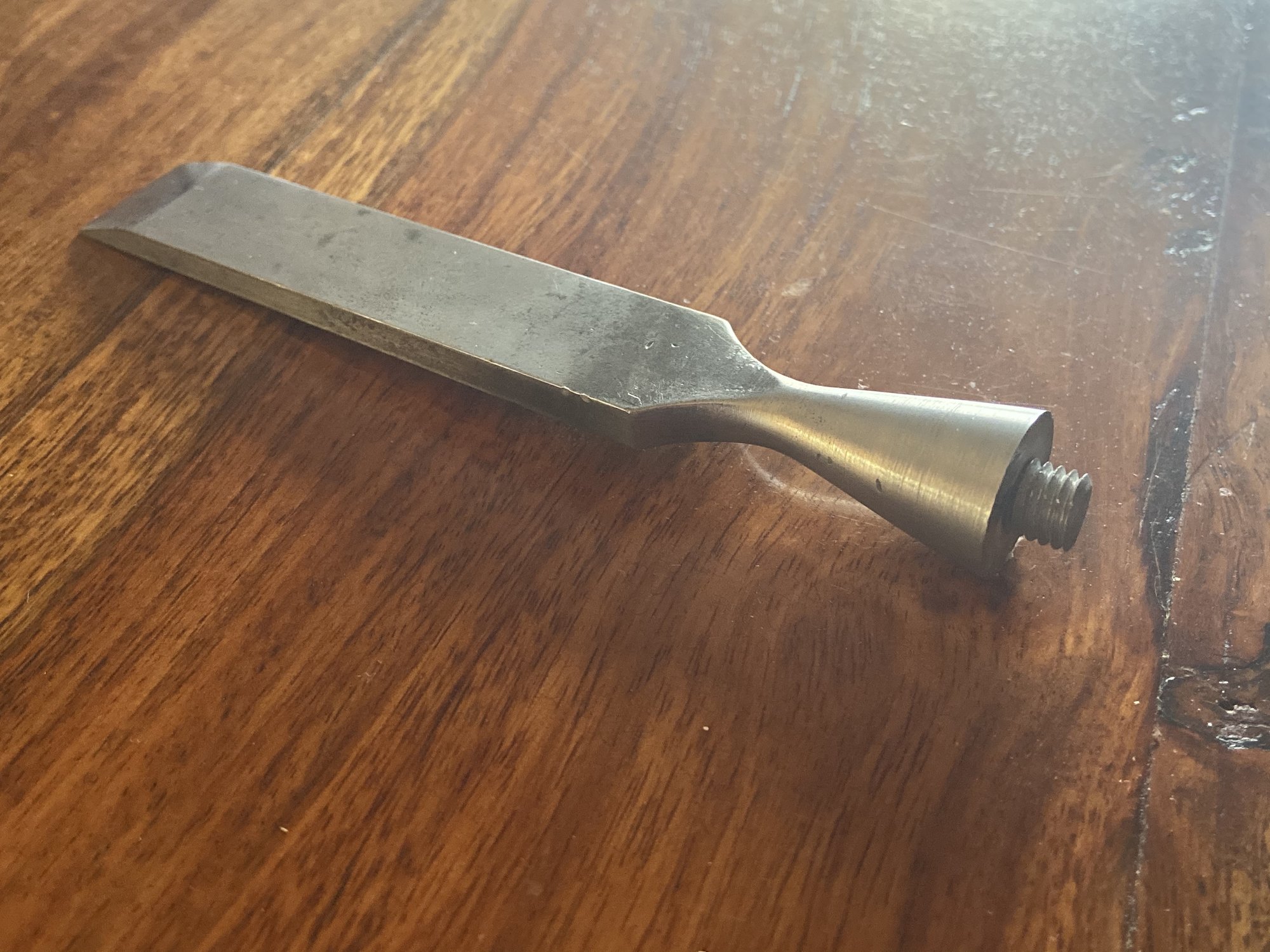

Broken marples chisel. I broke the tang even more trying to fix it.
So set it up in the machine vice and milled the face flat, while in there drilled and tapped M8

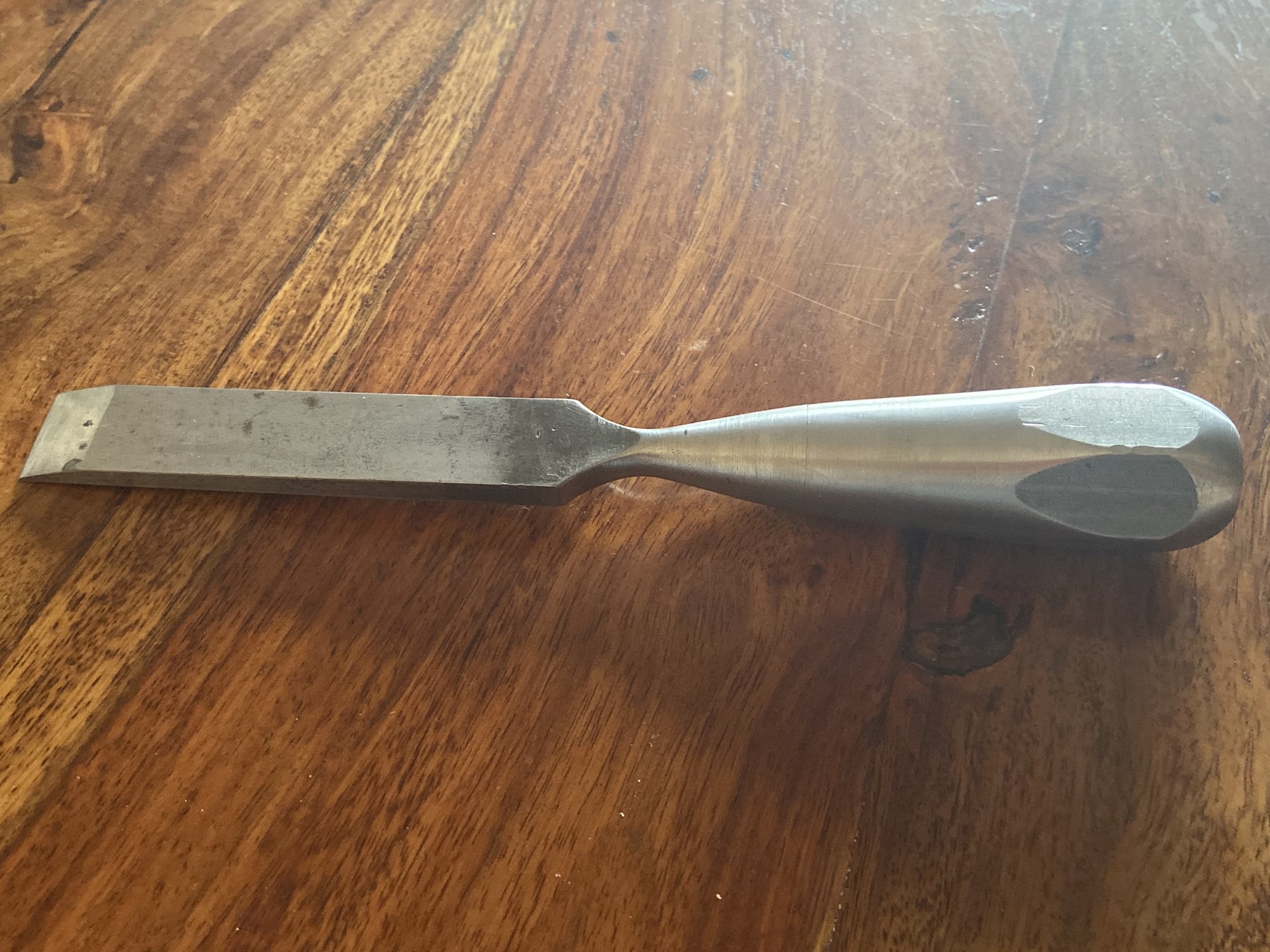

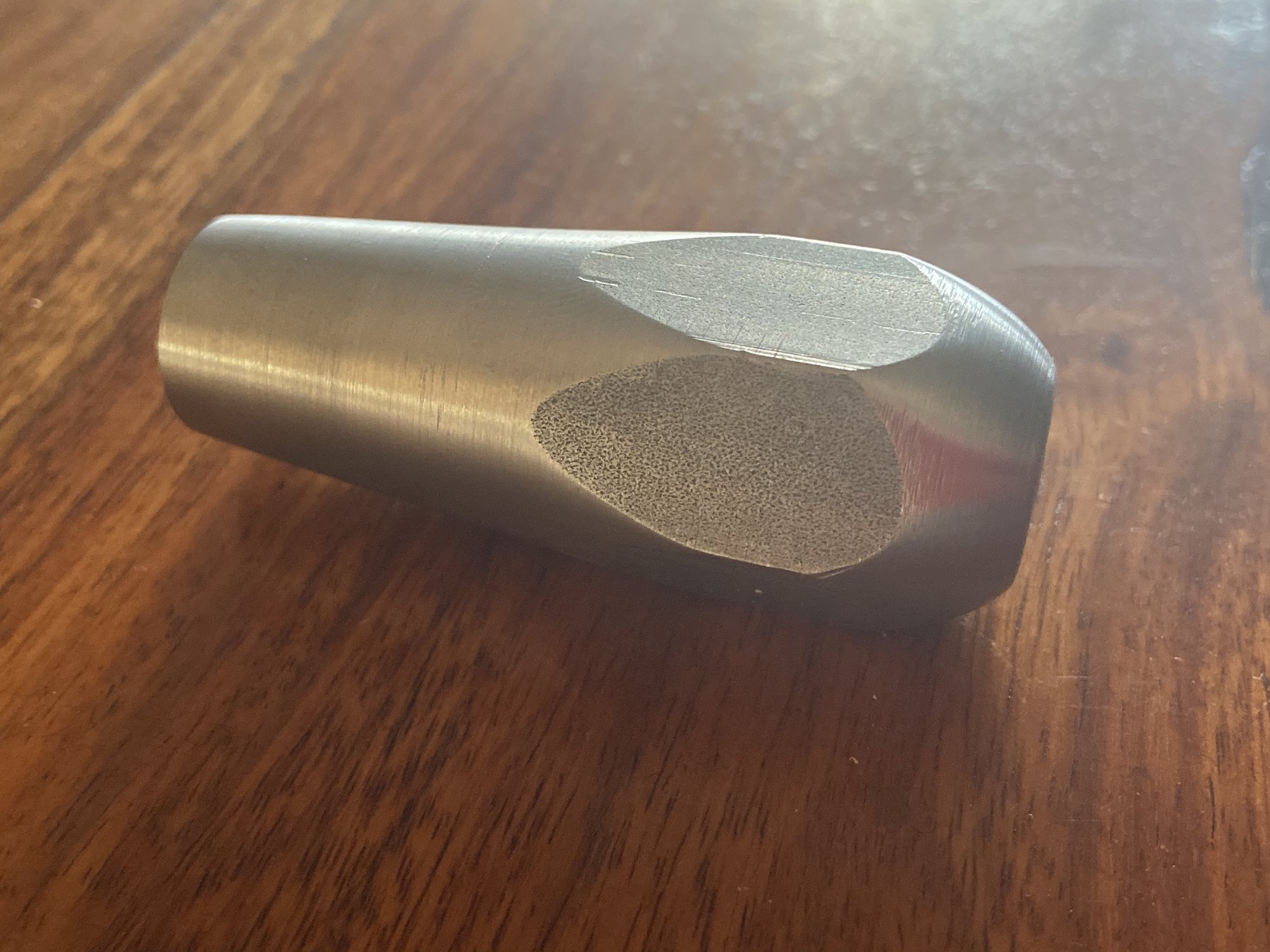

Found a piece of hex bar, turned a taper to match the chisel. Drilled and tapped M8 again
Fitted quite nicely, quick rub over with emery and it’s much better.
I’ll get some rattle cans Tommorow and paint the handle
