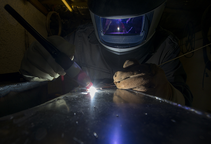

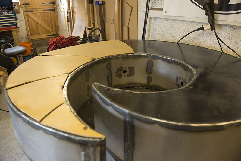

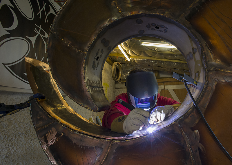

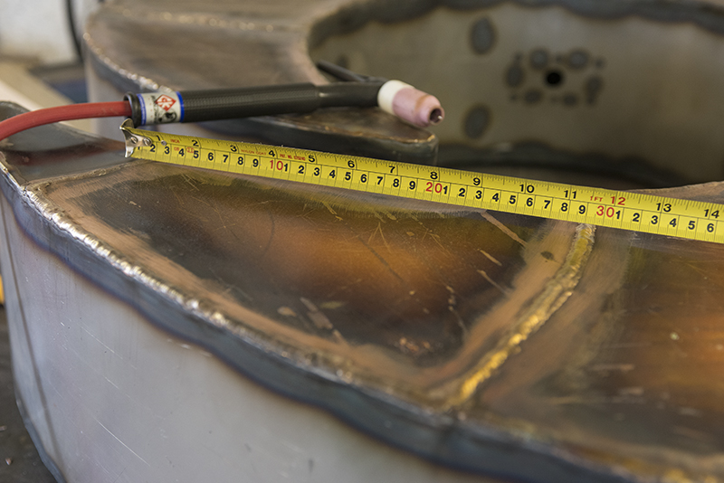

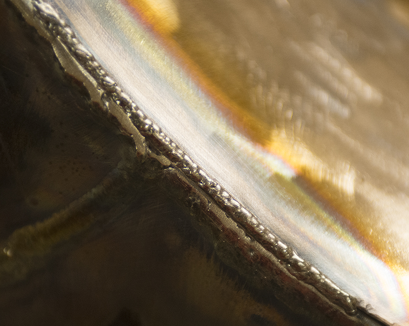

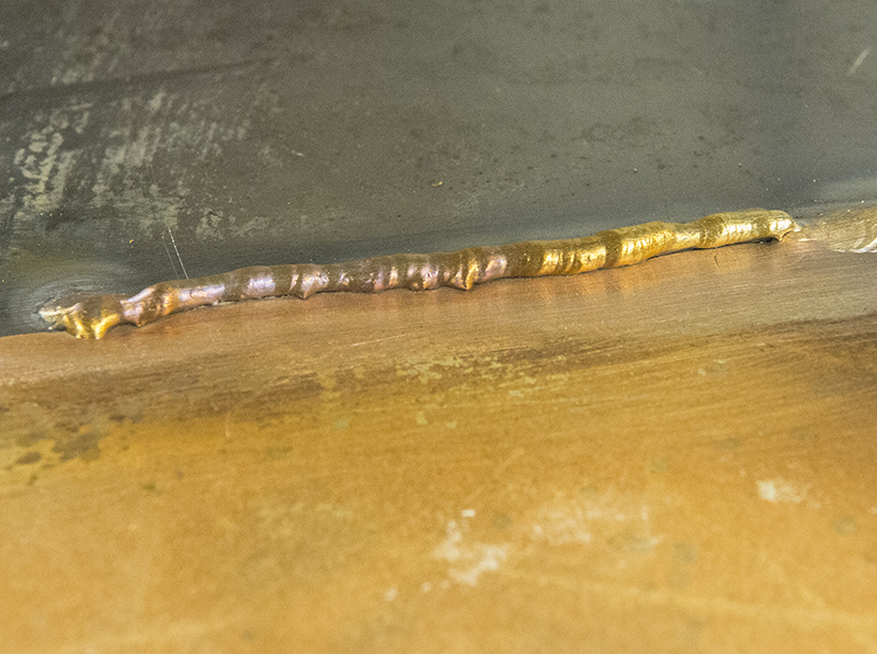

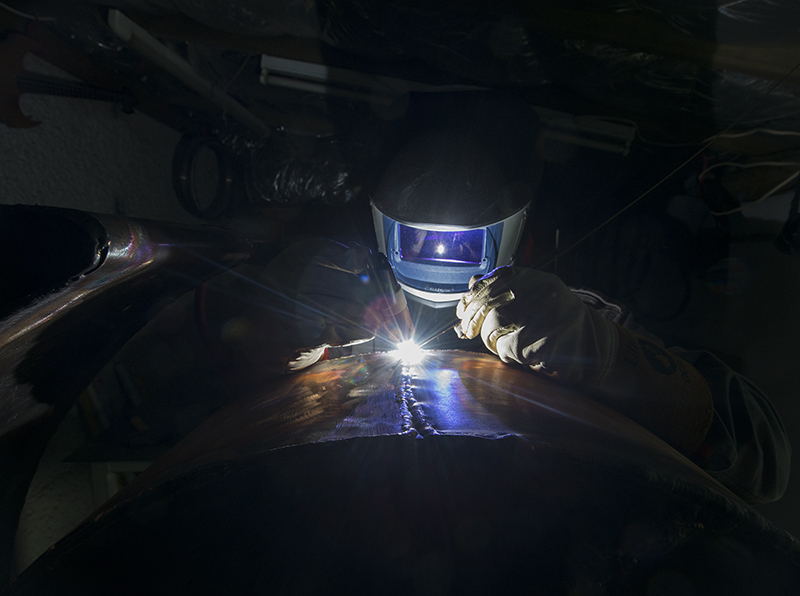

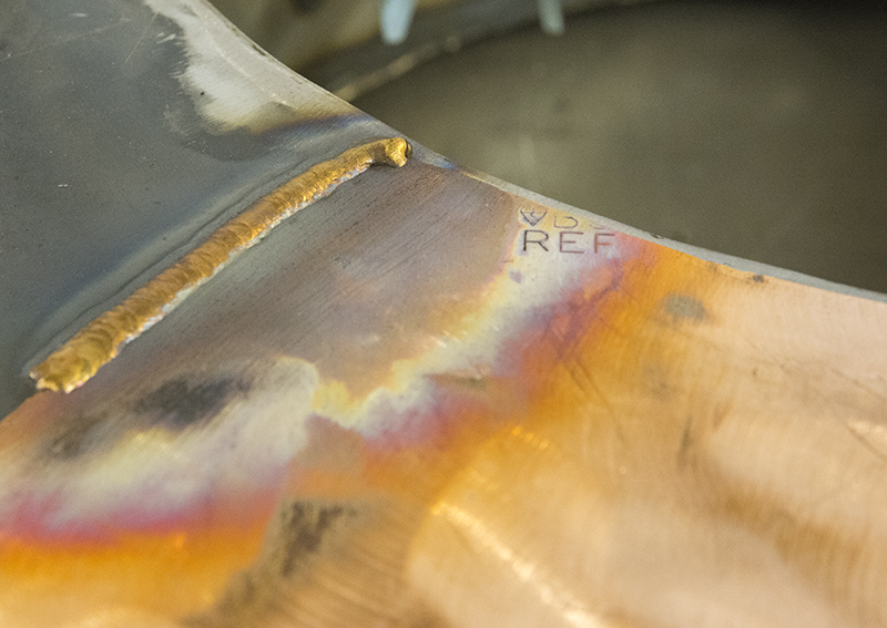

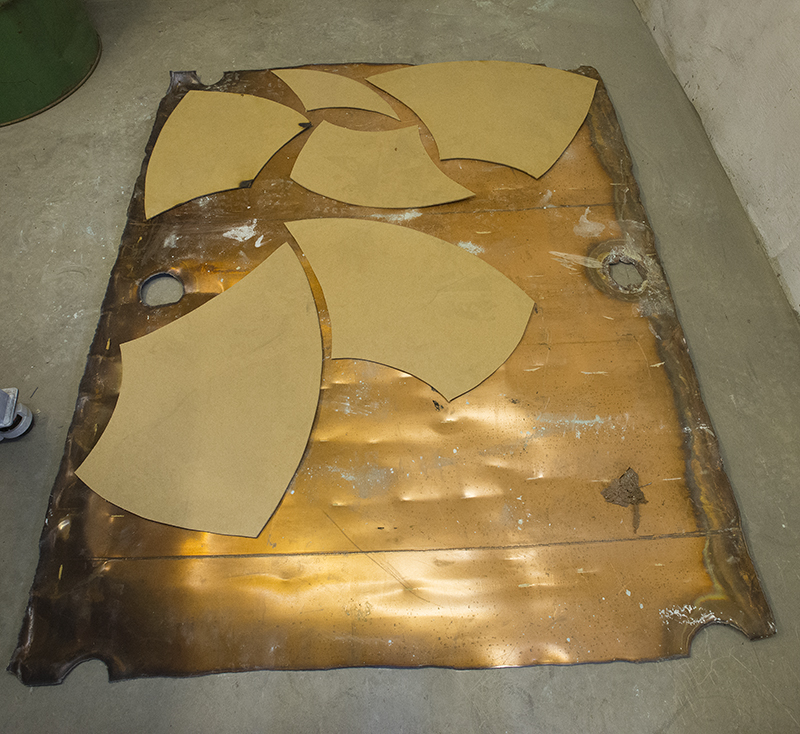

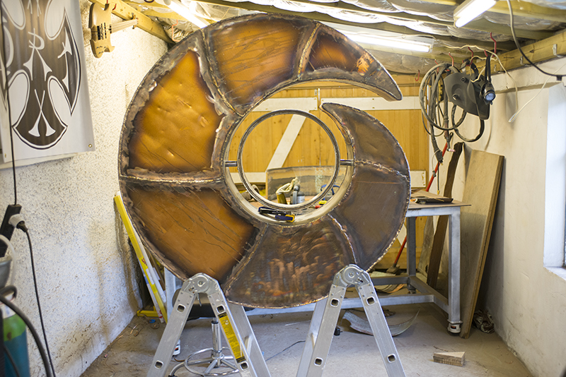

The copper is taking waaaaaaaaaaay longer than I'd expected and set aside time for. The main problem isn't the different thicknesses (.75mm copper, 3mm steel) it's copper's desire to move when heated. You're welding up a nice little joint then the copper pops up, creates a gap and you burn right through it. Just as well we wanted a very agricultural looking piece, eh?

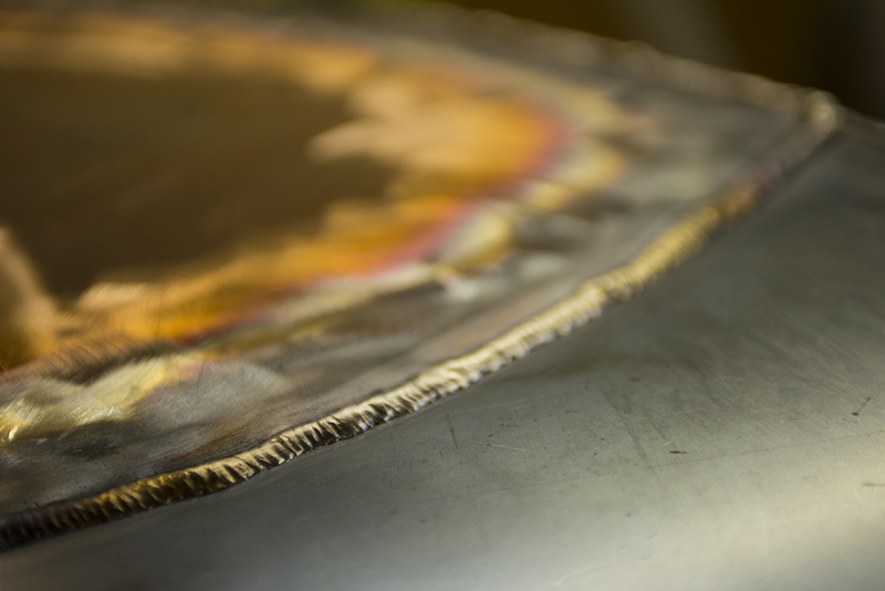

No third hand in the world can hold this stuff down so I've actually come up with a ridiculous method to fight the copper. First I lay down a really proud bead of filler on the steel, right next to the copper. I then lay a bead of filler on the side of the filler bead so that it overlaps the copper and keeps if from popping up, if you're careful.
Then do a proper pass to tie the filler into both pieces
Oooh, pretty...
Obviously, this takes considerably longer than just pushing puddles. This piece, the second to smallest, took just under 2.5 hours (including cutting and shaping the copper).

Like y'all said, this stuff is at a premium so can't waste any.

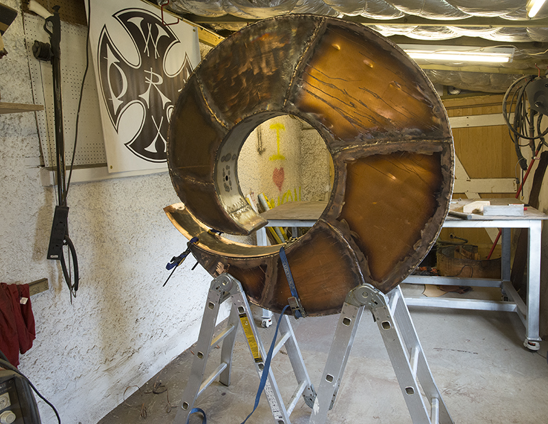

Today's goal, 4 panels (the largest one has a perimeter of just under 2m).
Hood down, music up; let's rock!
It was a looooooooooooooooooong day. 8am-9pm stopping only for my morning constitutional. All the copper pieces are cut out and, yeah, I got the 4 pieces on. One more day to work on it then back to work, so I'll be back out around 9 again. Livin da dream.

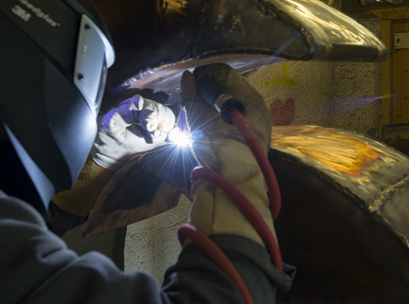

After laying down probably 1/2 Km of weld, I'm starting to predict what this copper will do and can get some decent looking joins

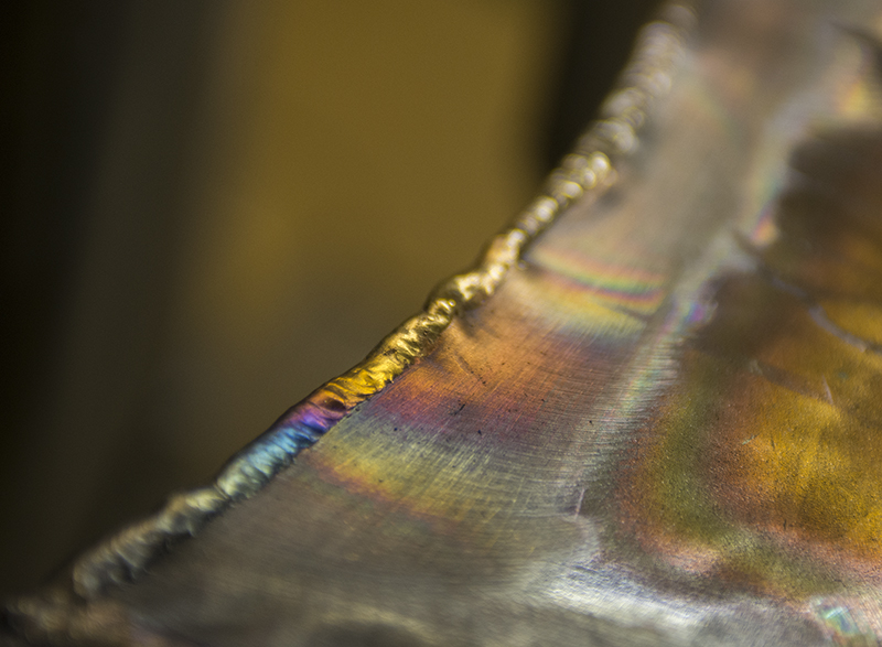

Can anyone tell the difference between these 2 pics?

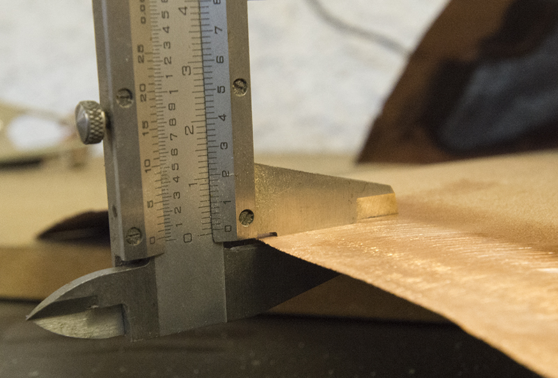

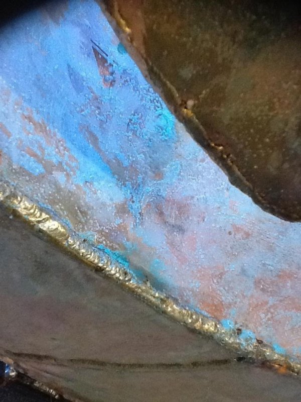

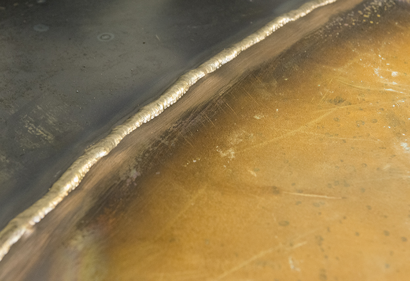

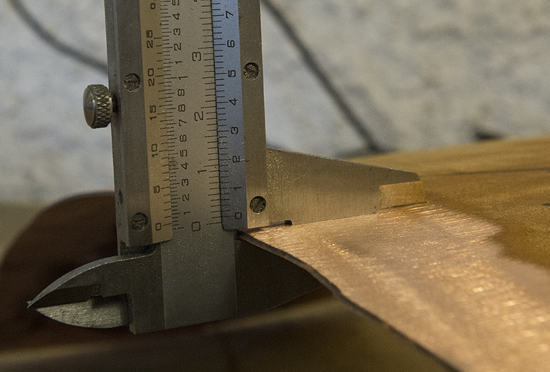

I opened up my last water tank and, after I cut it up into strips, noticed it wasn't as flexible as the rest of the copper. This tank was apparently the middle grade of copper used for water tanks and it was only .3mm thicker than the rest, but it made a world of difference. It's so easy to work with that I'd have been done ages ago if I'd been using this all along. It doesn't move around nearly as bad as the slightly thinner stuff. I can actually just run beads like I'd planned on doing when I started this. Hard to see, but this bead was done in one pass with no cleverness needed - as much of a stack as you're gonna get with Sil-bronze and was still behaving as I went vertical with the join
The downside to the thicker copper is that it's a much better conductor. You'd be surprised how far the heat can travel! I found myself welding in big gauntlets half the time.

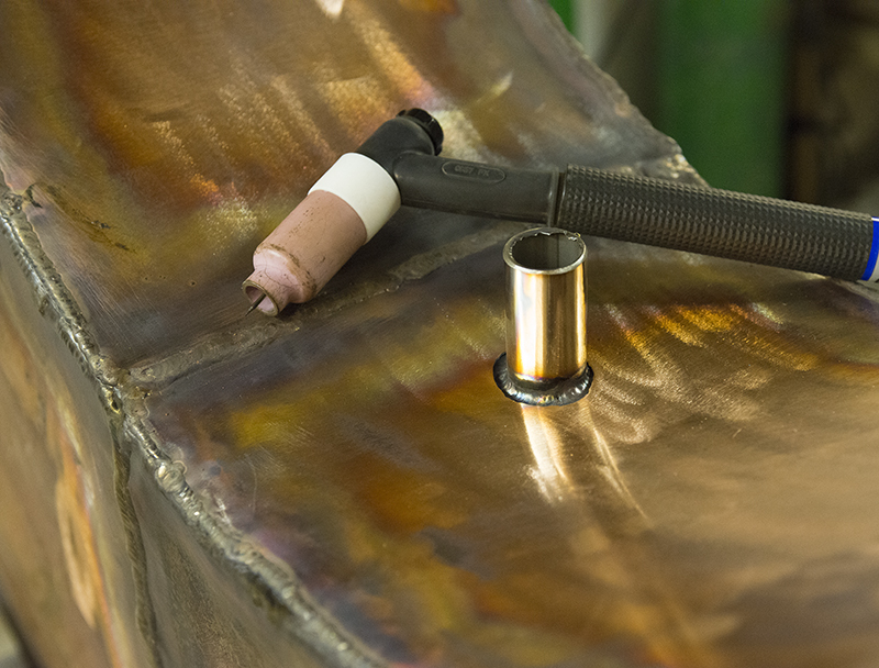

The 3 posts are in and the joins aren't too shabby. I was really fading by this point - I have just come back from Brazil and haven't really slept, let alone shake off the jet lag. To be honest, I couldn't even focus when I did these welds late at night and didn't really care how they came out. Shame I have to cover up a decent little weld with a ton of braze filler

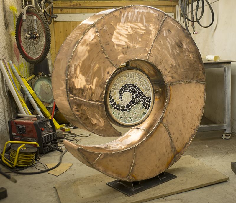

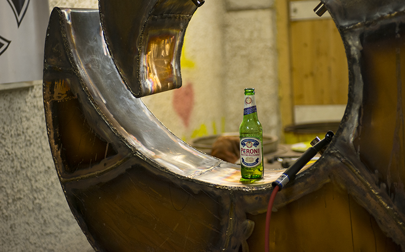

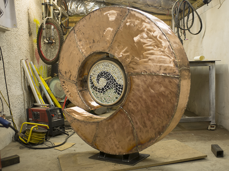

Except for cutting around the baseplate (which I haven't quite figured out how to do yet) that be the copper done! How do ya'll like my new beer holder?

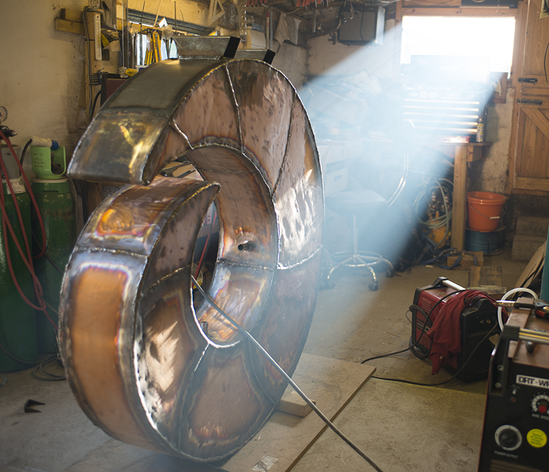

In the homestretch now, but still a few long days ahead...
Looking good, are you sick of it yet?

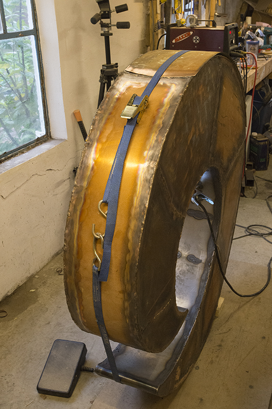

Well, this thing gets bolted in on Thursday and unveiled on Friday; I'm off to work tomorrow so I guess this post better end with my work finished.
Fired up the MIG for the first time in ages to do the mounts for the baseplate. Because I've been doing so much TIG work I noticed a few oddities. I kept trying to use a foot pedal which wasn't there and I kept the torch in position for the postflow, which also wasn't there. The wonderful MIG smoke made for an interesting pic, though
Cut down a couple sections of 60 mil box and tapered the ends. These feet will be welded on 3 sides to a 10 mil plate. Damn thing fell on me while I was trying to set the feet where I wanted them. Let's just say it's heavy.

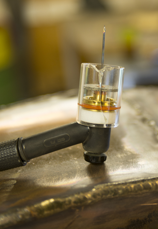

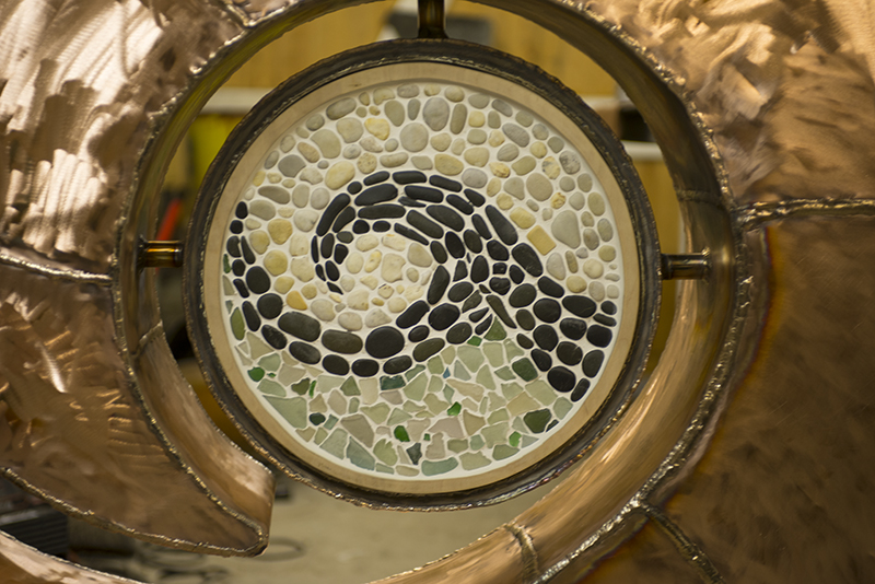

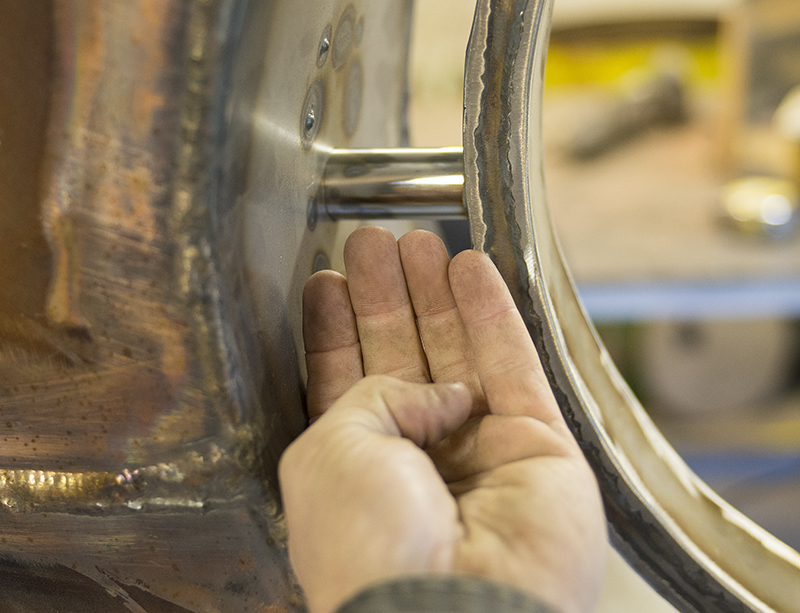

I'd been dreading welding the ss ring into place for a while now. This was a major design fail on my part. This is why I make a prototype wherever possible - I was doing a lot of 'firsts' on this project and I don't really like that. I would have designed this differently were I to make it again. I fiddled around with this for about an hour and did the best I could. The 3 joins are welded about 50-60 per cent and brazed up nearly all the way 'round. Just between us, there's a mil here and there that I just couldn't get to.

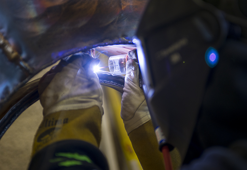

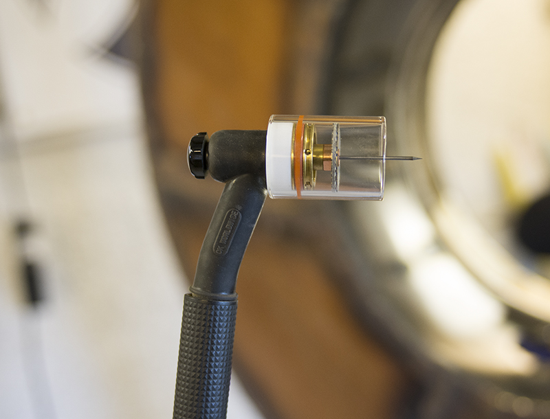

Jumbo gas lens on and flow set to 11 lpm - tungsten out to 1 1/2". All I could do was spark it up and hope for the best
This was one of the most frustrating things I'd come across in quite some time. I'd say about 80% of the time I was either hitting the cup at the front or the cap at the back and just couldn't get the tungsten pointed where she needed to point. I phoned up Rapid Welding and apparently warranties don't cover throwing a temper tantrum and tossing your torch onto the welding table (which happened to be about 3m away at the time) whilst swearing like a drunken sailor. Always read the fine print, man. Always read the fine print.
W'eva. What's done is done. It's rock solid and nobody will ever be able to see it. Still disappointing for me, though.

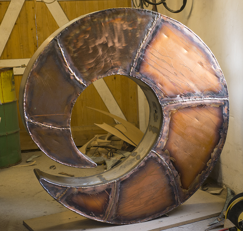

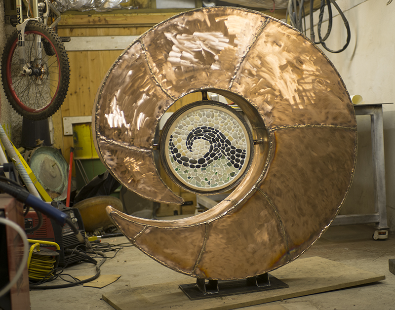

Anyway, I'm pleased to say that when I shut the workshop lights out half an hour ago we had this
That's the metal work done. I'll turn it over to the sculptress now and she can patinate it and go grab the glory at the unveiling on Friday.
The mosaic is inlaid into a 90mm block of Birch Ply and has been made using beach pebbles and beach glass from the beach directly in front of the sculpture's location

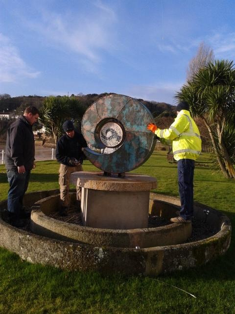

Apparently this lot didn't have a clue as to how to mount the sculpture. Why the project manager used builders for this is beyond me. A steel erector or basic engineer shop would have had this done in under an hour.
