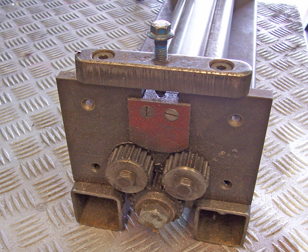

Would those happily roll 1.6mm stainless Paul?I can't believe that you lot think £29.60 is expensive. I would jump at that, even though I have a set of 500 x 40mm rolls that would roll them.
Buy a sheet of 304 / 316, cut them out, roll, tack, weld presumably TIG with backing gas, clean, pack, arrange a courier, (which will cost little more than shipping from USA)
write, print and send an invoice, all for 5 off ?
To the OP, copy these and then you can make your own.
Paul G
Did you make them yourself? Nice job mate.
Nicely done Paul. Yeah that would be great to see some nice all round shots of those.The 40mm rollers started life as ram shafts so tough material, and yes, 16g stainless.
Doesn't show in that photo but they're pyramid rolls, which always roll thicker material than initial pinch.
The bottom two rolls are linked with an idler cog so they revolve the same way, all three are change wheel
cogs from a Harrison lathe.
The rest is 50mm box and 12mm plate.
Can do end pics if you fancy making a set.
Paul G

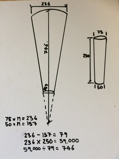

I need these to be Mint and Ripple Free, this isnt for some home made project
If they are done on a smooth set they won't have imperfections. The key to a cone as I've made many is to have an accurate shape cut out so that when the ends finally marry up they touch all the way across giving you your two diameters and have flat faces. You've got to roll it in an arc following the two curves of the pre cut sheet. So they must start with the rollers parallel to the first edge and finish with the rollers parallel to the exit edge. Back and forth applying a little pressure each time till the ends meet. This is effectively letting the sheet slip on the smaller diameter. If you don't do this you'll end up with it been open at one end.I need these to be Mint and Ripple Free, this isnt for some home made projec
Nice to see a hefty set but still get down to those small rads. The old saying goes if you want it right make it yourself
Appreciate that paul. Very nice work gone into that.Just for you Richard.
The three holes are drilled in the end plates (bolted together and match drilled) then cut down to the edge of the top hole ether side
and save this piece to make the slide.
I drilled & tapped into the edge of the 12 plate for the clamp bars and also to fix to the box incase I need to take it apart.
Cheers
Paul G
