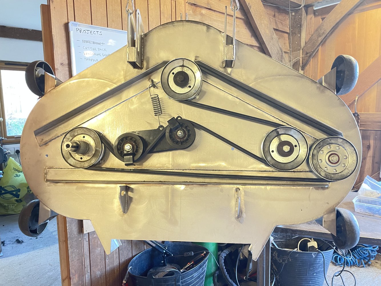

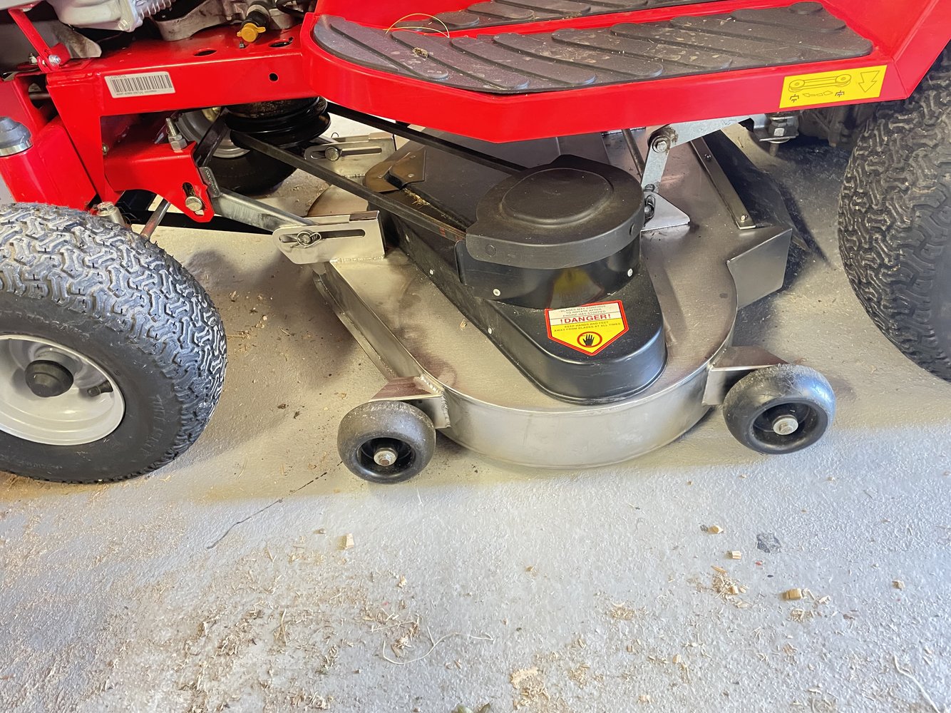

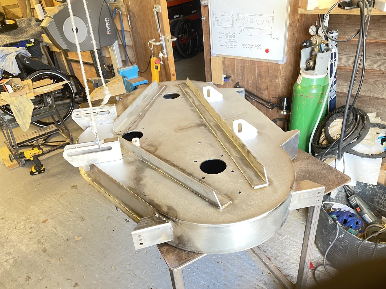

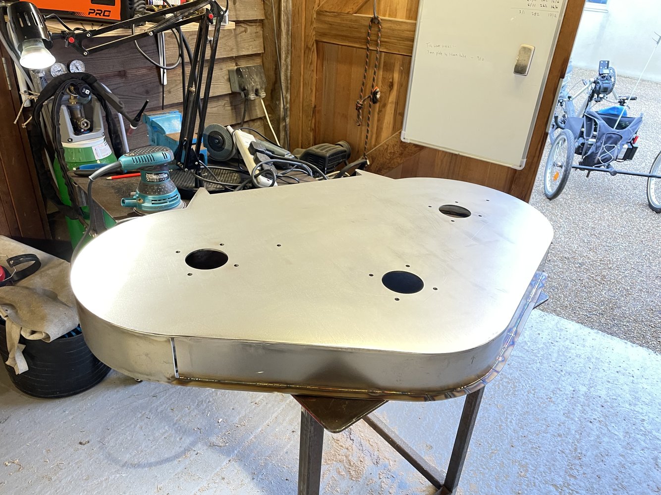

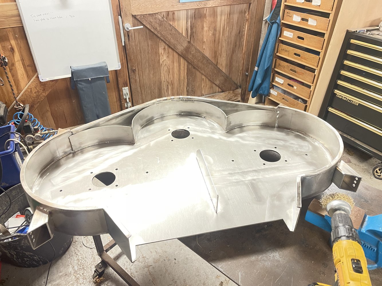

What thickness steel is that Bob?@Bobupndown , best pics I can do:

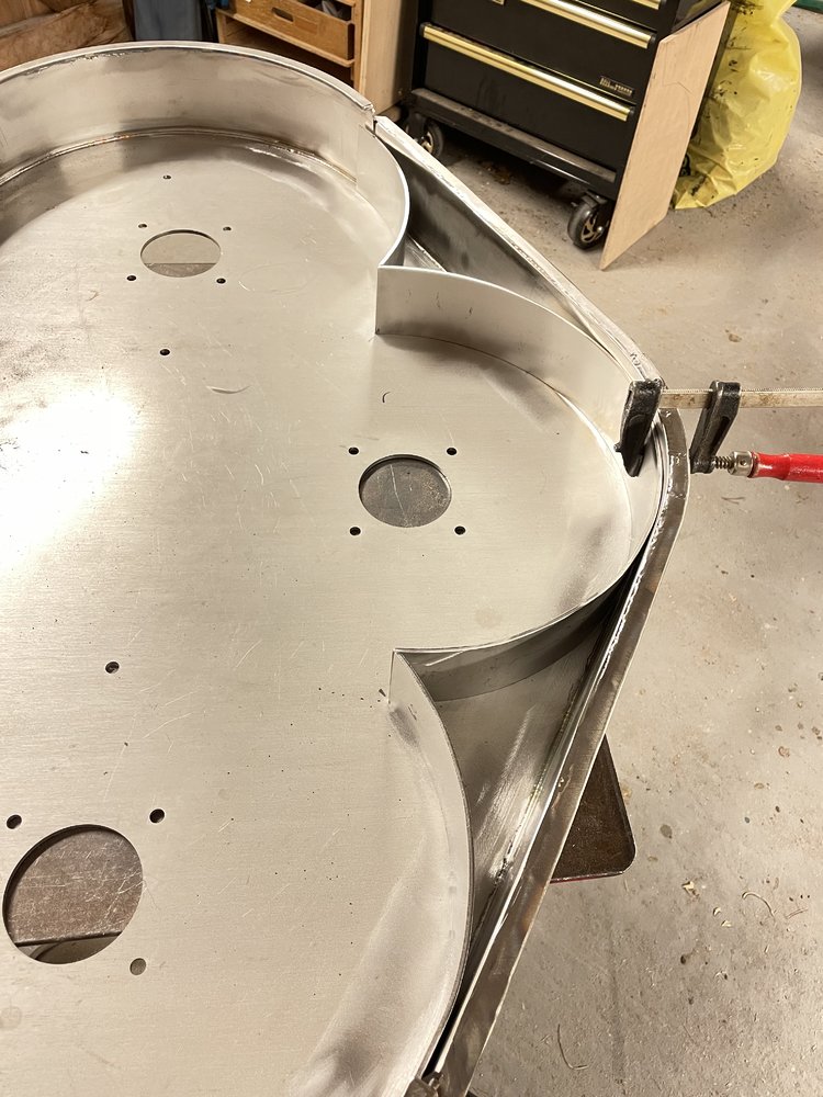

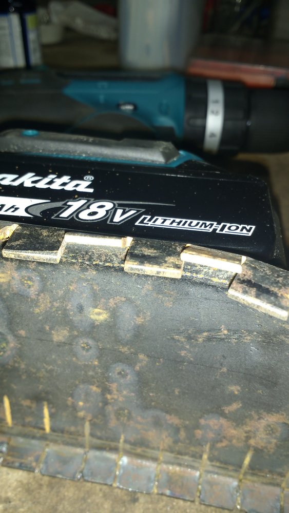

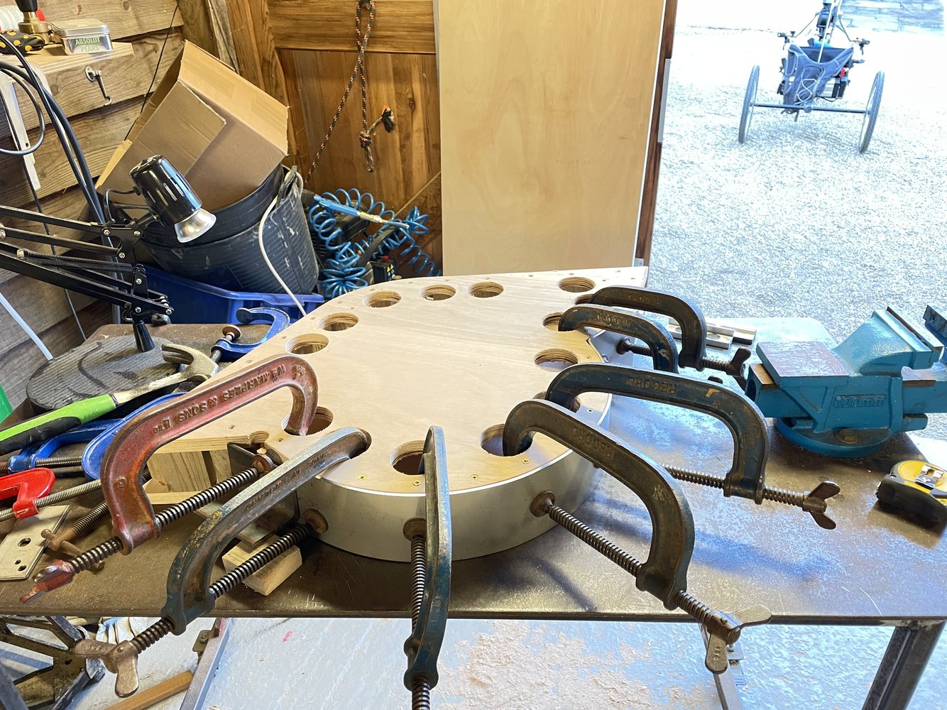

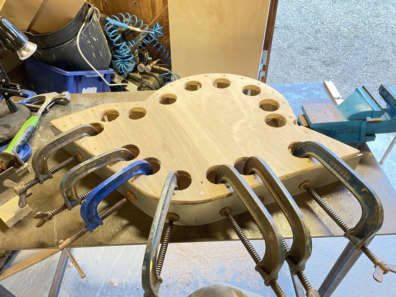

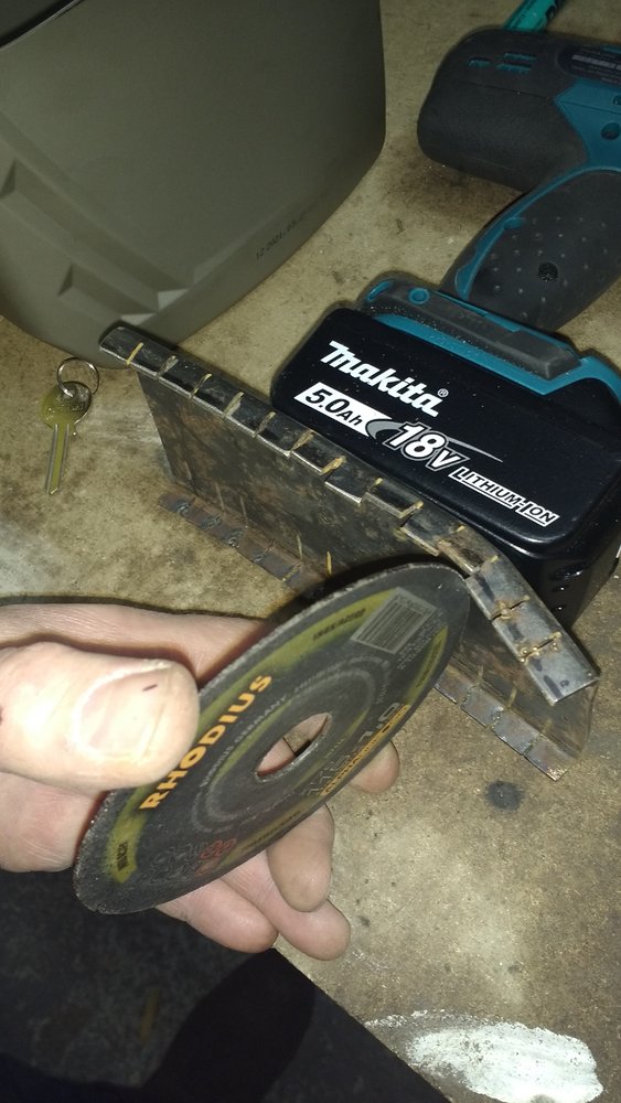

Notch the flanges with a slitting disc. I went every 10mm. Bend tabs up / down. Bend round the mower deck. Just tweak till it fits.

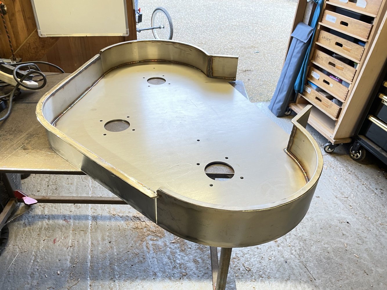

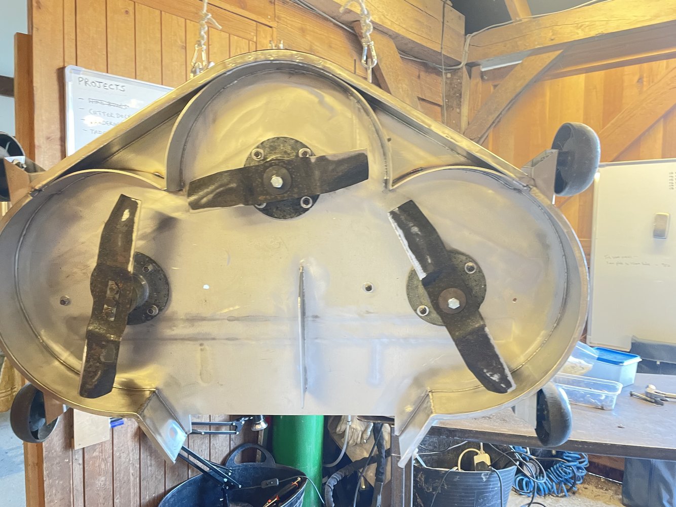

Cut the overlap off:

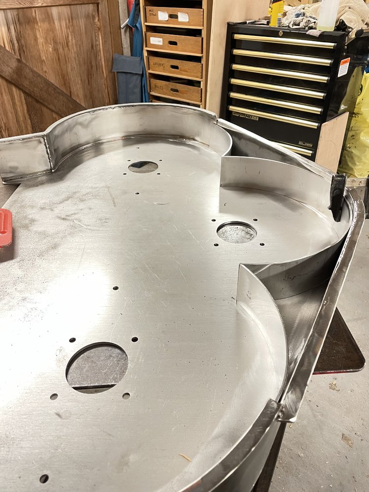

Weld the resultant gaps up.

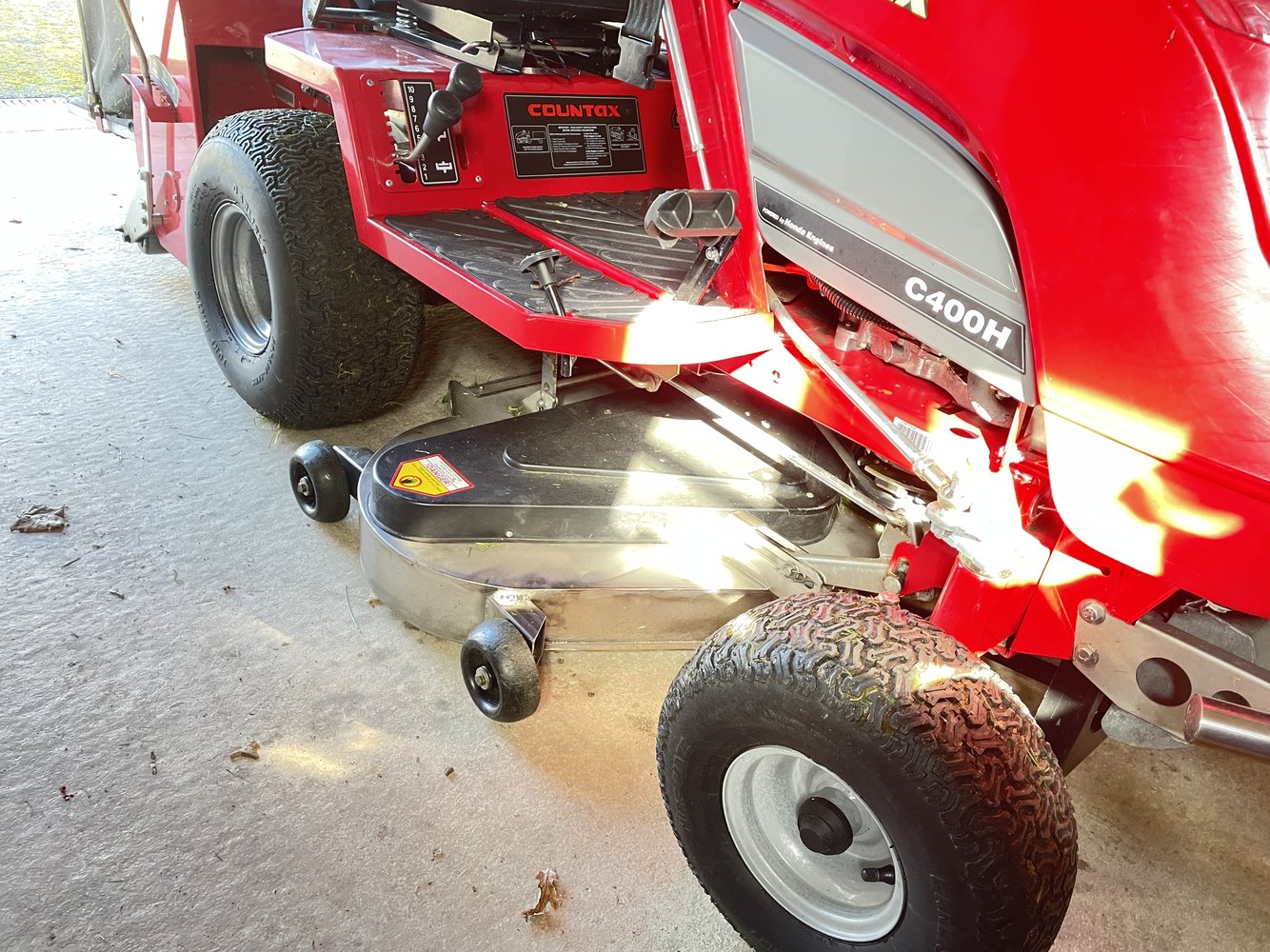

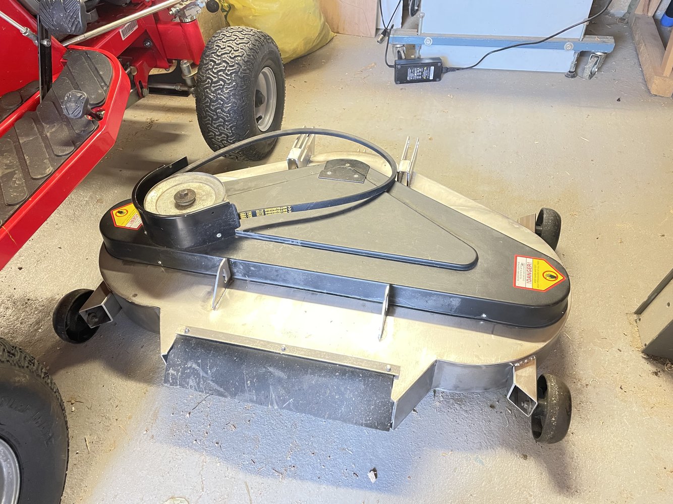

Sorry, got confused - thanks.It was me and I used 2mm mild.
