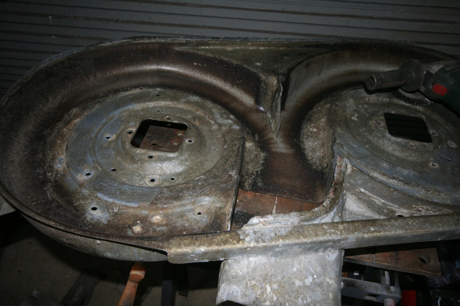

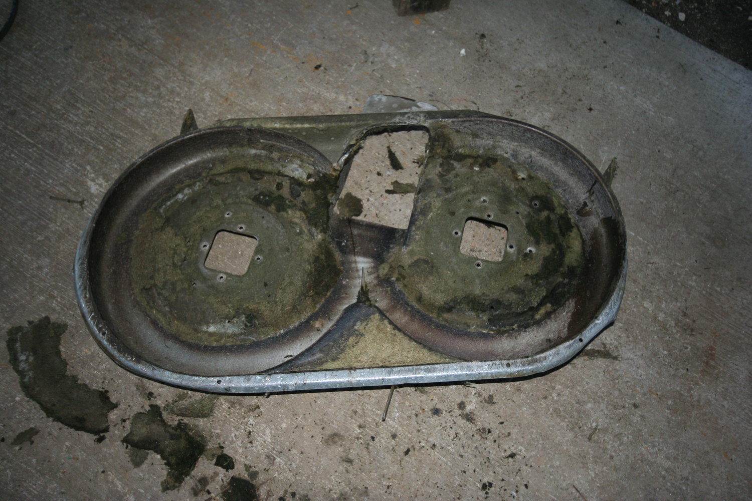

About 10 years ago I bought a ride on that had the deck welded up.
I blasted it and had it galvanised.
I never clean it or even take the worst of the caked grass off it from one year to the next.
I had always intended painting the deck as well, but am just getting around to it now.
I pressure washed it and gave it a going over with a wire brush. (The galv is certainly getting used up in places.)
I will sweep blast it, give it a couple of coats of Jotun 90A then, for an experiment, do one half with glass flake epoxy and the other half with single pack stone chip. (Sikaguard 6440)
I have zinc rich epoxy but don't think it will stick well enough in this application which is why I'm going with the epoxy mastic.
I'll tell you which is best in a few years, but I can say hot dip galv does work.
