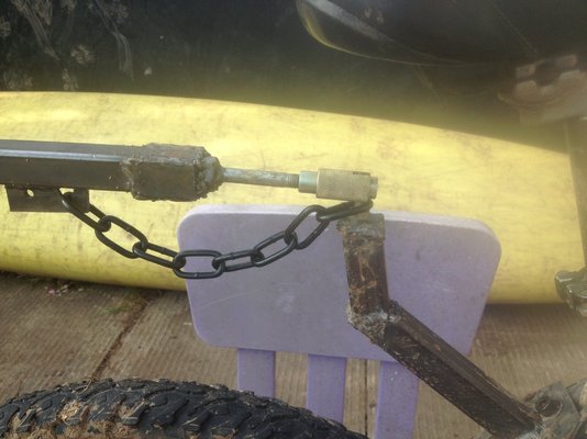

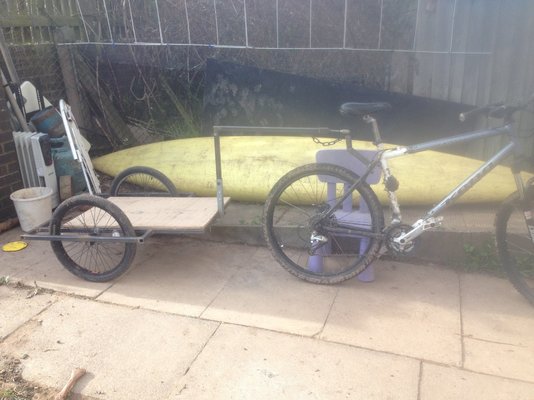

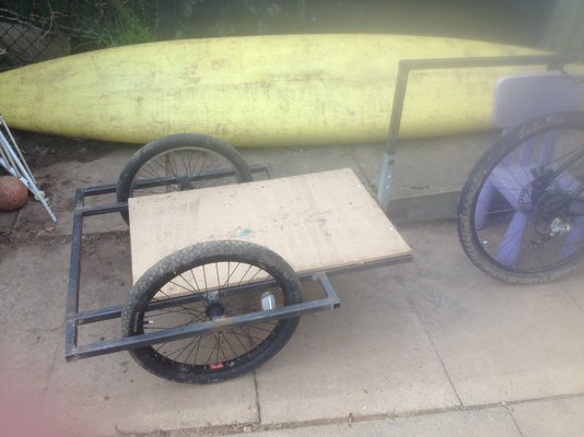

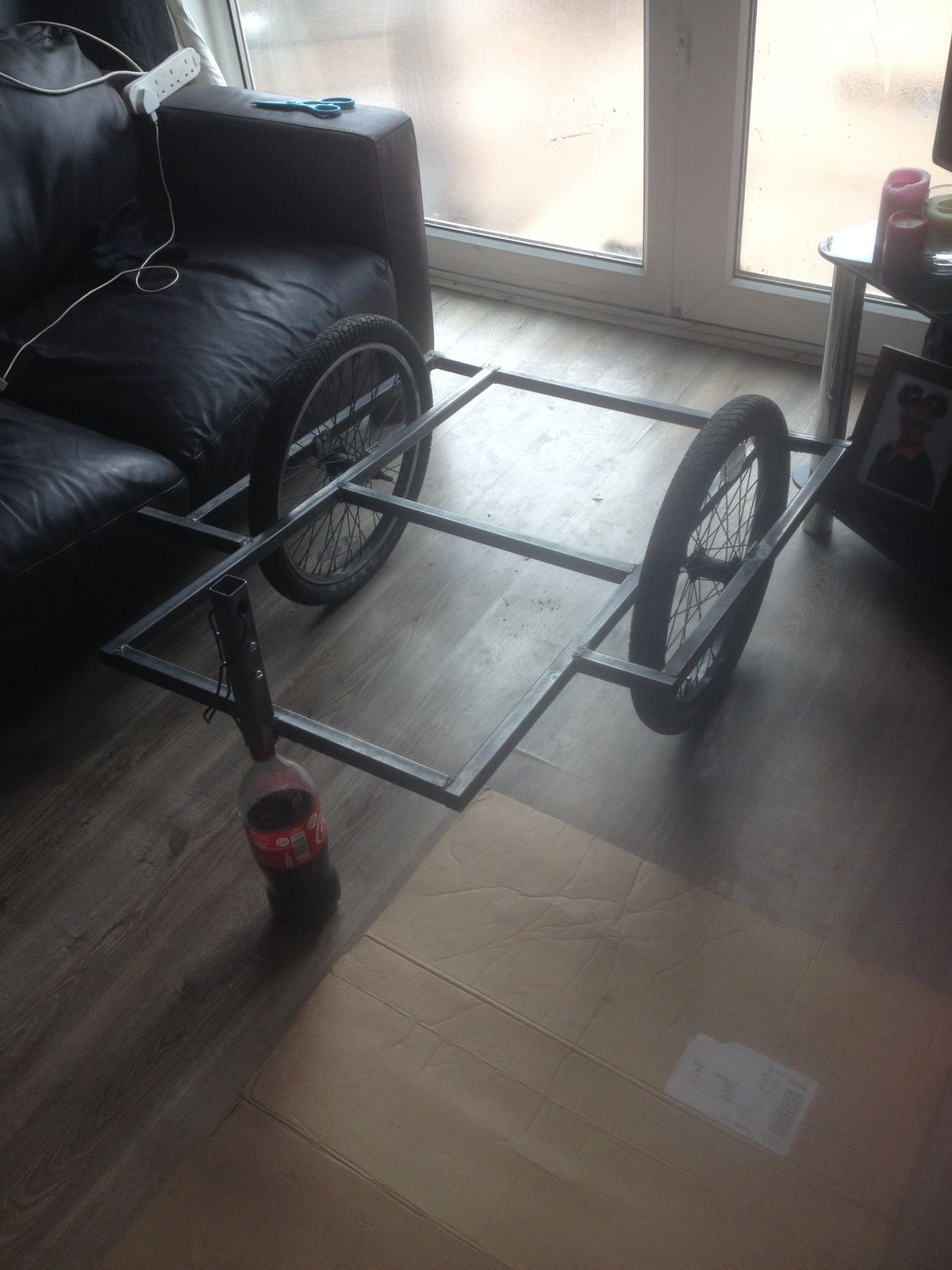

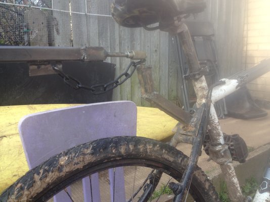

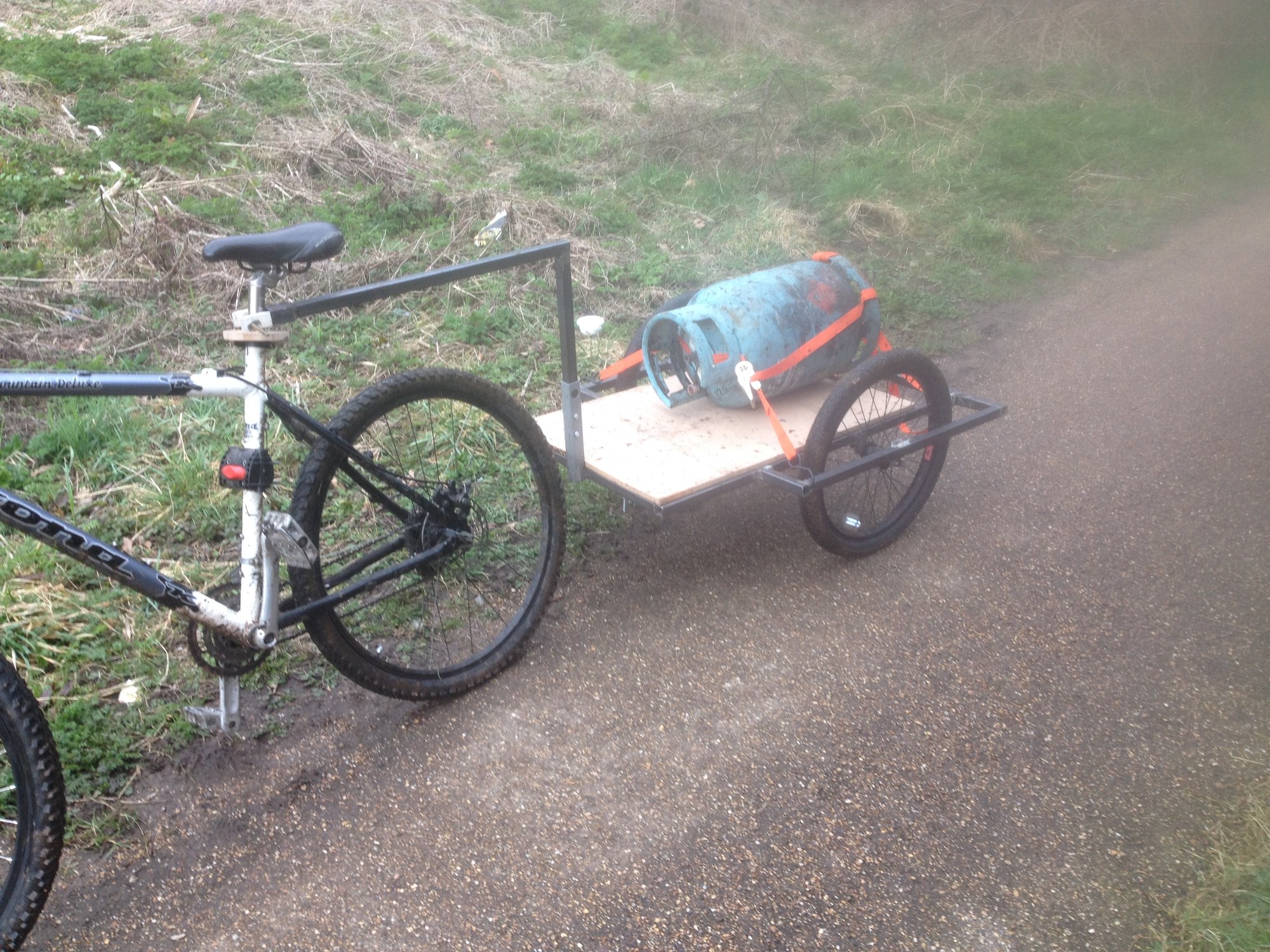

I ain't goin to lie I did want something that moved all axis like a trolley swivel wheel but just haven't found anything like that yet. Tbh it ain't goin to be used for 2 much weight just the odd bits of metal I find here an there. Yh a stupid idea I no but really wanted to get started an With the snow just didn't won't to wait. I'm abit in patient. Yes using a sealey mighty mig 100 using flux core. As I'm new to welding I didn't Evan no that could happen but defiantly won't make that mistake twiceHmm: I'm not convinced attaching the hitch to the bike post is the ideal way to be pulling a bit of weight. OK I guess if you are pulling something un-valuable like a child at no real speed on a Sunday through the park.

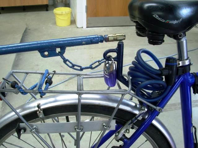

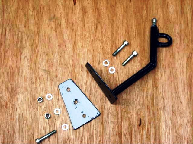

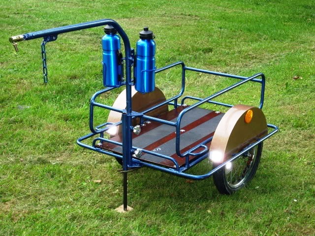

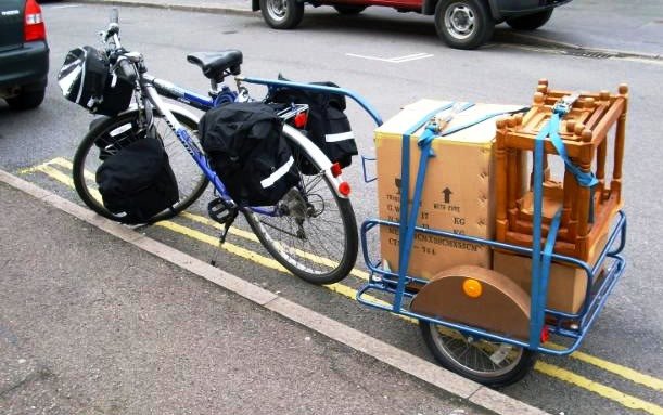

From what I have learned since using the trailer I built -

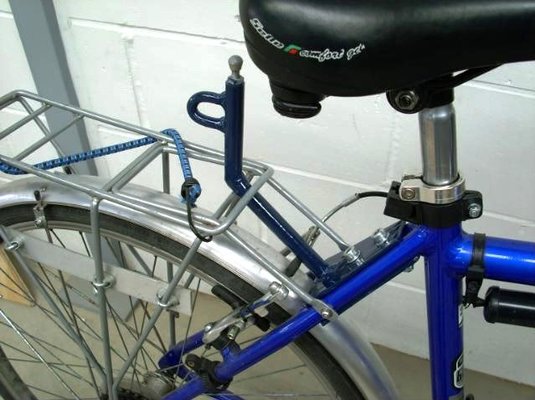

Ideally you want the hitch to move around all axis. Think when you are 'leaning in a corner'; you want the bike to tilt but trailer to remain flat. Or, if you are bumping up curbs or such.

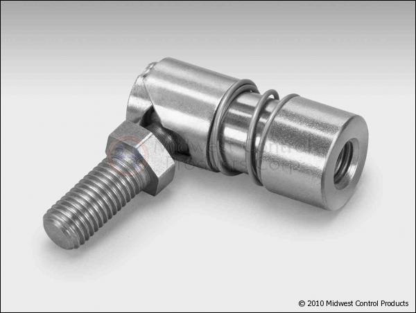

I used the wheelchair castor as it is what I had laying around, but equally, If you have any spare bike wheels perhaps you can butcher the axle and bearings into a swiverly thing. Hack a compressor coupler to that and you have your release mech.
If I were tempted to build a MK2 I would definitely think of building in some sort of 'absorption' into the towing arm. Cannot remember the correct terminology but 'buffeting or snatching' will have to do This becomes more apparent for me if I tow heavy loads.
**I would be very wary of welding indoors! The hot sparks WILL damage your glass and floor (Or you may be making space on the trailer for a tent!)
Are you using shielded wire, hence no shrould?
Finally: Don't underestimate how much damage you can do to yourself welding without covering up - please!
