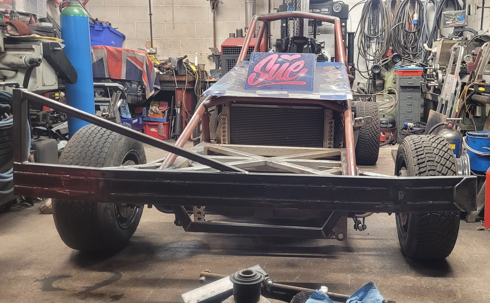

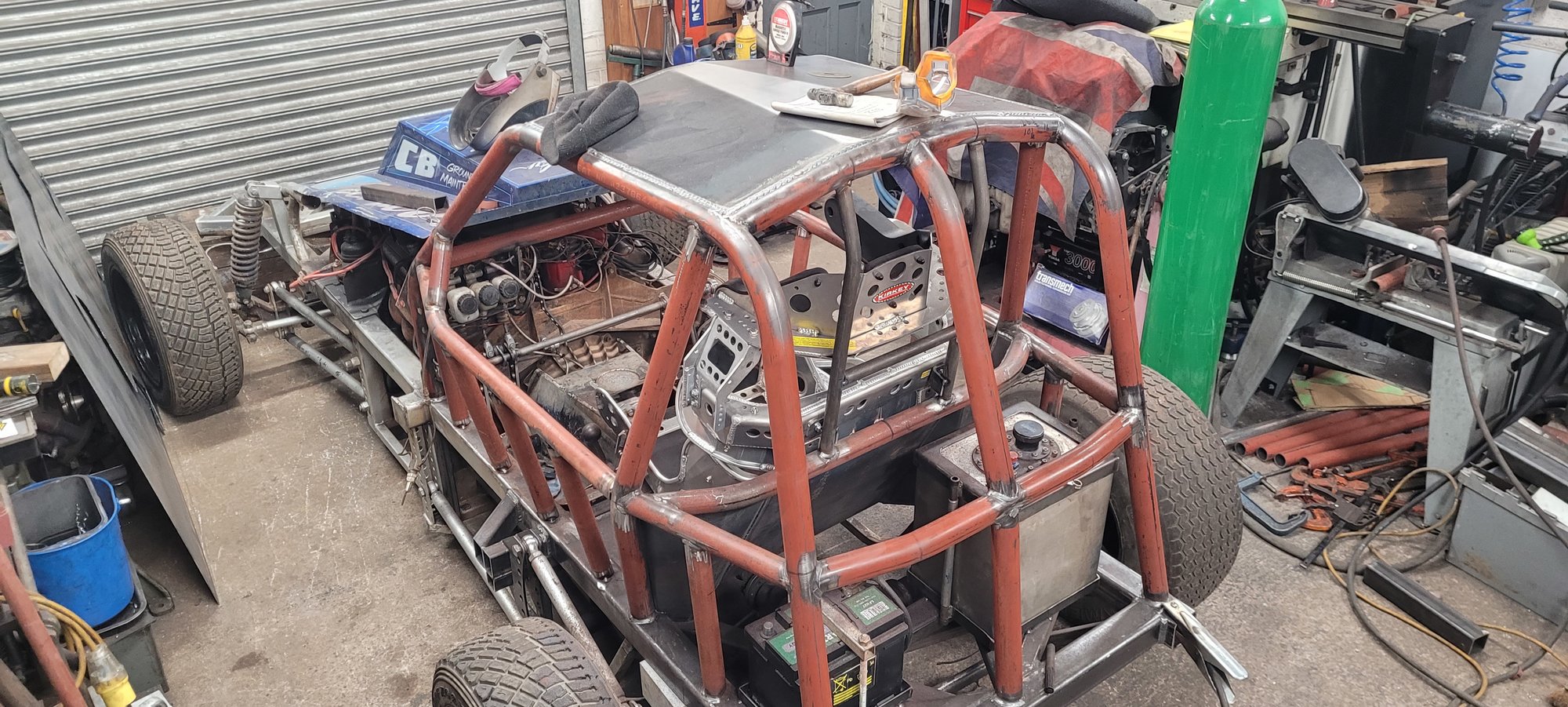

1300kg min 1500kg maxHow much do these weigh when they are all built up and ready to go ?
How much horse power will it pump out?1300kg min 1500kg max
Around 600 at the moment but hoping to get bits together for 750-800 at a later date.How much horse power will it pump out?

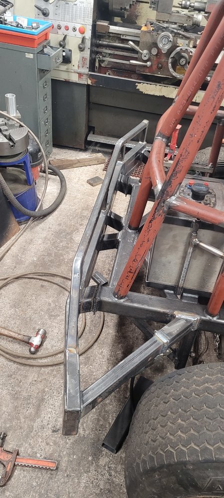

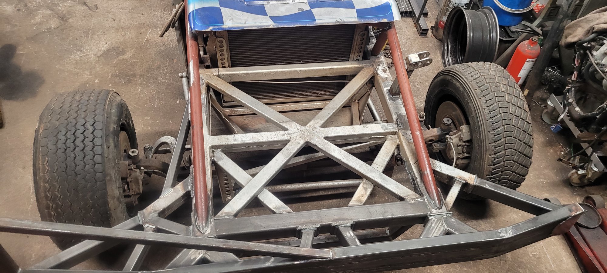

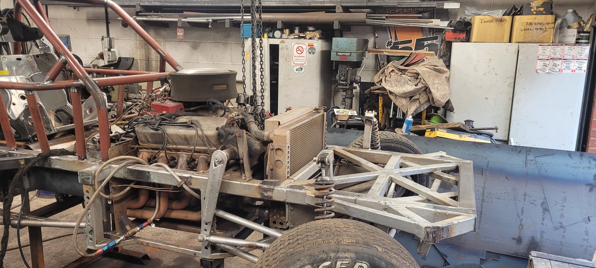

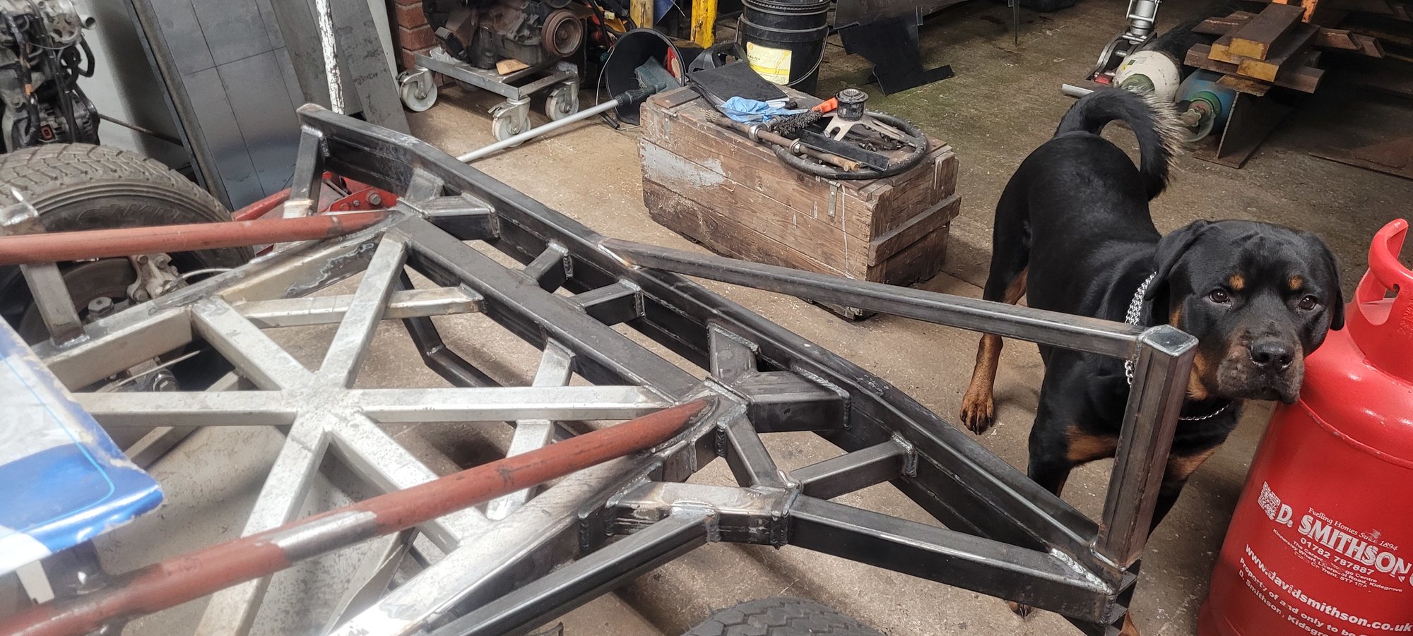

Tell me about it, I should have started from scratch, it would have been quickerjust the front half the chassis to replace and you will have a brand new car![]()

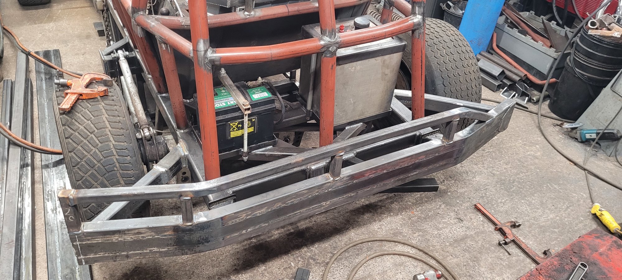

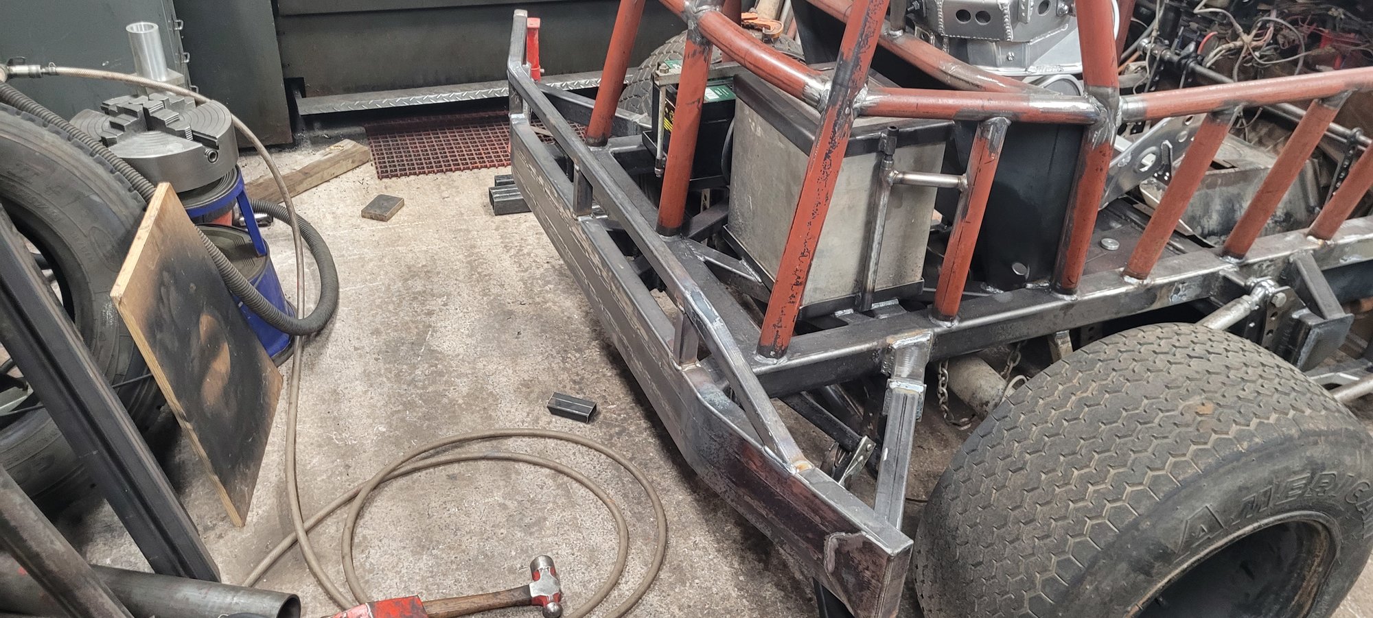

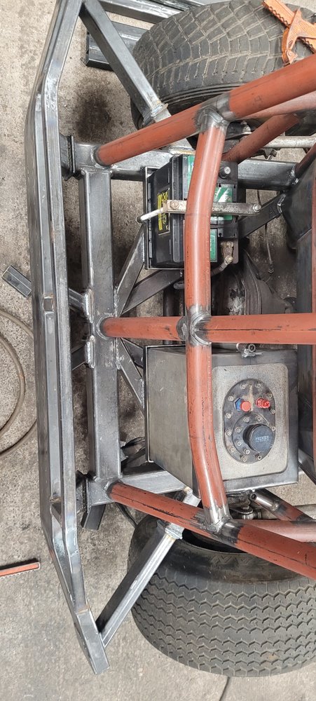

Yes there are rules, it's 19" from the ground to centre of bumper +/- 2"Is there a set of regulations that set out bumper heights so contact is bumper to bumper most of the time or are you free to decide how to make your bumpers ?
I'm only doing shale, I'm hoping to be out at Kings Lynn on March the 16th.When and where is your first race do you know yet, as long as it's not a million miles away could be a trip out to watch you test those bumpers
