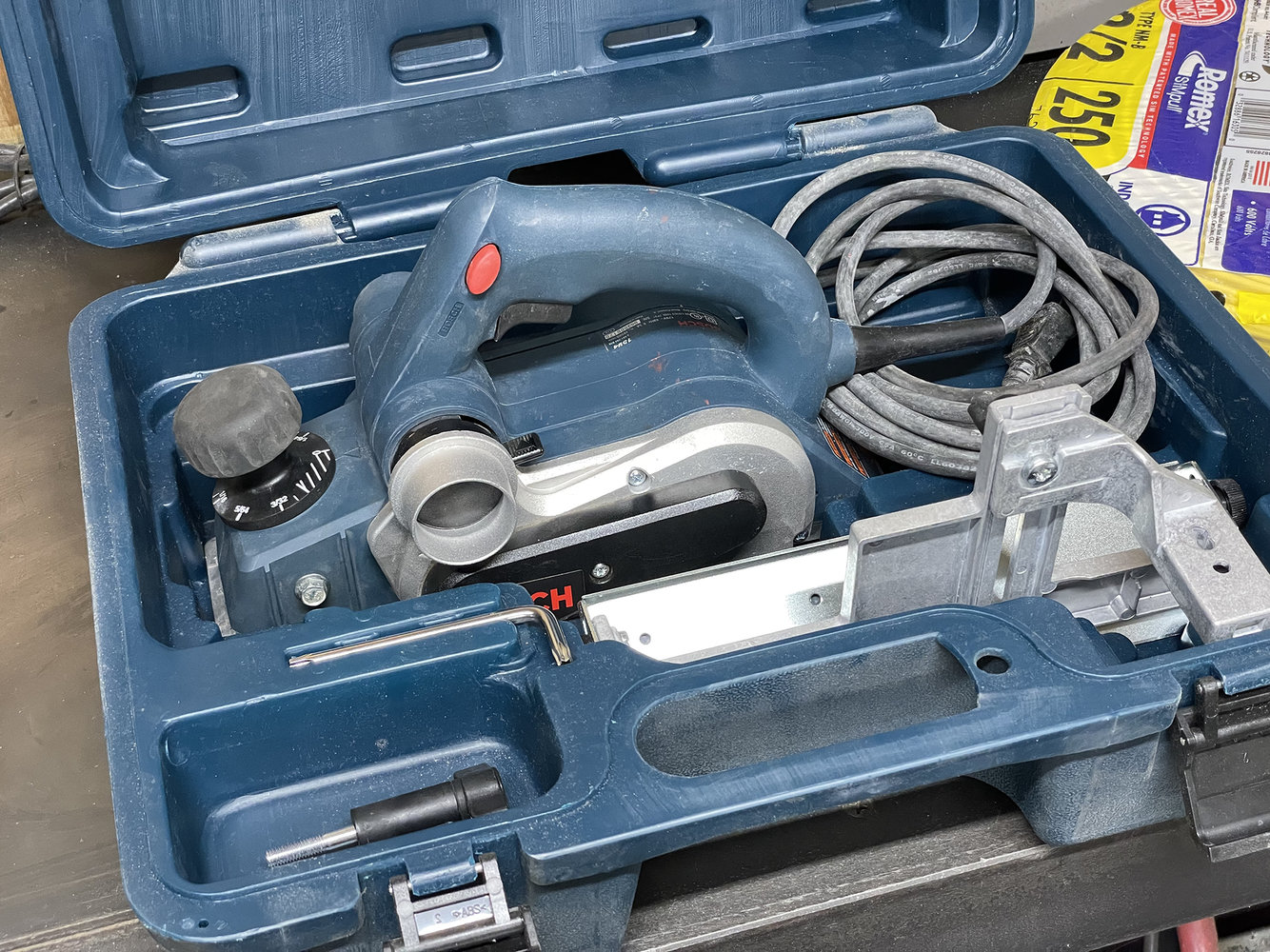

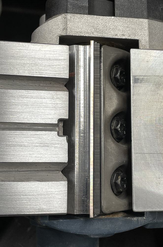

Oops. This is one of the hazards of home renovation work. I hit a hidden nail with my Bosch hand planer, which complained about it by pulling out the nail and spewing out little chunks of the carbide planing knives as well as a few bits of the knife holders. Next time, I'll try to remember to use my hand metal detector before planing old boards.
Ordered new knives, knife holders, stops, and stop screws/washers. Installed the new parts today, smoothed out a couple of small dings in the plates, and checked the knives for depth and flatness within .001 inch. This is not a very expensive planer, but the parts (not counting the expendable knives) only came to about $27.00 including tax and postage (plus about an hour and a half of my time), so I guess it was worth fixing.
