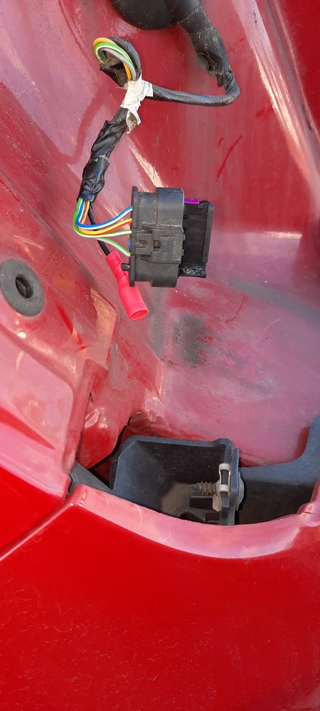

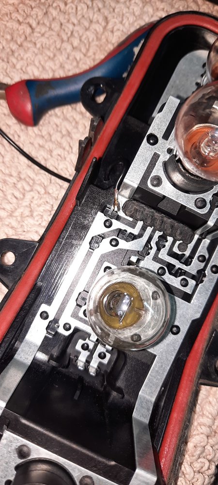

Quick bypass jobbie on the daughters Fiat 500 X, common fault where the earth overheats on the pin and takes out the circuit.
