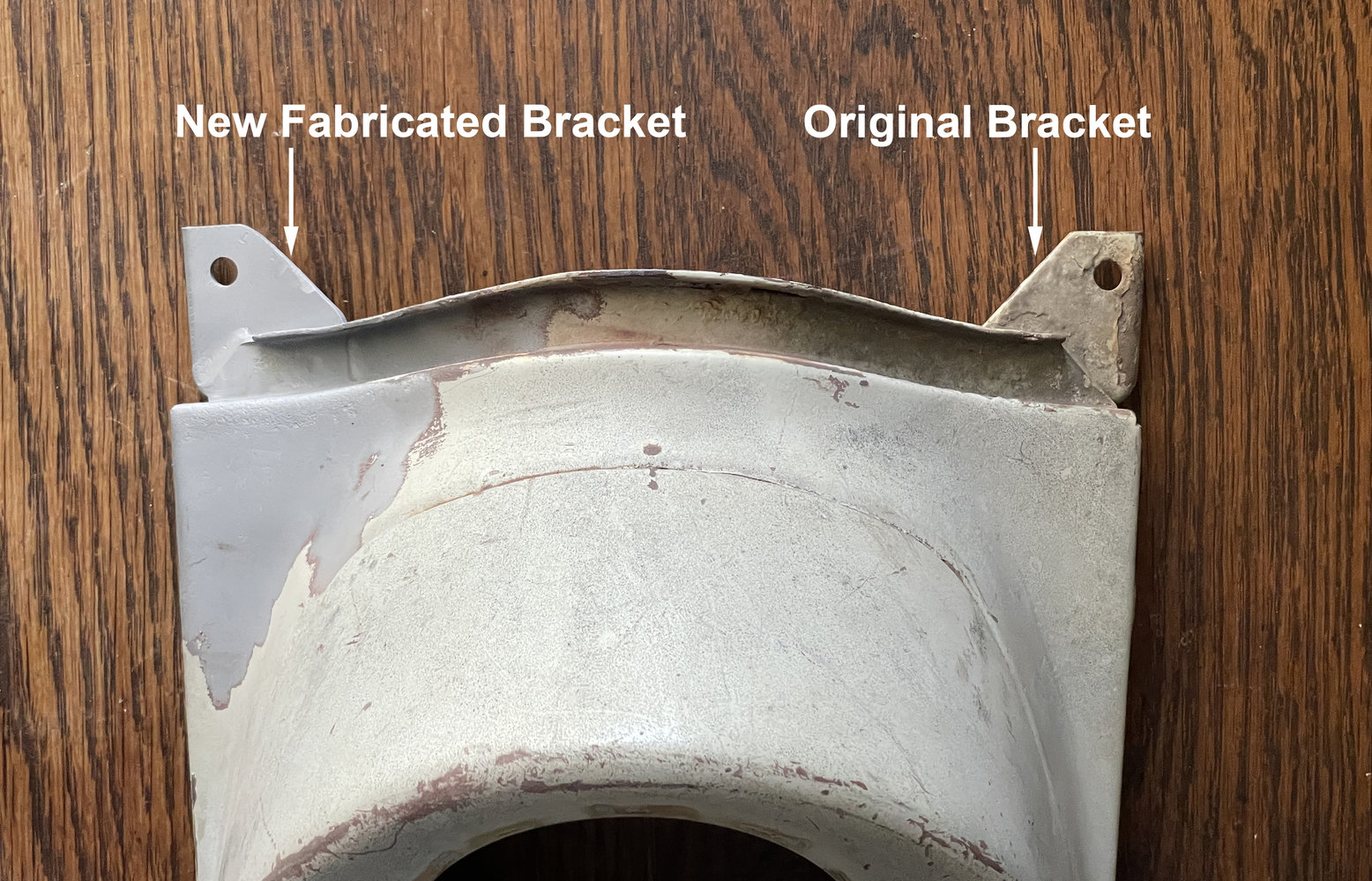

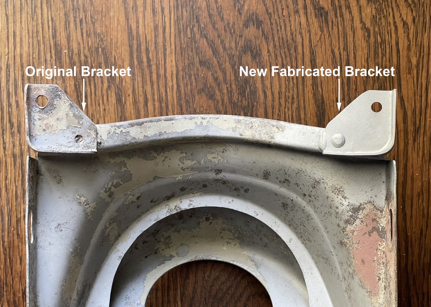

Just a small repair today. I'm overhauling the steering gearbox of our 1953 Ford NAA tractor, and while I'm waiting for the new parts to arrive, I've started doing some repairs to the sheet metal, which actually consist mostly of fixing so-called "repairs" or improper maintenance by previous owners. For starters, one of the brackets that connect the dashboard section to one of the the hood sides was broken off and missing. So I fabricated a replacement bracket this afternoon from some 16-gauge cold-rolled steel by notching the corner, bending the sides up, welding the corner, and touching it up with a Dremel to make a similar radiused corner, then welding it onto the dashboard section, with one weld through a drilled hole and two additional welds. It's a pretty decent match, I think. I'll bead blast the entire surface of this and other sheet metal sections before priming/painting. The next sheet metal repair on the tractor will be more complicated (upcoming in a few days).
