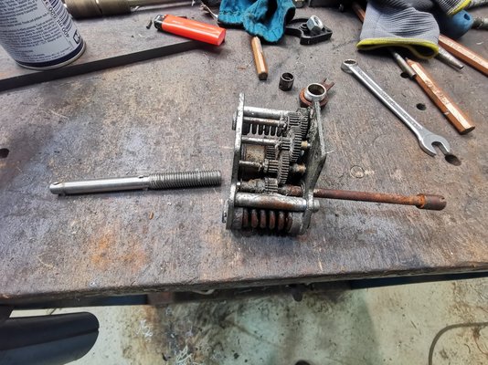

I remembered and found in the pile of “metal just in case” the remains of such a device. I removed the extra gears. When the long rusty bolt is rotated, the thick central bushing made of brass pushes the 10 mm stainless steel rod 50 mm back and forth. The bushing has thrust roller bearings (!) and an internal thread M12*1.75. I'll try to make an analogue of micrometric feed. By tilting the angle grinder up to 45 degrees, I change the distance from the abrasive disc to the part. One turn of the screw gives 0.5 mm of extension of the rod. Work for TIG. PS - I made a little mistake with the posting thread.I made a machine/jig for a hell of a job to sand deep and even grooves.
A cross vice handles the X and Y coordinates; for the Z coordinate, I will sequentially place plates under the clamp with the part.
As we increase the height of the floor with the part, we cut deeper.
Anything you can think of to avoid buying a milling machine, oh yes.

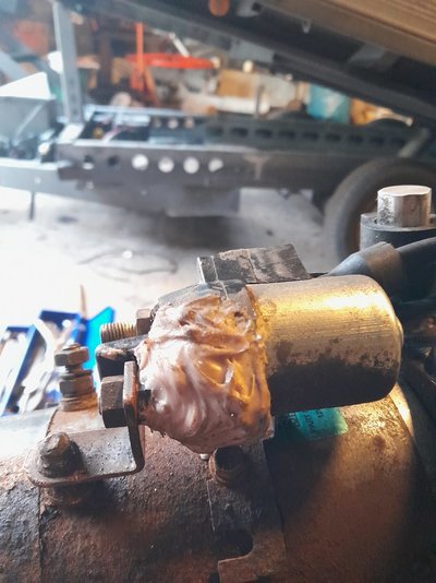

£550 for a solenoid i hope thats a mistakeMy tipping trailer wouldn't tip.
Turns out the solenoid had broken through the housing. Called the Norwegian dealer for a new one,£550!
Ordered one from ebay and bodged the housing with to courses of epoxy,some plastic and a mig wire hoop.
Will hopefully last until the new one arrives.
View attachment 425011 View attachment 425012 View attachment 425013
No its not I am afraid.£550 for a solenoid i hope thats a mistake

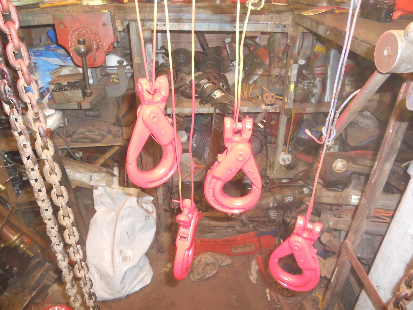

do you do all your won plating? looks really goodContinued.
