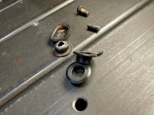

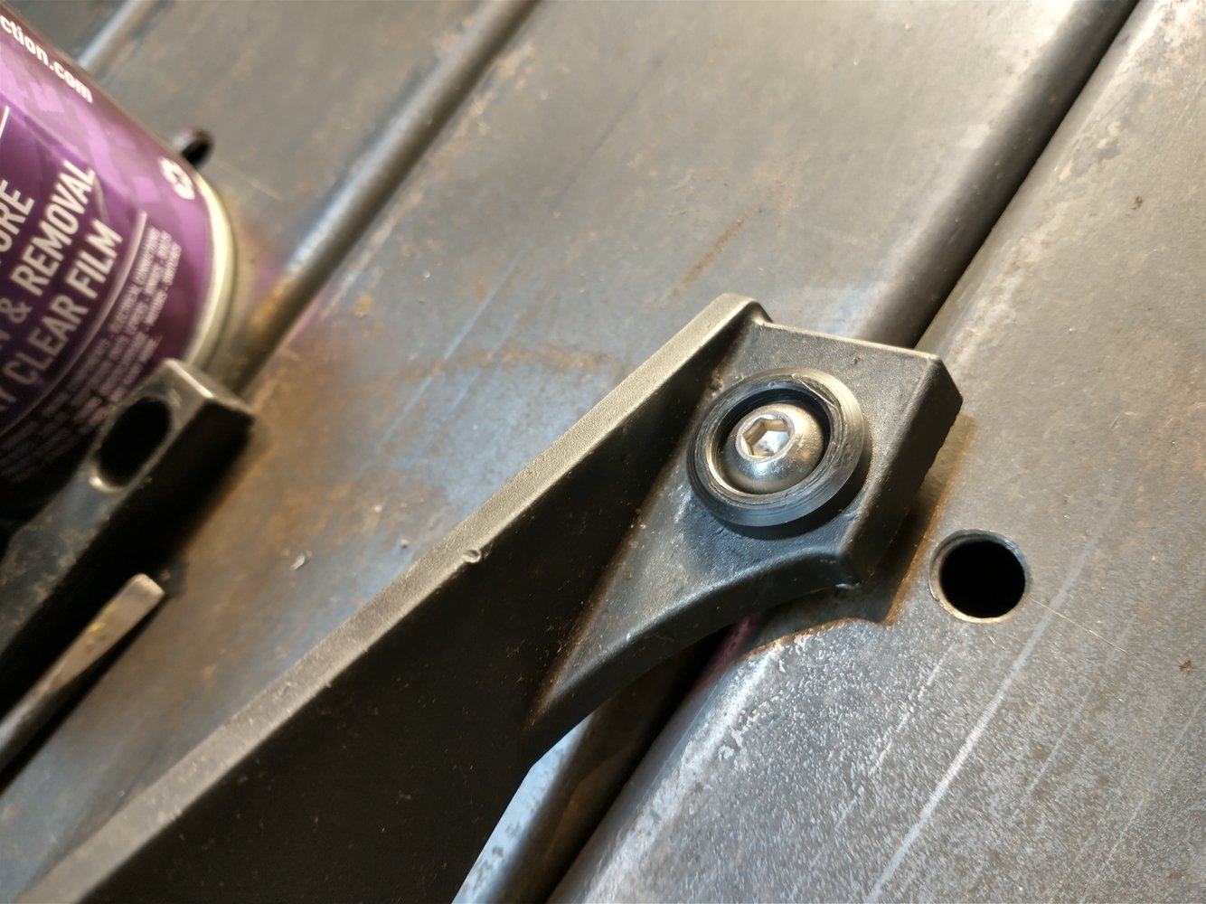

Mine did the same - I might have been slightly more gentle on the squeezing back of the crimp though I drilled and pinned it too. I see you already have the bigger washers over the rubber mounting bushes to stop it twisting away from the screen - took me a while to work out why my drivers side wiper didn't wipe the centre 6" of the blade - whole mech had tipped away from the screen and the arm had bottomed out on it's downward travel, so no actual spring pressure to hold the blade on the screen.Today I fixed the wipers on my Alfa 159.
