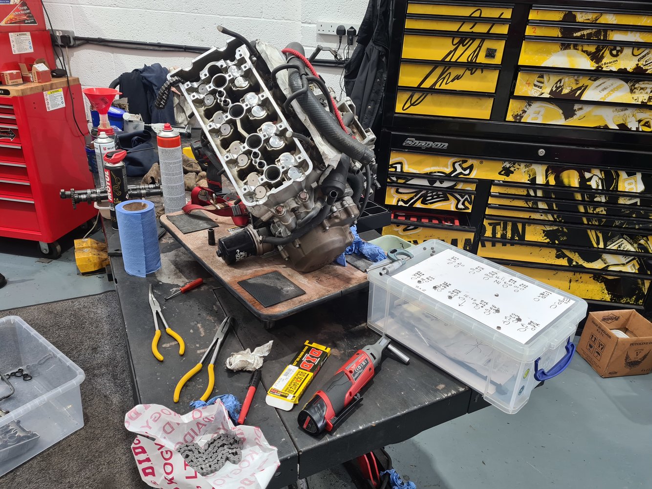

Kawasaki ZX6R valve clearances this morning (and a new camchain that's took weeks to arrive).
A lot easier when the customer brings just the engine in!.

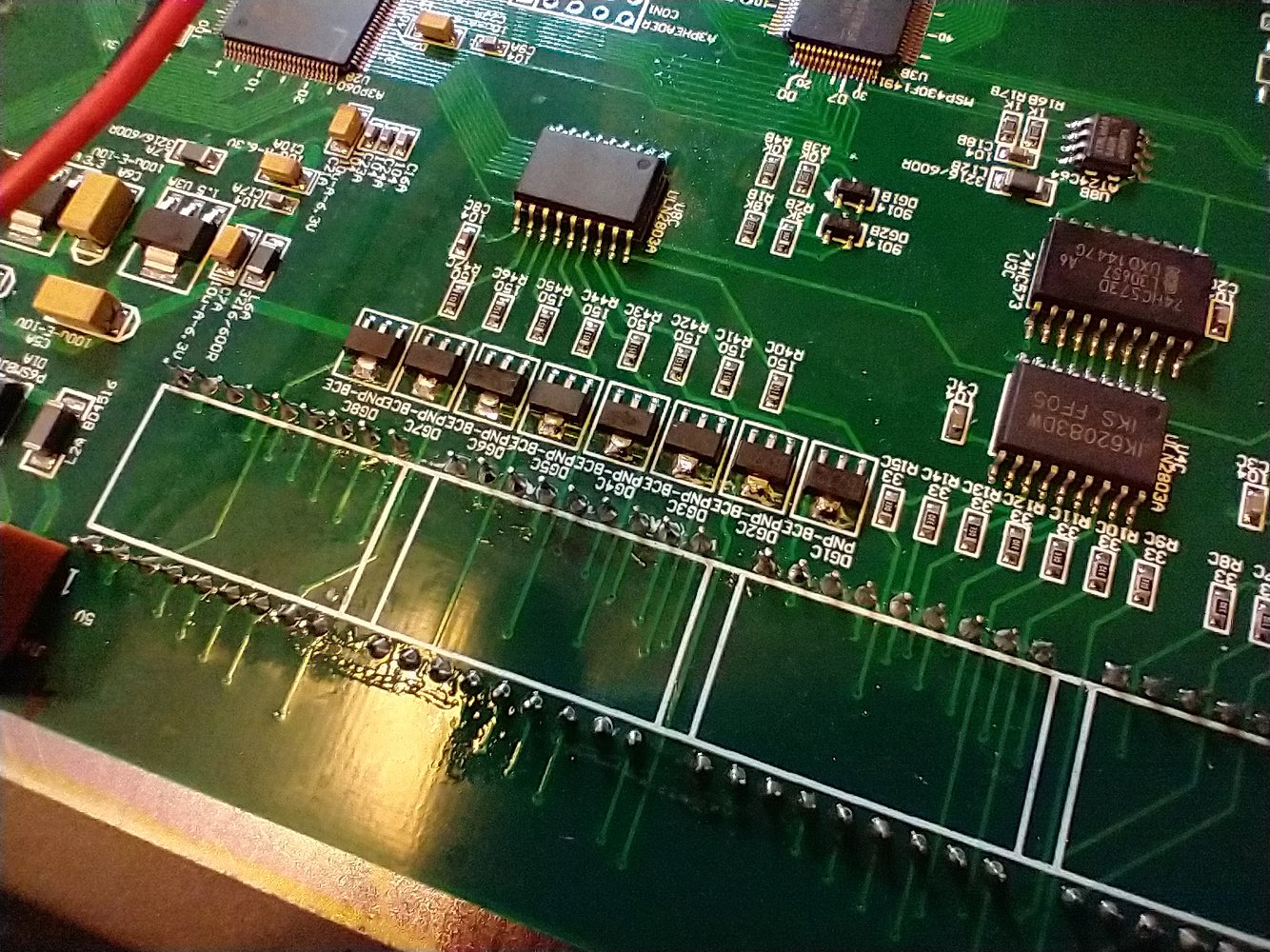

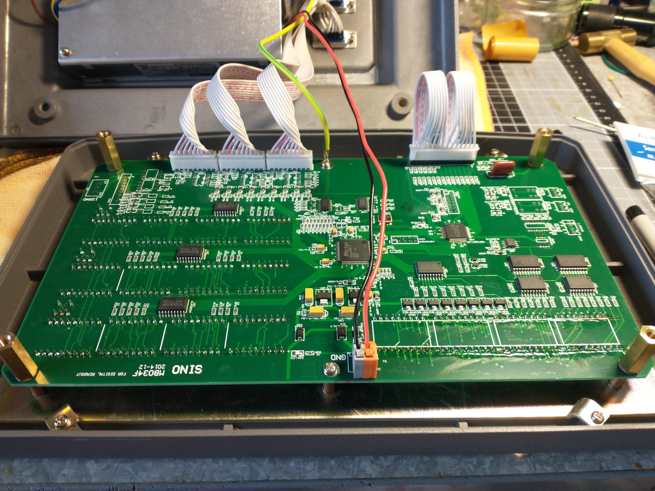

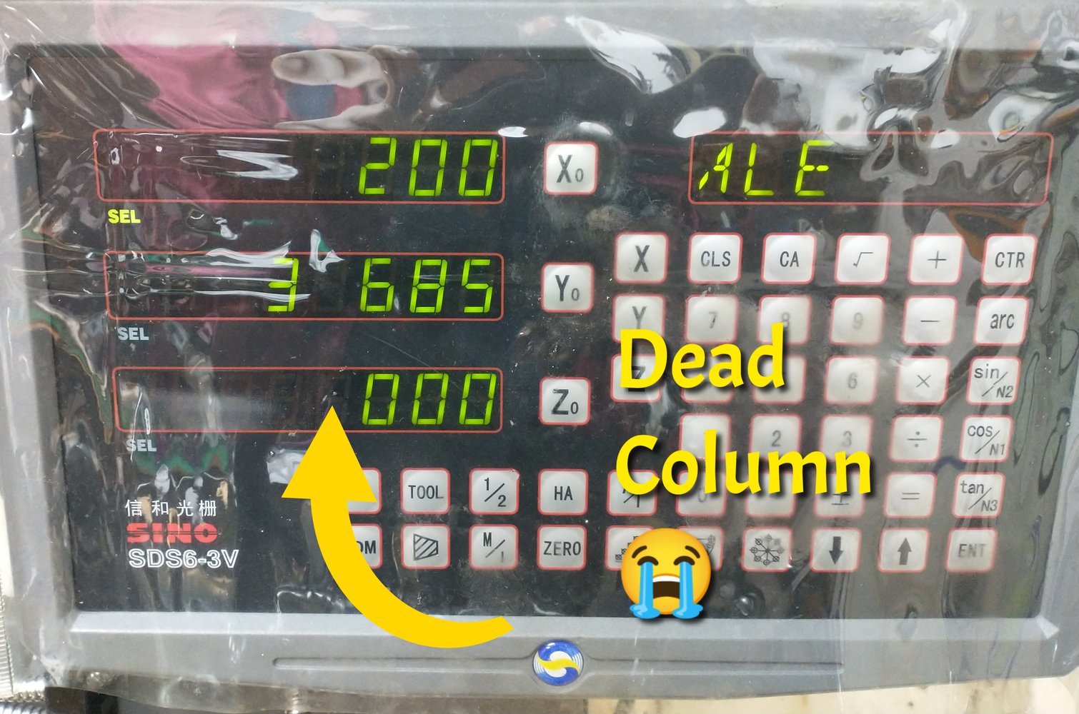

The Sino SDS6-3V DRO on my lathe has had an intermittent fault where it would lose a column of digits. Yesterday it turned into a continuous fault so it was time to have a look at it.
I managed to find a data sheet for the dual 7 Segment display modules. They used pin 13 and 14 for the common pin on each side.
Got the scope out and found the signal on the dead column (pin 14) to be a distorted version of the signal on all the ithe columns.
Looking at the board I wasn't sure where to go.
Eventually I figured out the three big chips on the left (Darlington transistor drivers) were handling the segments for x,y,z and there where a bunch more on the right which were for the alphanumeric display on the right. So what was handling the columns?
I eventually noticed this row of transistors and probed the tabs (output) and found the column signal. Transistor 4 had the same dodgy signal I had found before
Signal on the base matched the others.
So after a bit of hard probing
The column started working again - it was a dodgy dry joint!
I've reflowed all of the transistors and now it's working fine.
Really pleased as it's saved me at least 150 quids, and very much at the limit of what I could achieve with no schematic.
