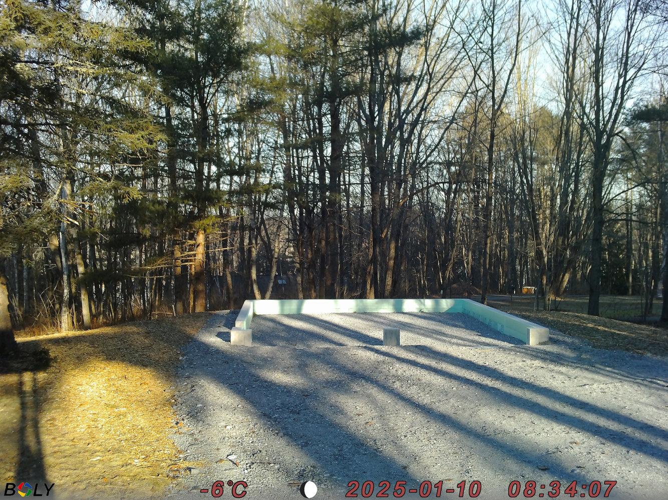

Nice, what is it a sort of prefab type building?I think this is sorta, kinda appropriate for this thread. After I fixed the concrete foundation for our new garage (see previous post: https://www.mig-welding.co.uk/forum/threads/stuff-you-have-fixed-today.100753/post-2532025), the garage builders came last Friday and erected the garage, which fit the foundation perfectly after I had made the necessary cuts in the concrete.
Here's what the site looked like on Friday morning at 8:34 am (picture from trail camera):

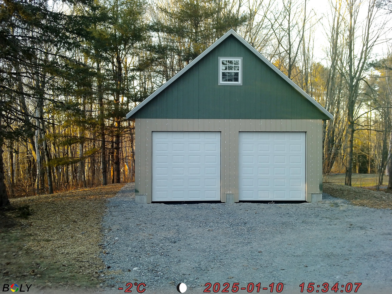

And here's the same site, same day, seven hours later, at 3:34 pm, just after the builders left. For scale, the garage is 24 feet wide by 26 feet deep,, the doors are 9 feet high, and the main floor ceiling height will be just over 11 feet after the floor is poured.
There is still more work to be done when the weather warms up:
- Pour concrete slab floor when weather permits (reinforced to allow future installation of two-post car lift).
- Install trim moulding on lower part of garage around corners, doors, and windows.
- Paint lower part of garage when weather permits (same green as gable, with gray trim).
- Install stairway to attic storage area.
- Finish grading and paving driveway.
- Install electric service and wiring.
I think the builder did a good job. It's well built, with 2x6 on 16" center construction, with four double-glazed windows, an insulated side door with 9-lite window, full-length soffit and ridge vents, high-tech weather resistant siding and roof sheathing, etc., etc. The builder will complete the garage finish work when we have some warmer weather, except for the concrete and I'll leave the concrete floor to an expert, since it has to be poured and finished very accurately to match up with the doors and the stairway to the attic area. I will probably do the wiring myself, as well as the post lift installation.

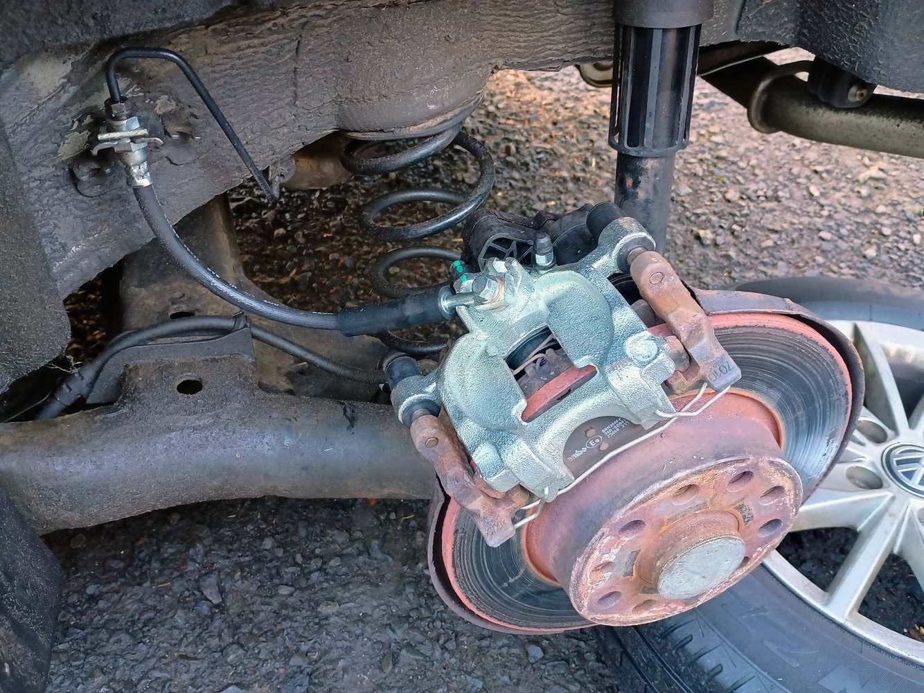

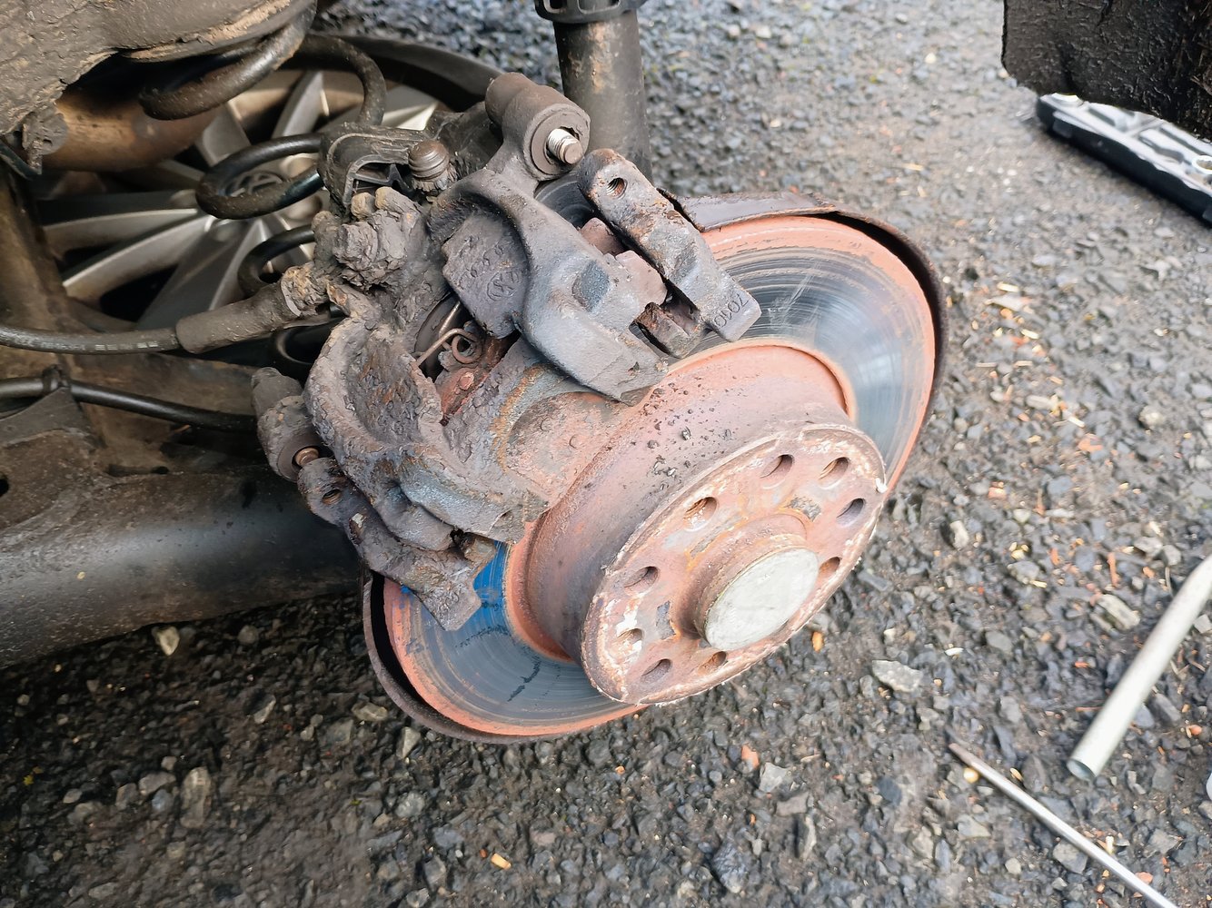

I cant believe how this modern stuff seems to rust, looks like it all needs a good pressure wash when it warms up!E-brake calliper, what a stupid idea. That's the second one I've now had to replace on my golf.
The walls, gables, and roof trusses were constructed in a shop, and these large components were then assembled on site. The roof sheathing, underlayment, drip edge, shingles, ridge vent, doors, attic floor, etc., were installed in the usual manner. There really isn't any difference between this and a totally site-built approach, except that these sections are probably more accurate. Because the sections were pre-built, the foundation had to be poured exactly to spec, so that there wouldn't be any surprises when they assembled the pieces. It worked out fine; the sections fit just right and didn't require any trimming or shimming, which helped it go up faster.Nice, what is it a sort of prefab type building?
They seize up, with the parking brake on, ours is a Mk7 2015 with 100k miles.What happens to them? We have a golf.
Same as ours. I'll have to keep a check on it.They seize up, with the parking brake on, ours is a Mk7 2015 with 100k miles.
After using vcds to release the parking brake
