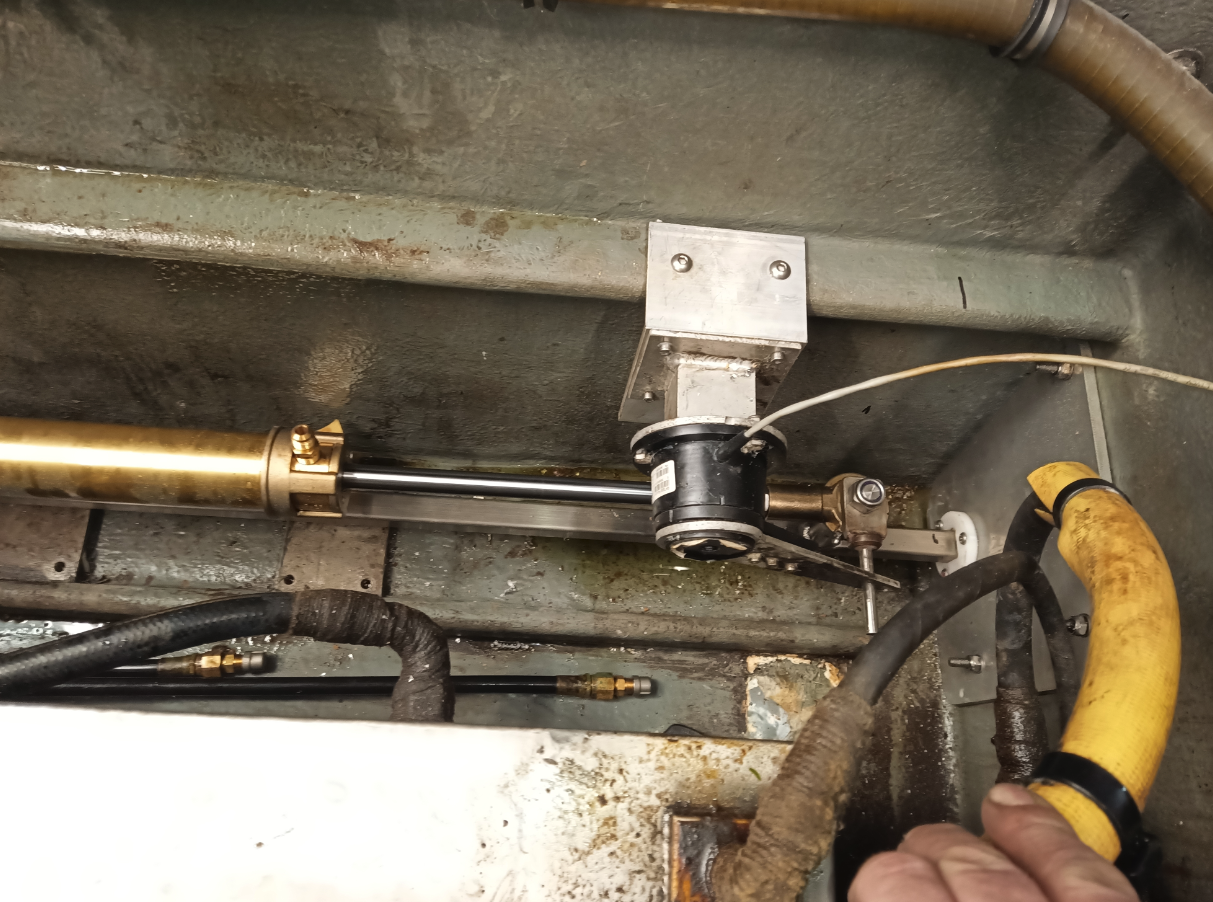

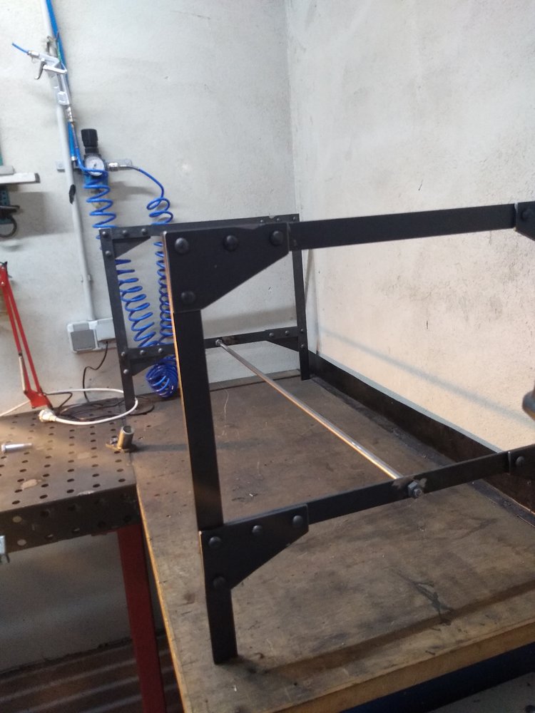

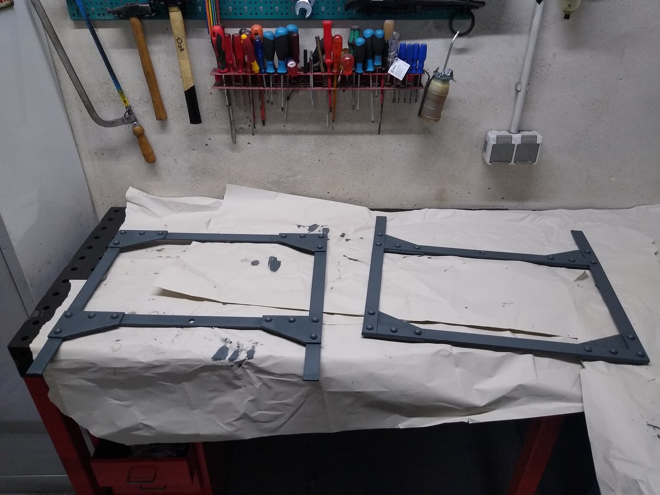

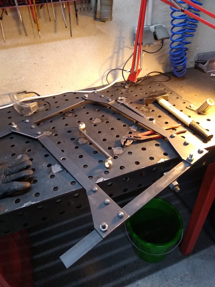

Got the steering finished today, skipper will connect the pipes and bleed himself when the oil arrives.
a few pics.

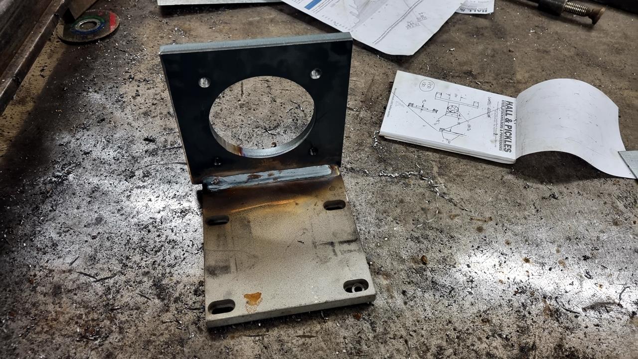

Had to relocate the rudder feedback unit and make up a different pin arrangement for it. The long arm on it is something I made originally as they are meant for short tiller arms on a conventional rudder but as the motion on this is linear I had to make the slotted arm yup t accommodate the 12" linear travel., you can see where it was originally, the glass got pulled up with the silicon when it was removed, another job for the skipper
Good thing was I was able to reuse the short arms and joints on either side, just had to cut them shorter and reweld the ends.
