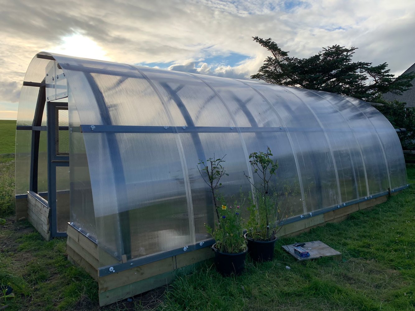

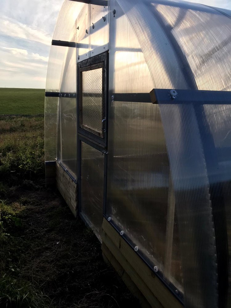

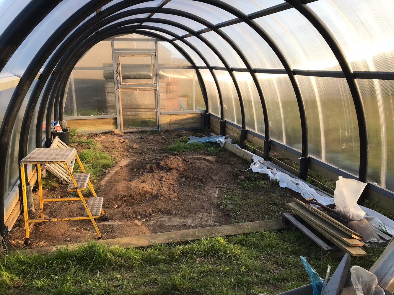

Not today but got to a decent milestone. Just a few finishing bits to the structure then it’s the inside to landscape as per Mrs79 requirements. It’s not minewaiting on a batch of buttons to fix the twinwall properly
Should be a consistent 30ish all year

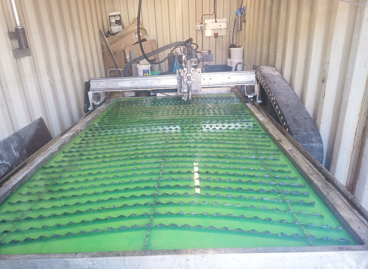

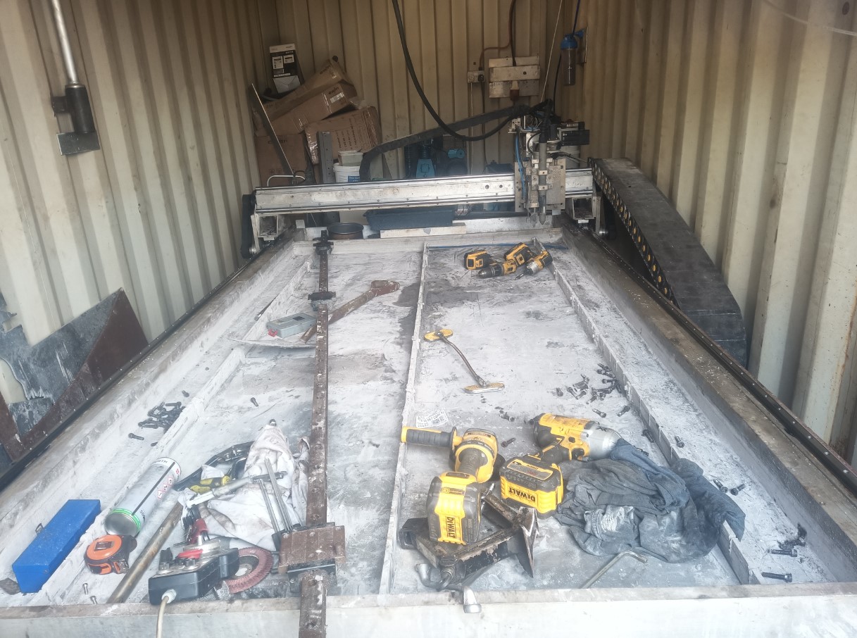

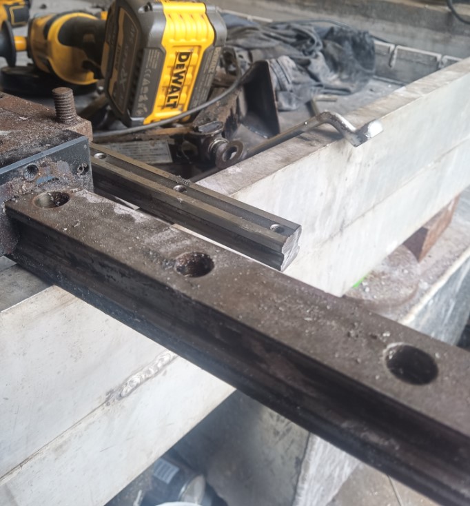

On Wednesday I received the profile rail I bought from @MattH it is tiny in comparison to the rail I previously had but that was way overkill and was only used because it was free.
Yesterday I drained the water table, shovelled out all the gunge and removed the old rails and fitted the new. Had to make 20mm thick spacers for the trucks to keep the height the same but all went well.
Today I got it all finished, had quite a bit of problems with the Y axis motors again, had to retune them but got there in the end. Pumped the water back from the tank and added a bit more Rocol, ready to use on Monday I hope.
Yes, they are about the same size as on the Chiron. They came from an old glass cutting machine and the trucks were knackered but I managed to build 5 half decent out of the 16 I got and found some on US Ebay to get the table up and running. They lasted longer than I thought so can't complain.Crickey, they are overkill for a plasma with no cutting forces.
The carriages on mine seemed nice and tight still, hopefully should last ages.
That looks superbNot today but got to a decent milestone. Just a few finishing bits to the structure then it’s the inside to landscape as per Mrs79 requirements. It’s not minewaiting on a batch of buttons to fix the twinwall properly

Cheers. It’s not what I usually get involved inThat looks superb![]()
Is that pre bent twin wall or flat?Not today but got to a decent milestone. Just a few finishing bits to the structure then it’s the inside to landscape as per Mrs79 requirements. It’s not minewaiting on a batch of buttons to fix the twinwall properly

Flat. And getting it on is an absolute pain in the freckle.Is that pre bent twin wall or flat?
my folks have a 15 meter one, luckily i was away the day they put the sheets on!!Flat. And getting it on is an absolute pain in the freckle.
My mate who helped commented it must be married - looks good but getting it to bend over is hard work. Well that’s the slightly better version anyway. Made me laugh![]()
That’s an 8m one. That was enough.my folks have a 15 meter one, luckily i was away the day they put the sheets on!!
didnt sound like fun!
Nice. Is that your own design, or a kit?Not today but got to a decent milestone. Just a few finishing bits to the structure then it’s the inside to landscape as per Mrs79 requirements. It’s not minewaiting on a batch of buttons to fix the twinwall properly
