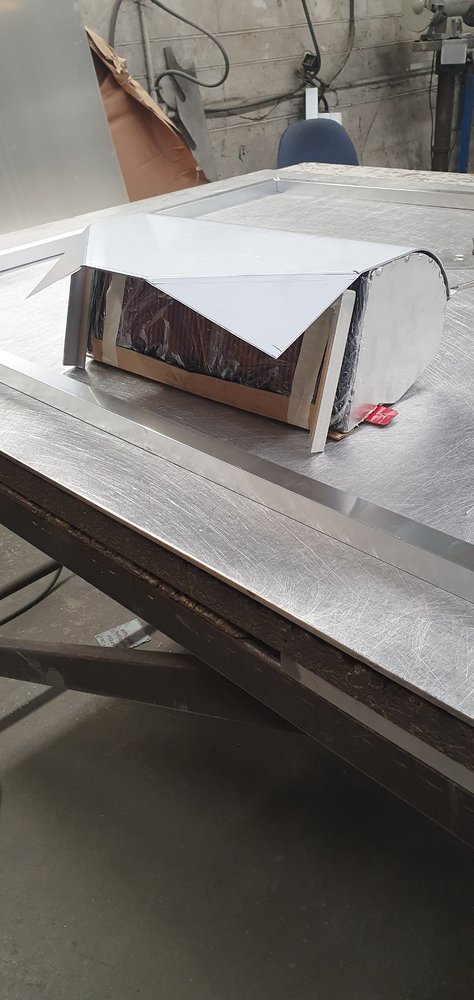

So, does the salt water not bother the aluminium? Also on this pic, what is the hull made of and how is the aluminium attached to it where it wraps over the side?This is what they look like after a bit of use, this is one of his sons boat that I did about 2 years ago, maybe more.
All the sheet is 5083 marine grade aluminium and sections are 6082 so still a high magnesium content so as long as there is no steel attached to it then it just gets its oxide coating and stays that dull grey colour, the gunwale cappings are fixed with stainless screws/bolts. Hull is GRP.So, does the salt water not bother the aluminium? Also on this pic, what is the hull made of and how is the aluminium attached to it where it wraps over the side?

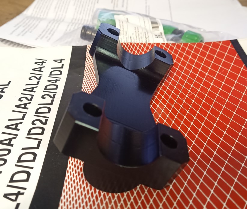

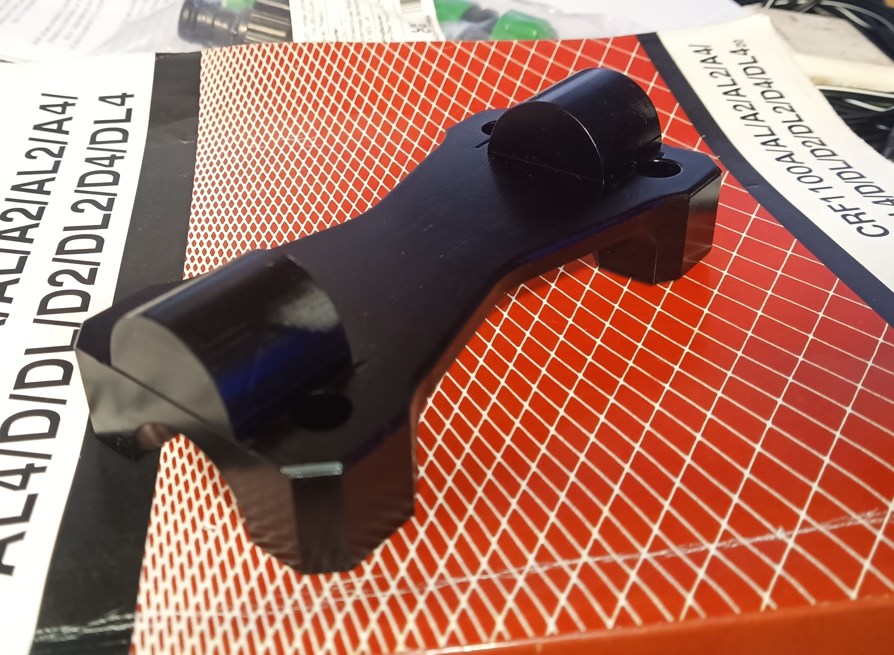

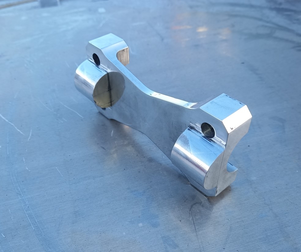

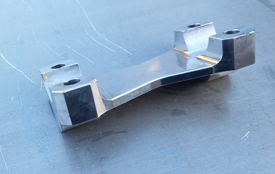

Its a Tryax bed mill with centroid CNC control, its about the same size as a XYZ DPM. Using 20mm and 32mm indexable end mills with general purpose insertsWhat mill? What cutter?
Nice job.
