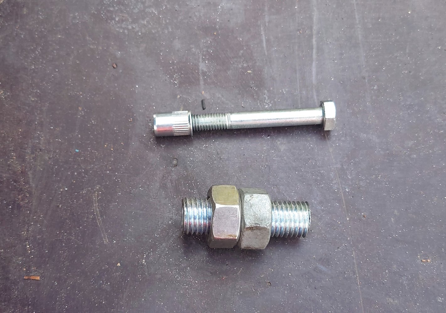

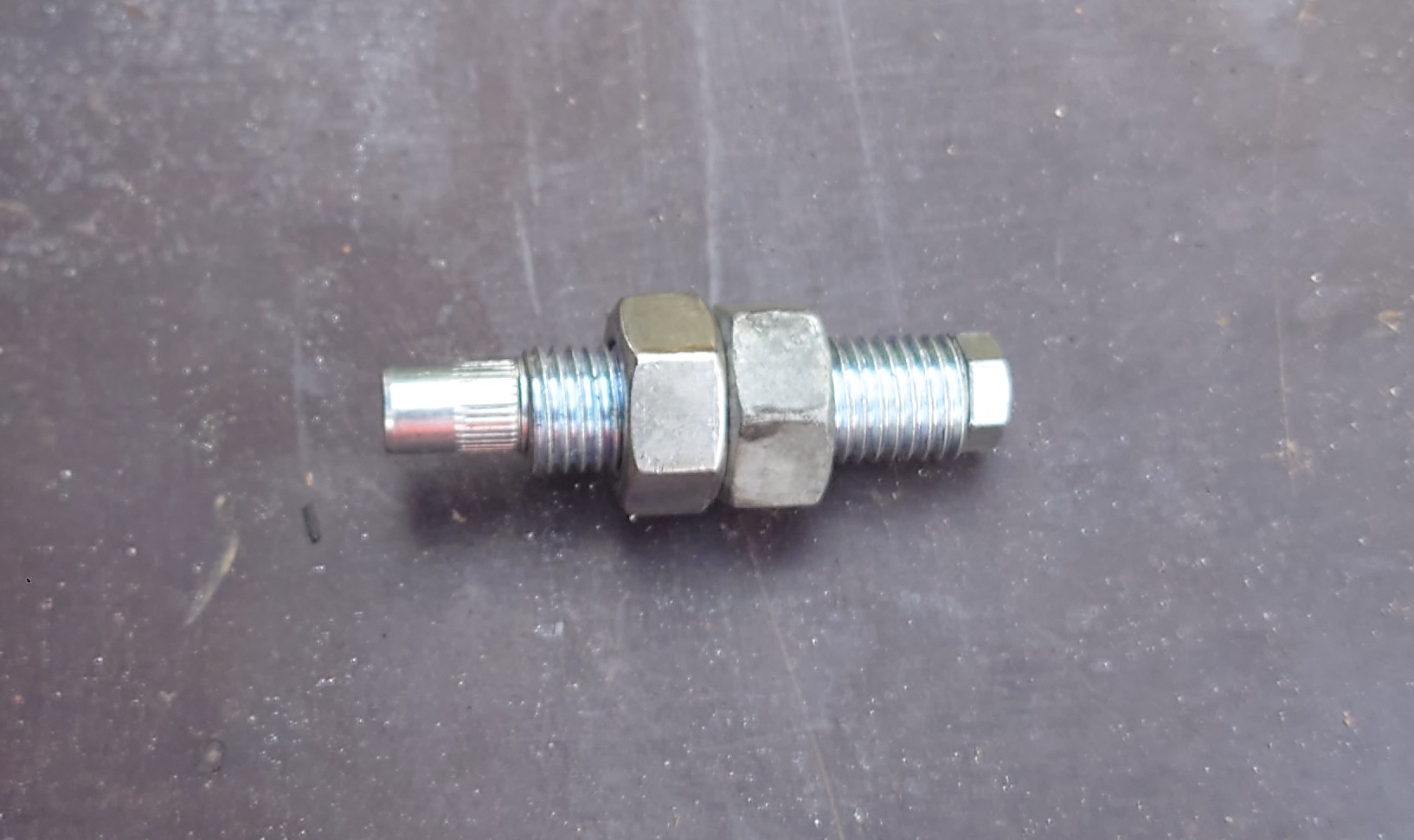

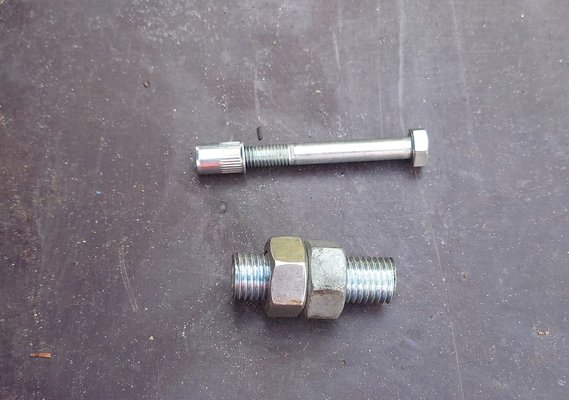

When I needed to do this with some 3/16" UNF rivet nuts, I did something a lot more rough and ready - a high tensile bolt (not sure if it needed to be), a nut and washer, then the rivet nut, into the panel and a washer and bolt on the other side. Tightening the nuts towards each other was sufficient. Of course, that was a much smaller rivet nut so easier to collapse, and I had access to the back. I was putting them in a door skin because I wasn't about to stick self-tappers (the "correct" fixings) through my new paint. I'll keep this in mind though if I need to do bigger stuff.Today I made a rivet nut setting tool.
I needed to replace a 8mm rivet nut but don't have a setting tool or have much call for one so, I made a quick, simple tool to set it.
Bit of M16 thread bar with a 8.5 hole drilled through it on the lathe and locked two nuts on it.
I've done similar - mainly because the die-cast rivet style tool I had for aluminium rivnuts would have simply snapped trying to pull up steel or stainless steel ones.When I needed to do this with some 3/16" UNF rivet nuts, I did something a lot more rough and ready - a high tensile bolt (not sure if it needed to be), a nut and washer, then the rivet nut, into the panel and a washer and bolt on the other side. Tightening the nuts towards each other was sufficient. Of course, that was a much smaller rivet nut so easier to collapse, and I had access to the back. I was putting them in a door skin because I wasn't about to stick self-tappers (the "correct" fixings) through my new paint. I'll keep this in mind though if I need to do bigger stuff.
