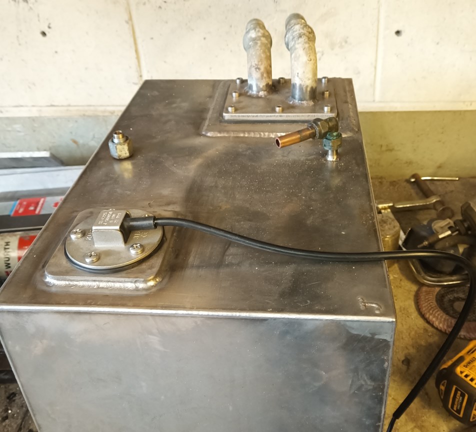

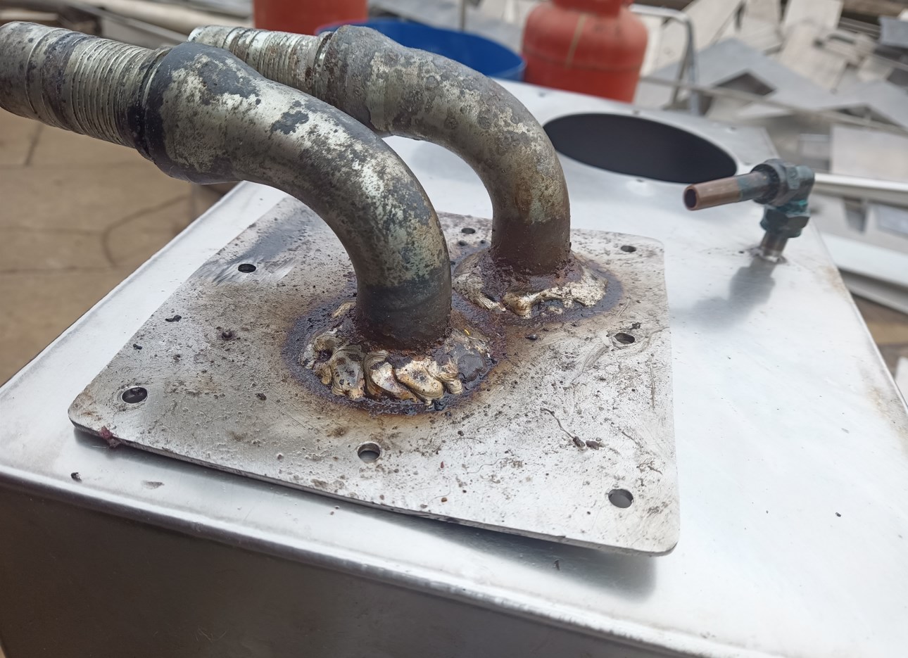

Repurposed the original header tank as the original engine was keel cooled into the new hydraulic tank. It was there why not use it
For cooling the hydraulics when it is running I used the sew water after it has cooled the main engine and gearbox oil to cool the hydraulic oil and them discharge overboard, 'simples'. The discharge pipe work is PPR Aquatherm from Germany. It is very tough, doesn't break and doesn't corrode.
