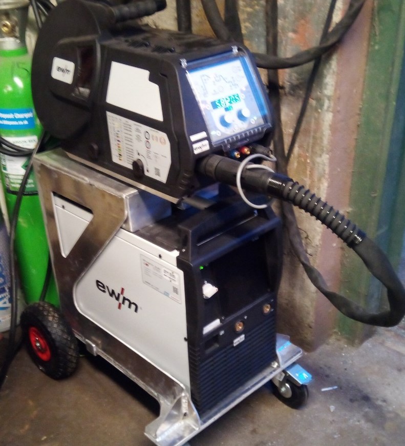

Yellow Poly Prop hard foams wheels don't puncture or deflate over a few months . I changed all my 8 pneumatics over to them about four years ago once they became eBay cheap & available ..but I did have to put all new bearing in them as the crap they were fitted with was rather crunchy at 50 kg loadings .Got some gas today and wheeling it round to the workshop from the van it felt strange.
OOPS
I had a spare sheet of 5mm alu from a cancelled job so quick design in fusion then onto the plasma with the sheet and cut some bits.
Hauled out the mig and tacked it up.
Fully welded
Popped to B&Q for some wheels, made a stainless axle and tested it out, perfectAlso the pneumatic tyres don't play havoc with the finger joints as I pull the cylinder over the cobbles, last wheels were solid and it was bloody sore on the joints. Just need to get a wee bit chain now.

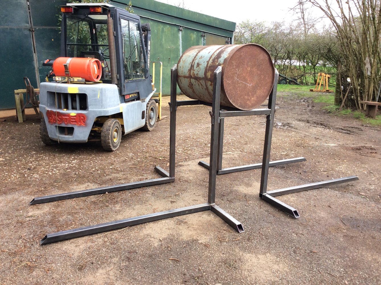

Cool! For practising on or do you leap on your horse from it?A mounting/vaulting stand for a stunt and display rider.View attachment 392121

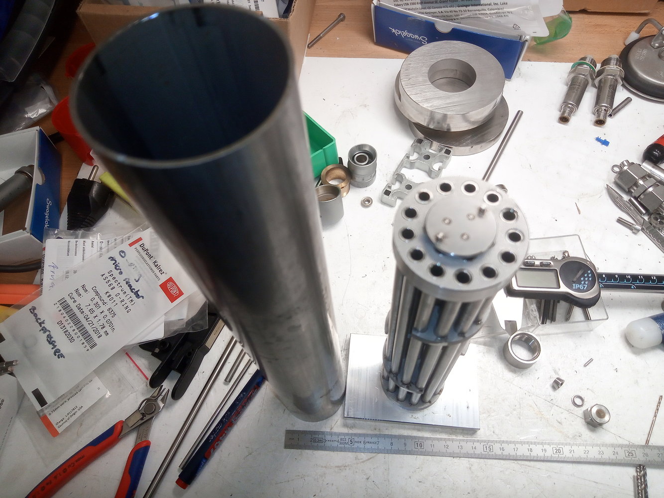

That's so cool! Is it just going to be single pass? Did you do any flow calcs? What's it going to cool?View attachment 392284Not finished yet but once it is there will be not much to see.
A cooler, modelled in Inventor, waterjet cut, drilled and tacked with laserwelder. Next week assembly and tig, nice to have a compact sollitaire work process every now and then.
21 parallel tubes in a single pass, the phd who's set up it will be did the calculations, can't tell what gas it is going to cool, sorry.That's so cool! Is it just going to be single pass? Did you do any flow calcs? What's it going to cool?
