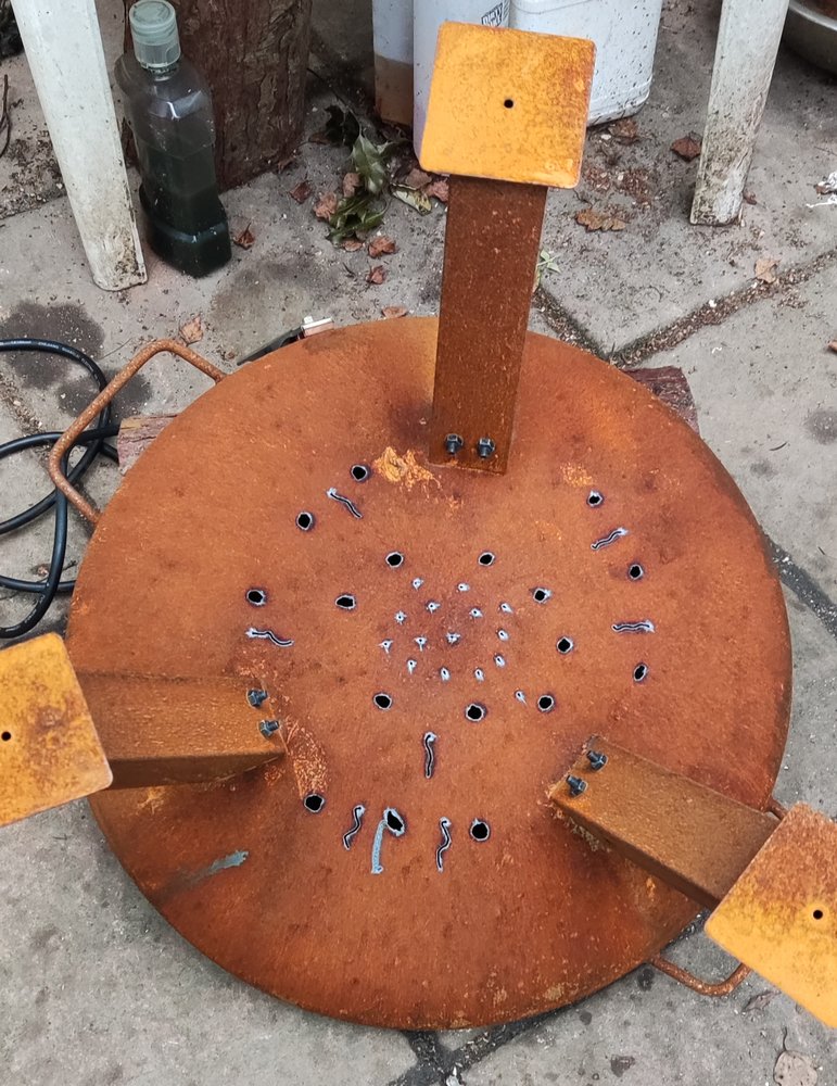

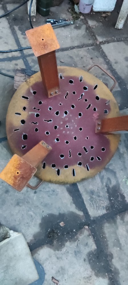

Air holes enlarged. I wont be winning any awards for neatness! The torch did not like dragging on the rough rusty surface. Wont try it tonight as it may annoy people if I use it too often.with firepit and plasma, it was going to need some air holes, and it seems I will need to add more and probably bigger.

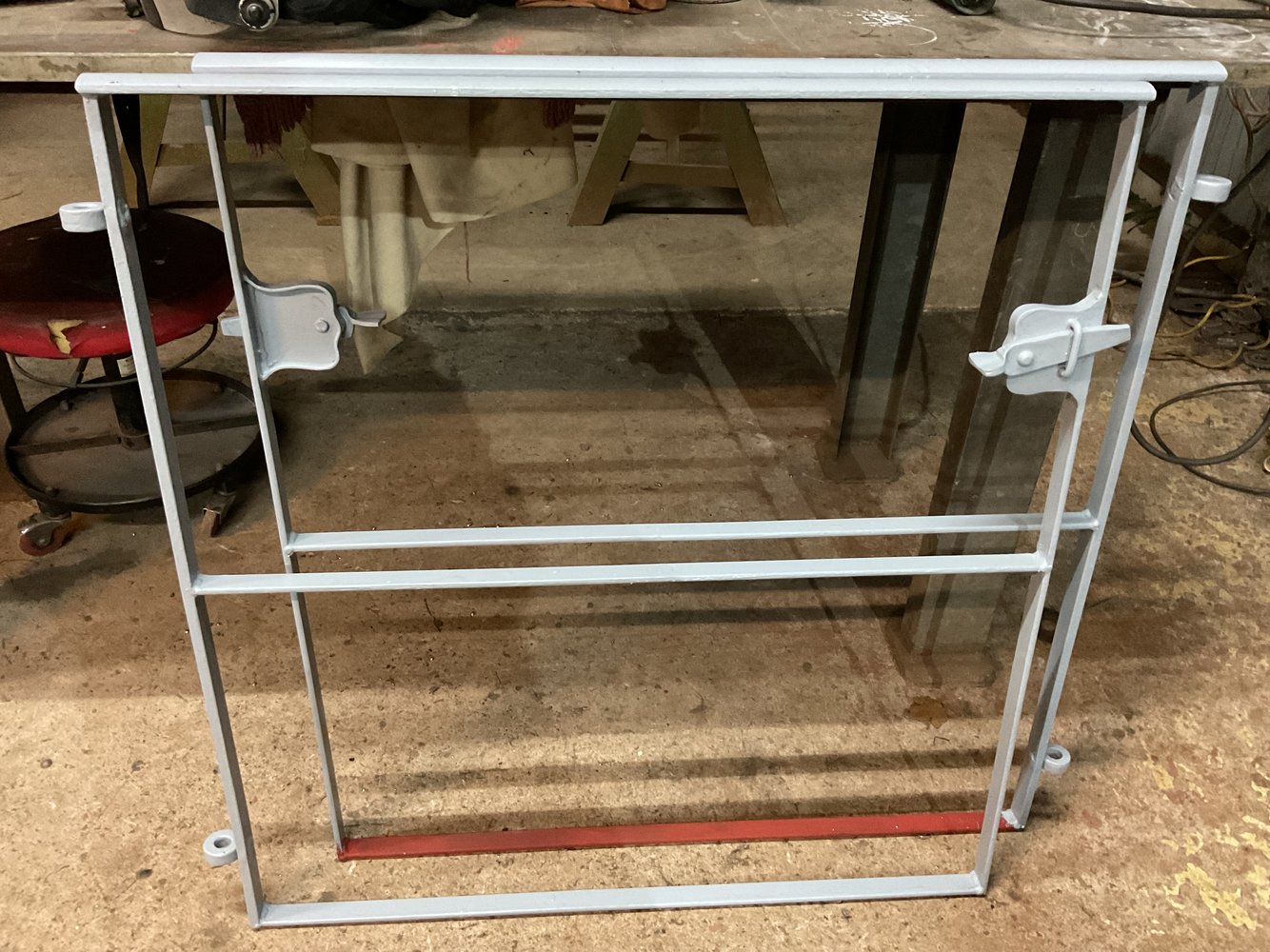

That looks good he should be well chuffed with that!Repaired a set of steps for a friends tractor, I was going to patch them up, but decided it was quicker to just renew the side rails, he probably got more than he though he was going to get, I believe replacements are available £845 per each!!
The steps also hold up the diesel tank, they were tied up with a rope, there was not much left to get sizes at the lower end, its pretty close to what it was.
Photography is not my thing either as you will see by the poor photos!! please excuse the untidy bench!!

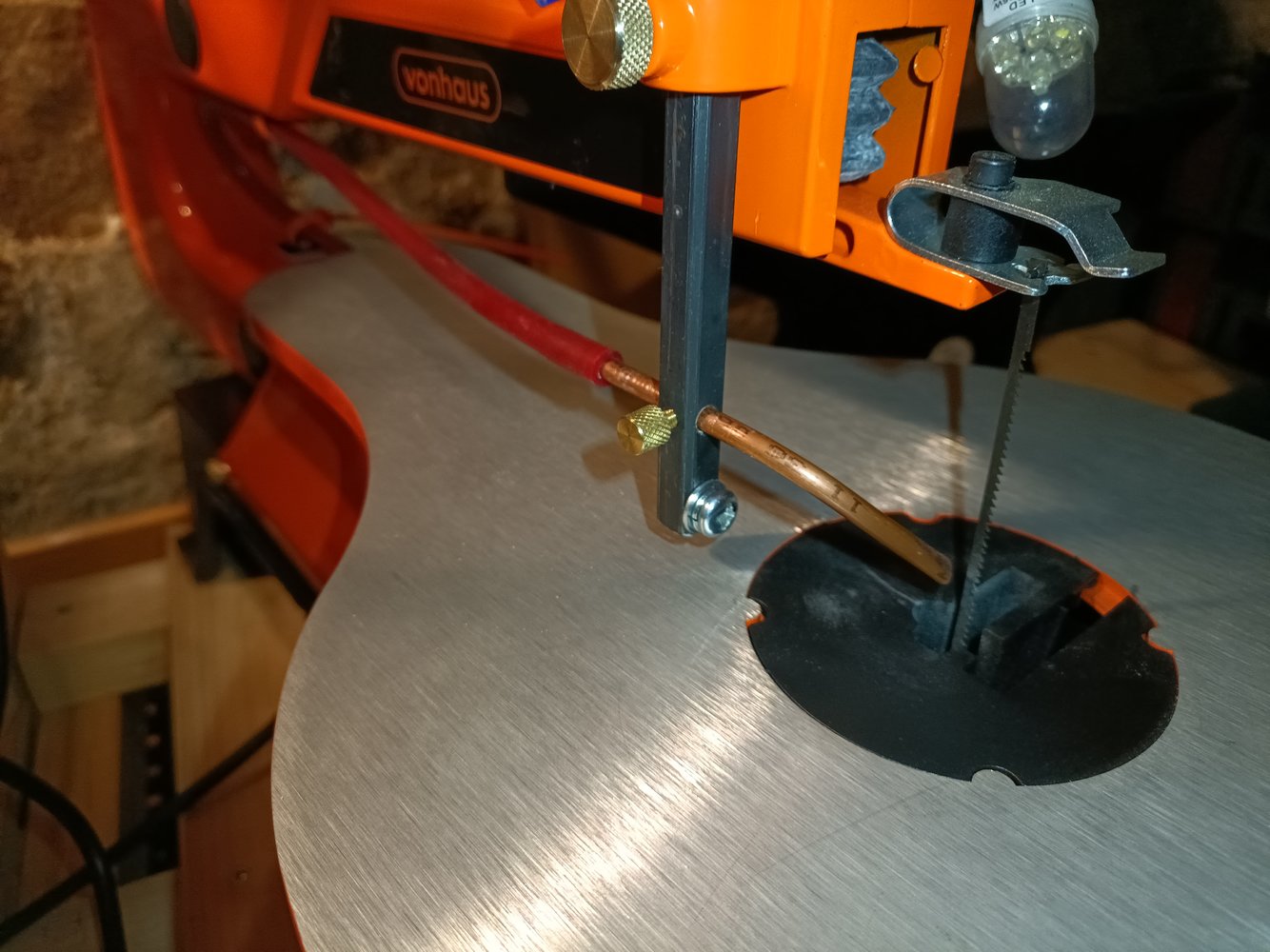

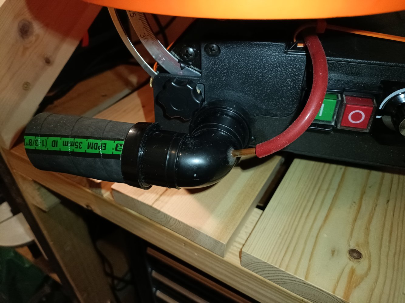

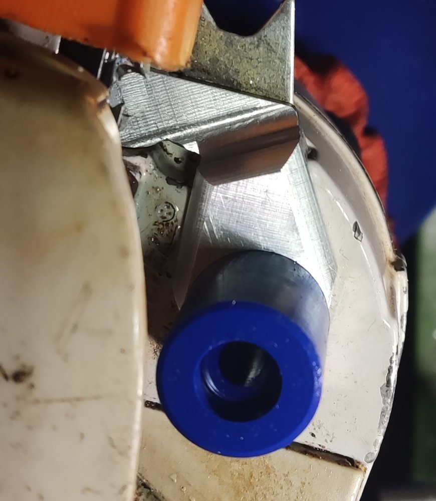

Lovely idea I wish I'd have thought of that for my ancient scroll saw before spending £22 inc pipes & tubes on a double element fish tank pump as the blower.Altered/modified the scroll saw. Realised when using it earlier that I don't want to be blowing the dust, so added a piece of copper brake pipe to the 90° adapter I fitted to the extraction outlet, & ran a pipe to the blower, so now it's sucking rather than blowing. Surprisingly, it actually appears to work reasonably well.
