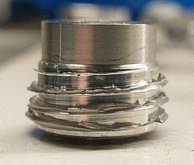

A router guide for cutting binding channels on an acoustic guitar. (The 'bindings' are the decorative strips around the edges of the top/back of a guitar body if you didn't know. A normal bearing guided bit doesn't work well because the angle of the edge isn't 90 degrees, and it varies as you move around the edge of the guitar body.)
Design & CAM in Fusion360
![](https://www.misterg.org.uk/photo/images/2023/12/21/CAM.md.png)

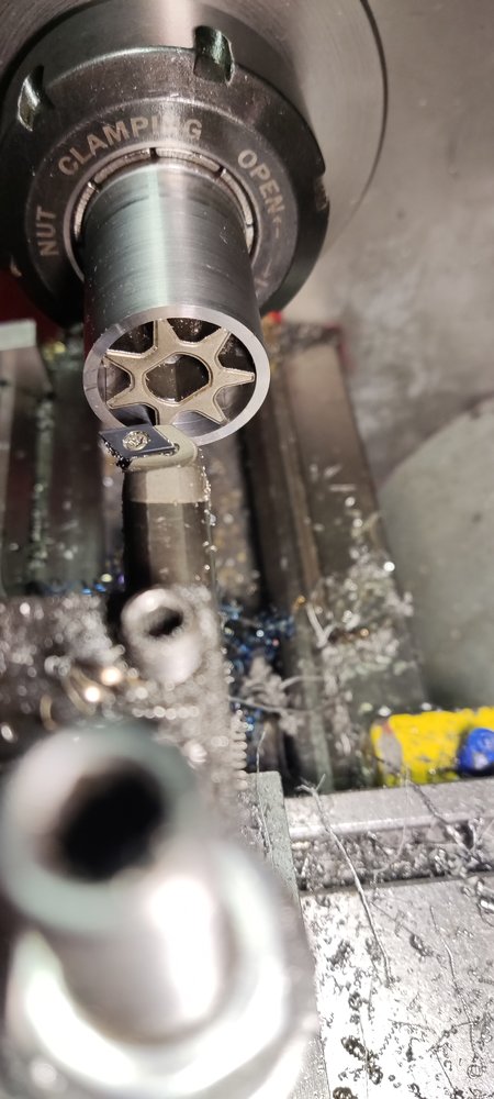

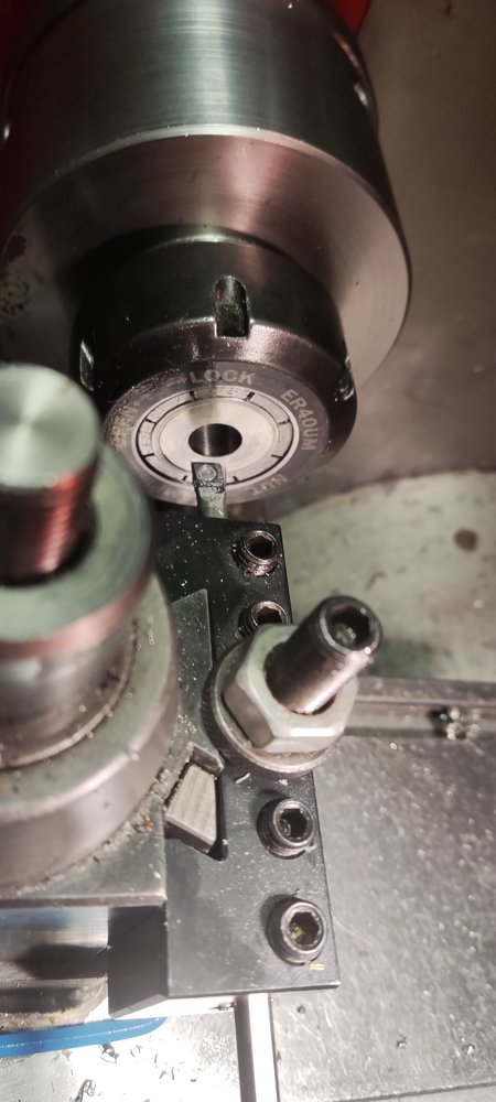

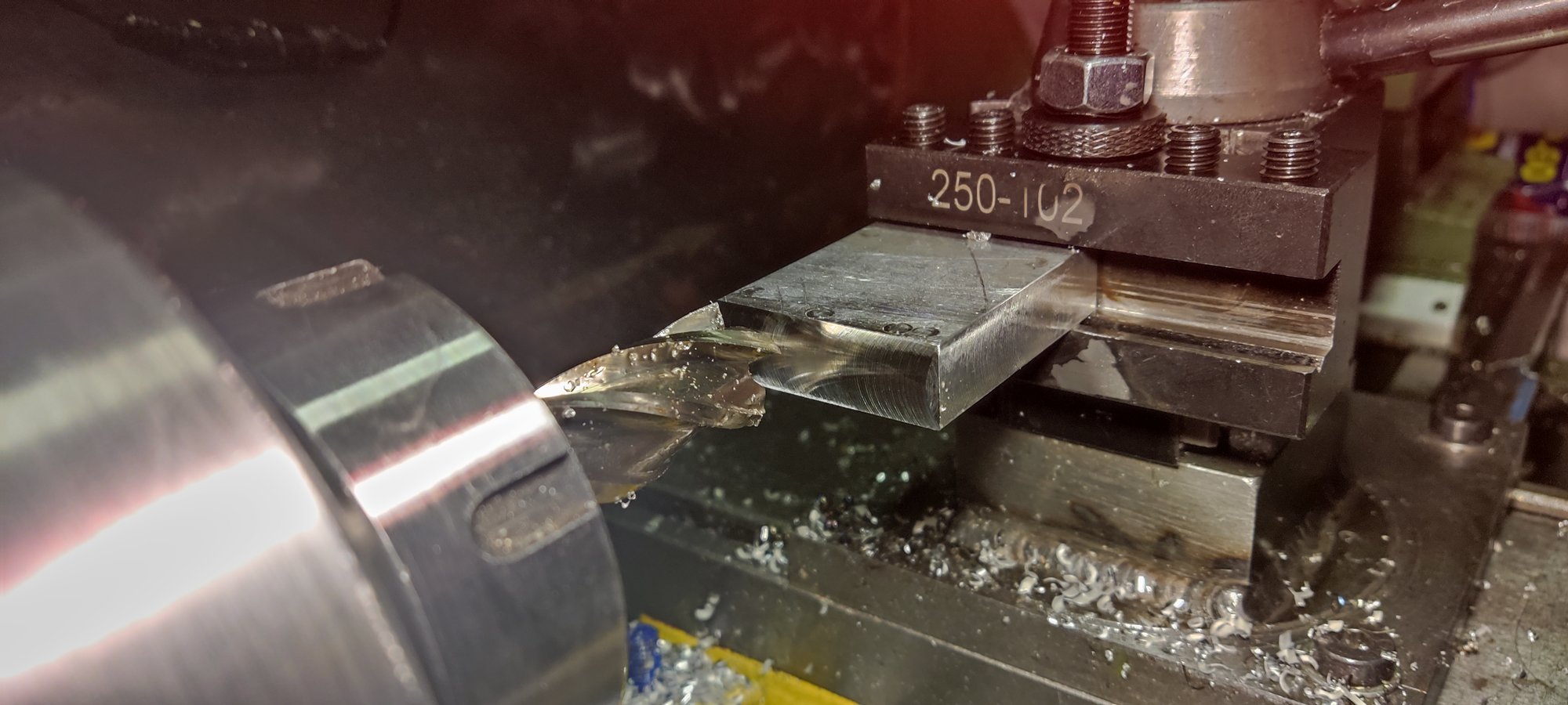

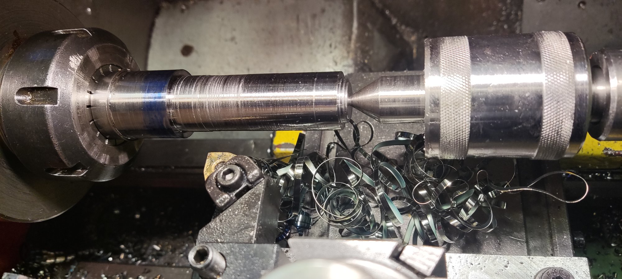

Mostly cut out in several setups on my homemade CNC with the top of the base and the steel shaft done on the mini lathe:
![](https://www.misterg.org.uk/photo/images/2023/12/21/IMG_6367.md.jpg)
![](https://www.misterg.org.uk/photo/images/2023/12/21/IMG_6368.md.jpg)
![](https://www.misterg.org.uk/photo/images/2023/12/21/IMG_6373.md.jpg)
![](https://www.misterg.org.uk/photo/images/2023/12/21/IMG_6375.md.jpg)
A bit of anodising, trying out my yellow dye:
![](https://www.misterg.org.uk/photo/images/2023/12/21/RX108168.md.jpg)
Some assembly:
![](https://www.misterg.org.uk/photo/images/2023/12/21/RX108169.md.jpg)
In place on the router:
![](https://www.misterg.org.uk/photo/images/2023/12/21/RX108178.md.jpg)
Need to pluck up courage to attack this with it next![surprised :o :o](/forum/styles/smilies/speechless.gif)
![](https://www.misterg.org.uk/photo/images/2023/11/26/RX108003.md.jpg)
