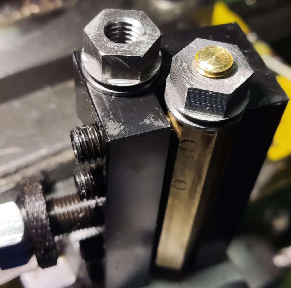

If there is enough to grip I could hex a few for you.

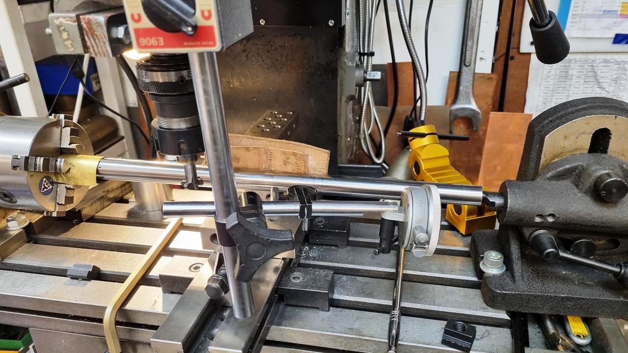

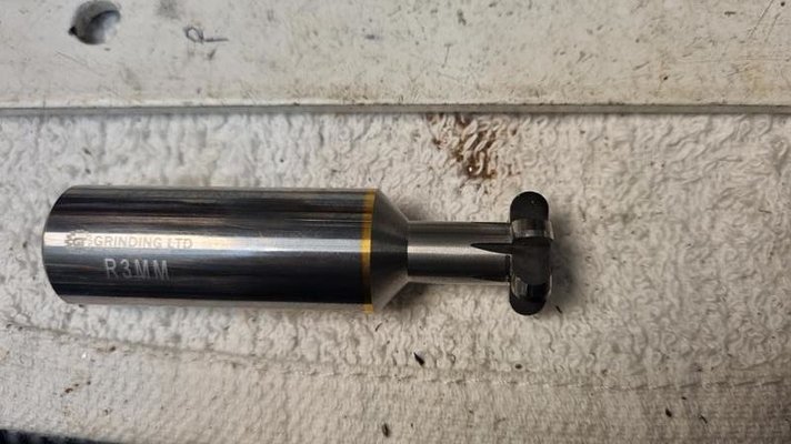

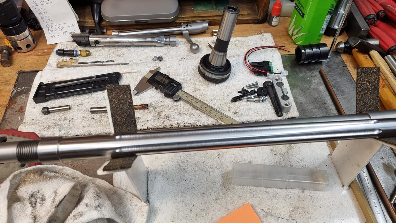

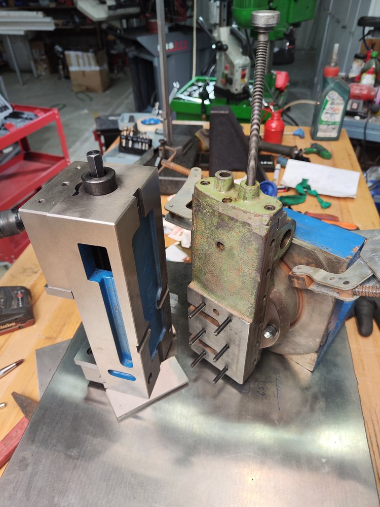

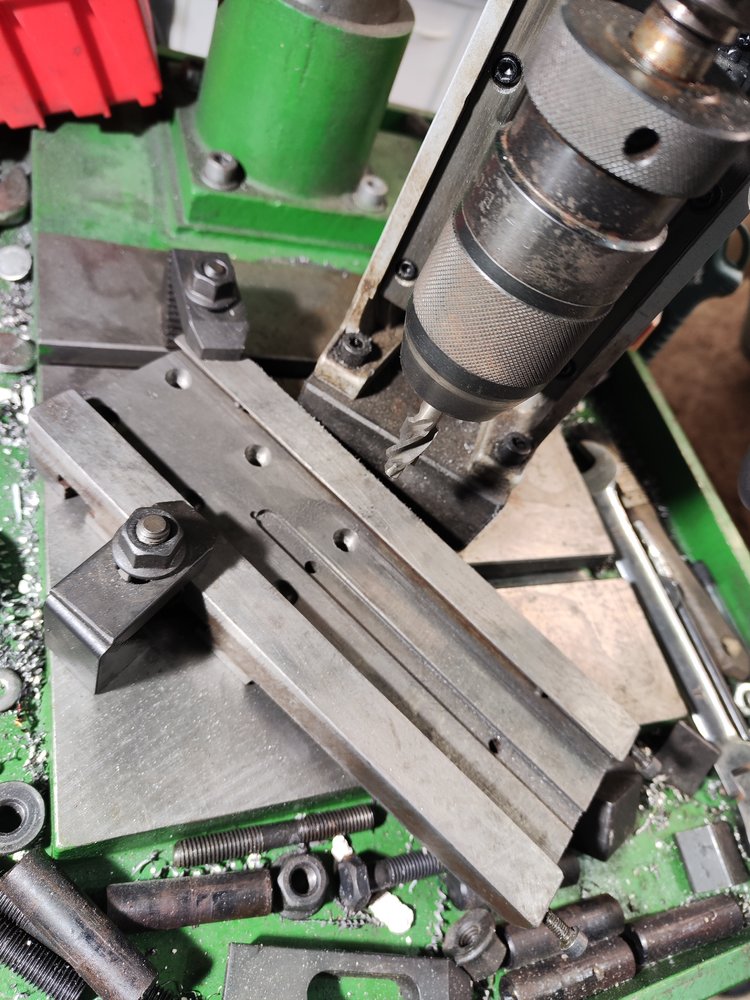

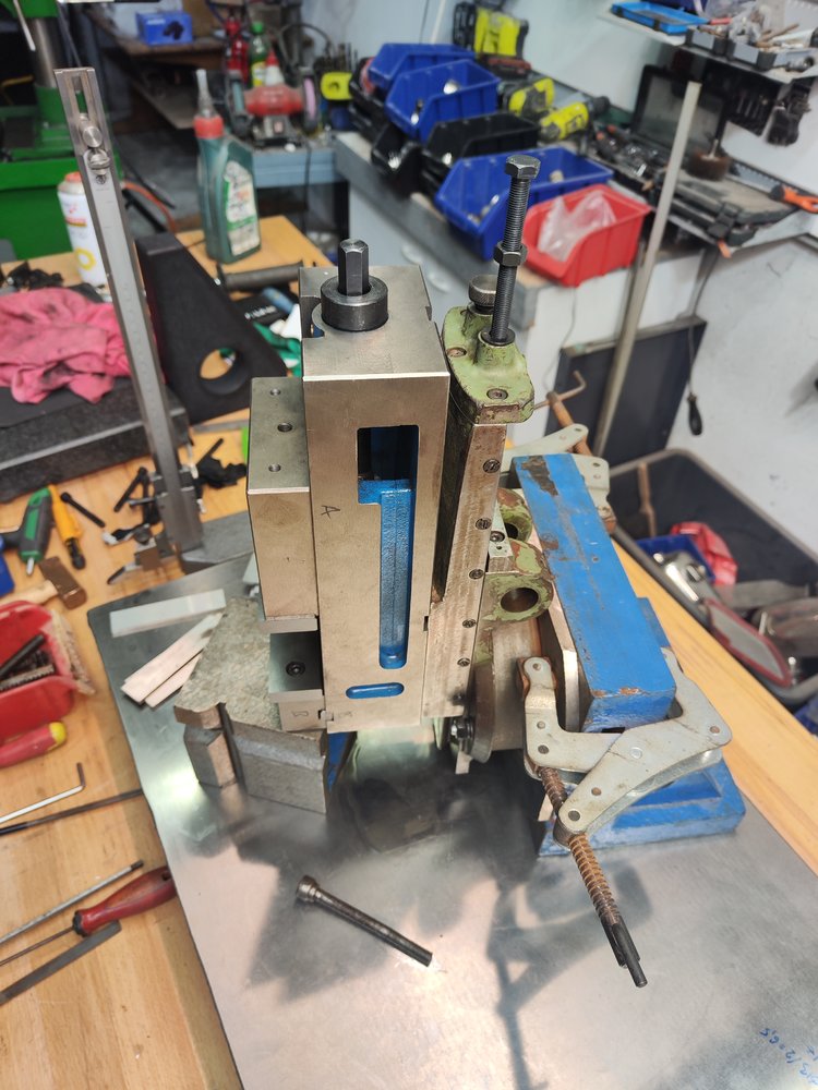

Are they scope rails?Off I went to my favourite grinding company and collected this solid carbide cutter I have had made, that was the easy part:

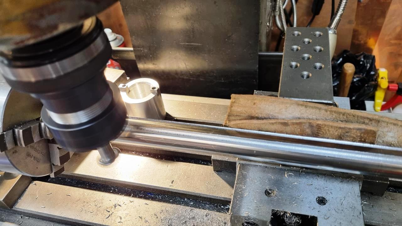

Now the setup, much swearing and head scratching went on, not straightforward:
There was that much going on I stopped twice for a break, double checked the double checking, put my Big Trousers on and without trying it out, just went for it:

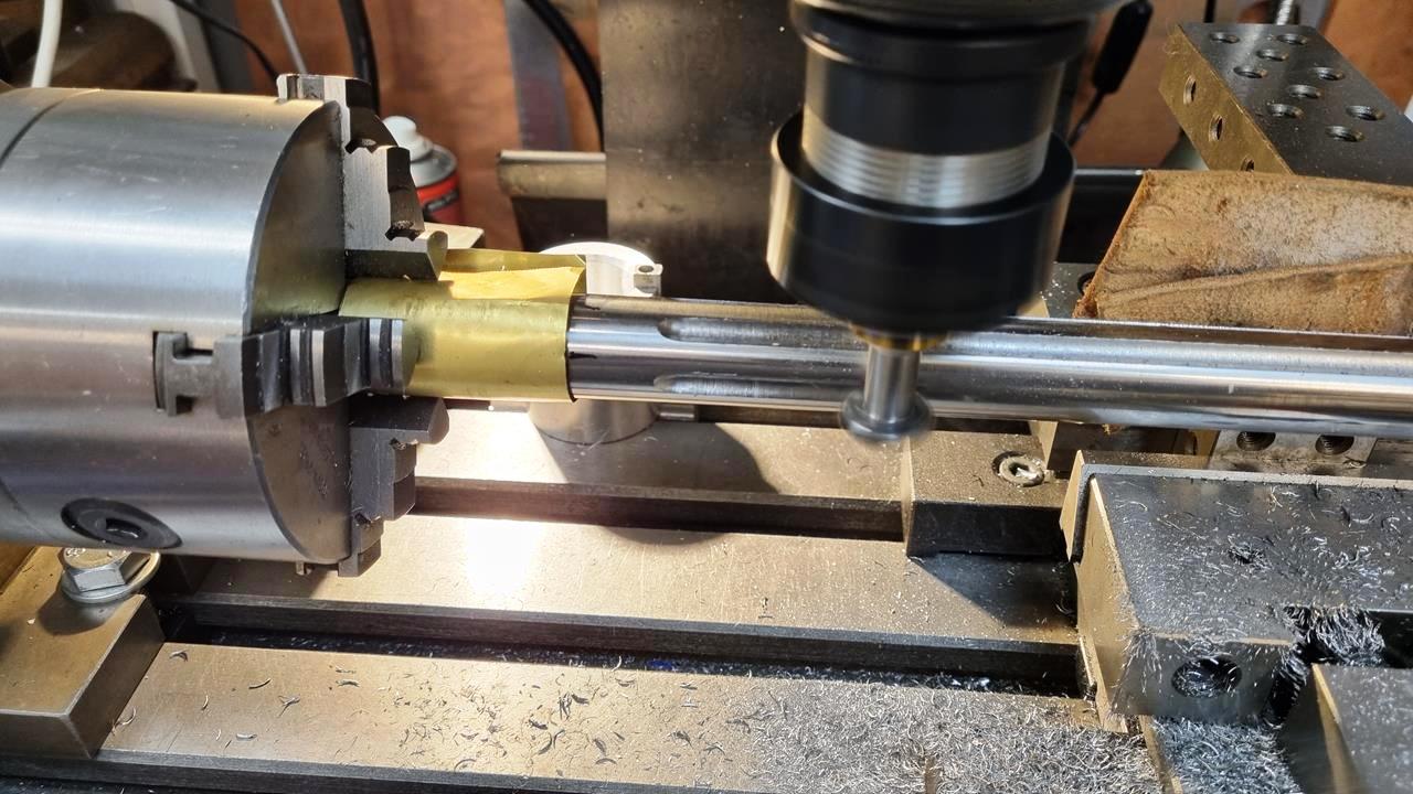

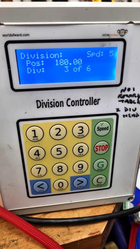

The trusty Division Controller did it's thing without missing a beat, I was papping myself in case the power went off.
I am ecstatic with the result:
Really looks the business.
That does look good, bet it went much faster than a ball nose would have.Off I went to my favourite grinding company and collected this solid carbide cutter I have had made, that was the easy part:

Nice work. What was the head scratching for - getting the cutter on centre?
That looks very, very expensive
Thank you, it wasn't as expensive as you would think. This company make tooling for all sorts of people and they are big enough to actually have an "aerospace division" If anyone needs anything special making I am happy to get a price for you, I have a bit of a special arrangement going on, that everybody knows about so not clandestine but not through the front office either.That looks very, very expensiveNice work

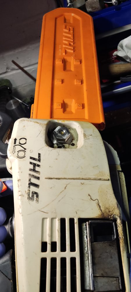

You can buy these nuts from stihl for a few poundsAnother nut, this for the Stihl 020T. 19mm hex, although M8 like the others.
Will need to make up a wire clip for it and drill couple holes.

Afaik Stihl dont use this style and not for the 020T. It may be that the newer ms201 side cover, with collar nuts, can be swapped but I havent seen any details of that. I know many other parts can be swapped.You can buy these nuts from stihl for a few pounds
