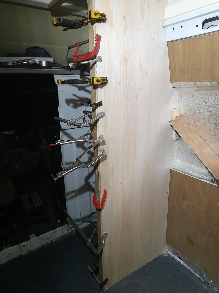

As a general bodger I used every clamp I had there to wood glue the ply edge.You need some more clamps.

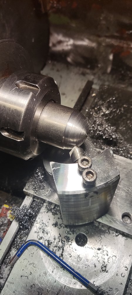

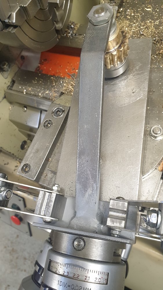

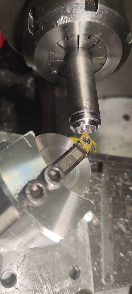

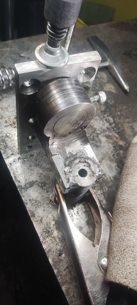

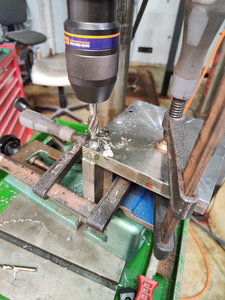

More details please, what is the rest of the setup and what gear are you making? Something I will try eventually.A brace for the toolpost stud for when hobbling. It was far too flexible the first couple of attempts.

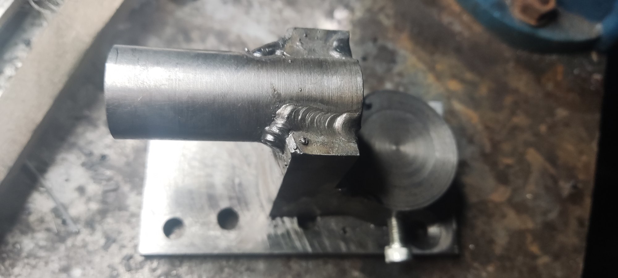

Could you when removing theb outer edges actually make is so th cutting bit comes out of a triangle point to give you a bigger max working range Will it have an extension handle fitted ? What range of radius will the balls be <The radius/ball turner. Not finished but enough to test.
Couldnt fit a bigger bar as too near top, 8mm appears to work. I think I will bore it out to 25 or 32mm and weld a bit on so I can use larger bars. If I should want to do large concave radiuses there would be a fair stickout.
I then discovered my 8mm boring bar has the insert pocket above centre, so it would never work well for this. The insert off to the side also makes it unsuitable, but tried it anyway.
I will make a dcmt insert boring bar for this with the point in the centre.
Found a cheap countersink and a short end of en3 rubbish steel. Actually works bloody well.
I will need to remove the corners from the upright which could be a job for the big facemill.

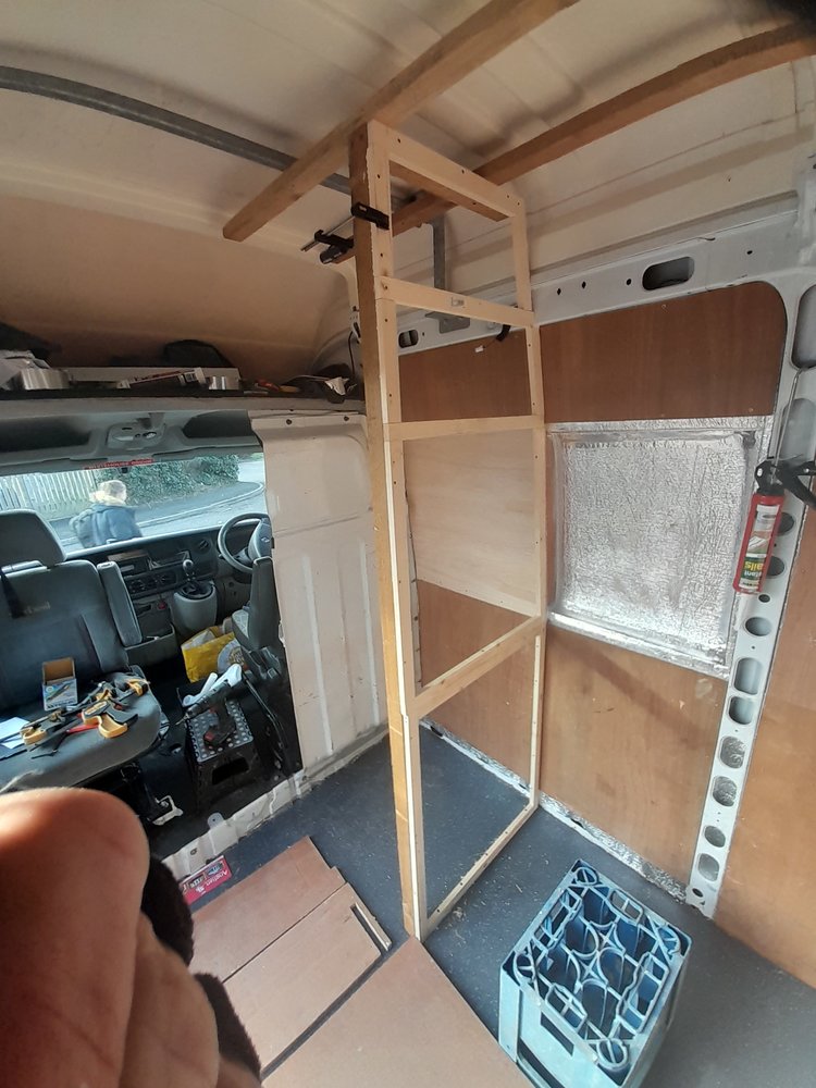

A hanging curtain from the roof on a rail would have done just as well in a fraction of the time , plus the curtain moves to accommodate the contortions when cleaning up and allows a bit of through view to the back doors when drawn back , it doesn't vibrate like a drum either .Today I have faffed about working out how to build a square wall in my decidedly un-square van for the Thunderbox.
I'm no carpenter & that's my excuse for taking all day to build the sodding thing

You can't hang/build overhead lockers off a Curtain though Dapph, plus my 2-seater sofa box will be built off this wall as well.A hanging curtain from the roof on a rail would have done just as well in a fraction of the time , plus the curtain moves to accommodate the contortions when cleaning up and allows a bit of through view to the back doors when drawn back , it doesn't vibrate like a drum either .
Yes that is the plan I am going to mill the tube face flat and from the OD of the tube to the back corner, so somewhere around 60 degrees I imagine. It would have been much simpler if I started with 30mm thick plate and bored a hole to weld in a 50mm bar as the upright.Could you when removing theb outer edges actually make is so th cutting bit comes out of a triangle point to give you a bigger max working range Will it have an extension handle fitted ? What range of radius will the balls be <
I'll start another thread, it's a bit long winded to clutter up this oneMore details please, what is the rest of the setup and what gear are you making? Something I will try eventually.
