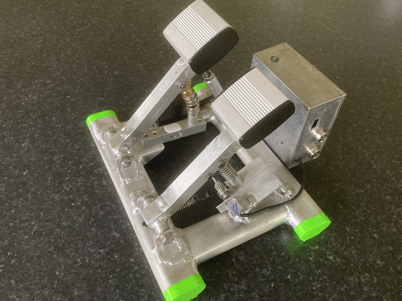

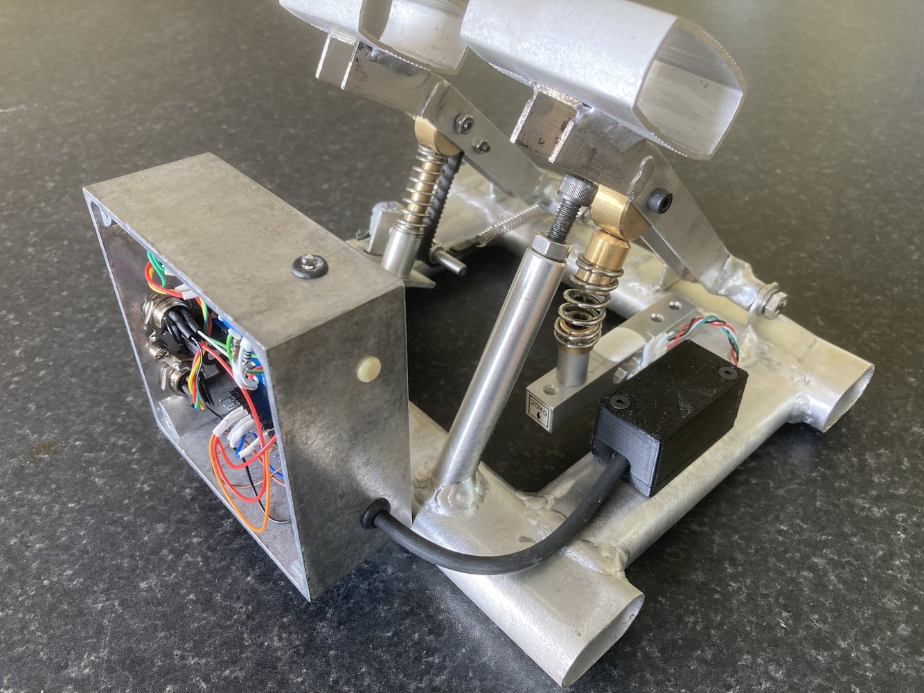

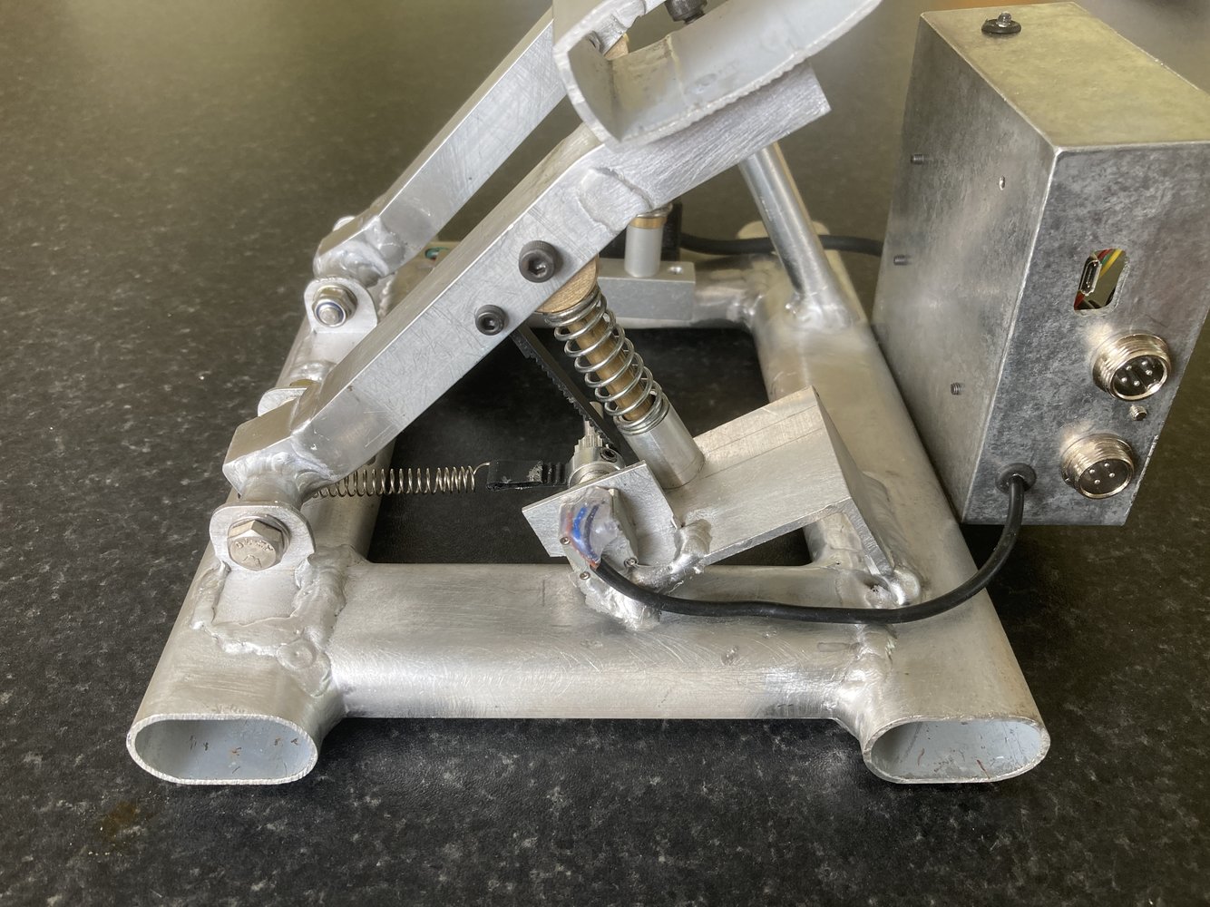

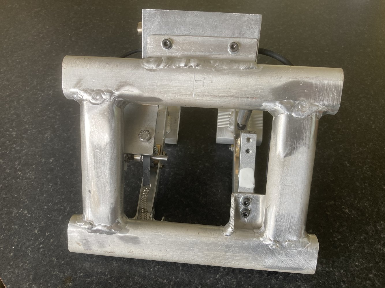

(Look away now if disturbed by shoddy welding).
Did you design the load cell yourself or pinch it off a bathroom scales?Practicing my aluminium TIG (goodness knows I need it!) to make some pedals for a car racing computer game. (Look away now if disturbed by shoddy welding).
The metal was mostly 1.5mm wall extrusion from an old ladder. It had been anodised, but I stripped it with with caustic soda. It wasn't the nicest stuff to weld, but that's it - I'm out of excuses.
View attachment 453543View attachment 453541
With the addition of some 3D printed end caps in PETG and some feet in TPU
The 'brake' pedal uses a load cell and the 'accellerator' pedal uses a pot. Electronics is all handled by an Arduino Leonardo. The sockets on the side are for a force-feedback steering wheel. Windows recognise the whole thing as a USB game controller so it's 'plug and play'.
No, it’s an arduino thing: load cell, amplifier and ADC £4.49!Did you design the load cell yourself or pinch it off a bathroom scales?

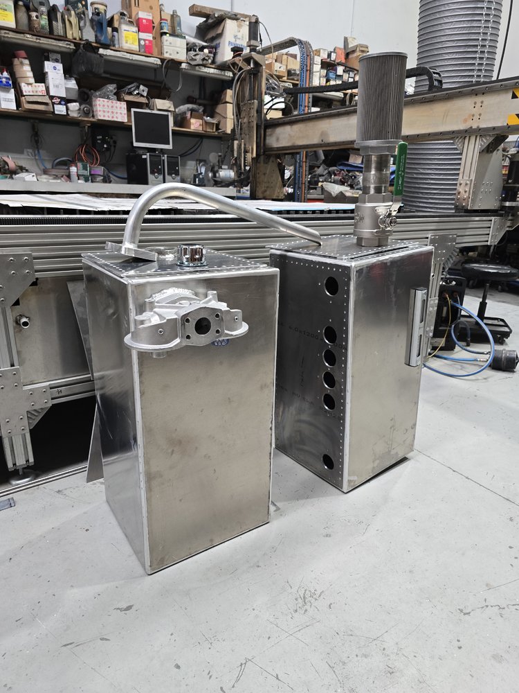

Meth lab ?Been away this week installing this little setup.
Skid built in the workshop. Brackets and valve manifolds built on site to suit.
You've probably seen the naked frame a few weeks ago, and the tank and hopper in stages already.
View attachment 453430 View attachment 453431 View attachment 453432
