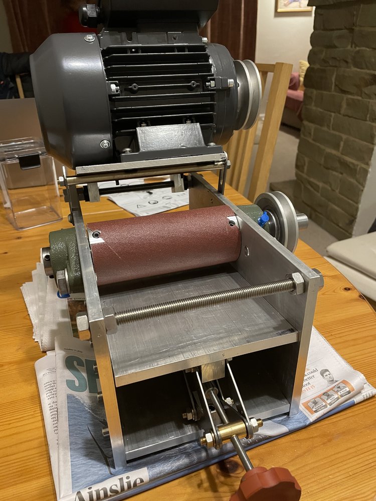

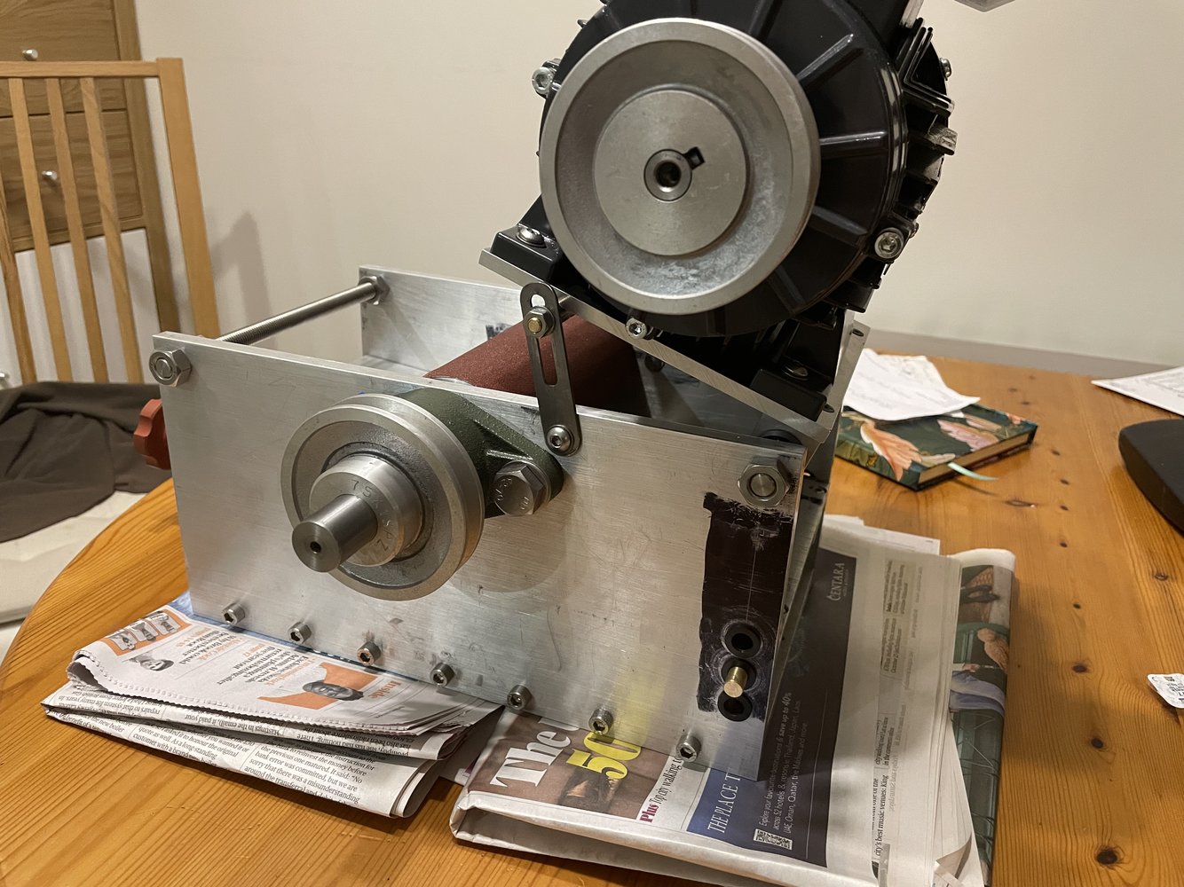

That's looking goodA bit more progress on the thicknessing sander. Finished machining the drum and its shaft, with a couple of semi-circular buttons to hold the abrasive strip. And made an adjustable motor mounting plate. I’m sure I’ve got a little v belt somewhere but blowed if I can find it so I’ve ordered a new one. Now it needs a guard for the belt drive and a guard/dust extractor hood to go over the drum, which I think will be 3D printed D-shaped ends and a sheet aluminium cover bent round in a semi-circle. If I’m feeling adventurous I might tig a bit of tube onto it for the shop-vac.
