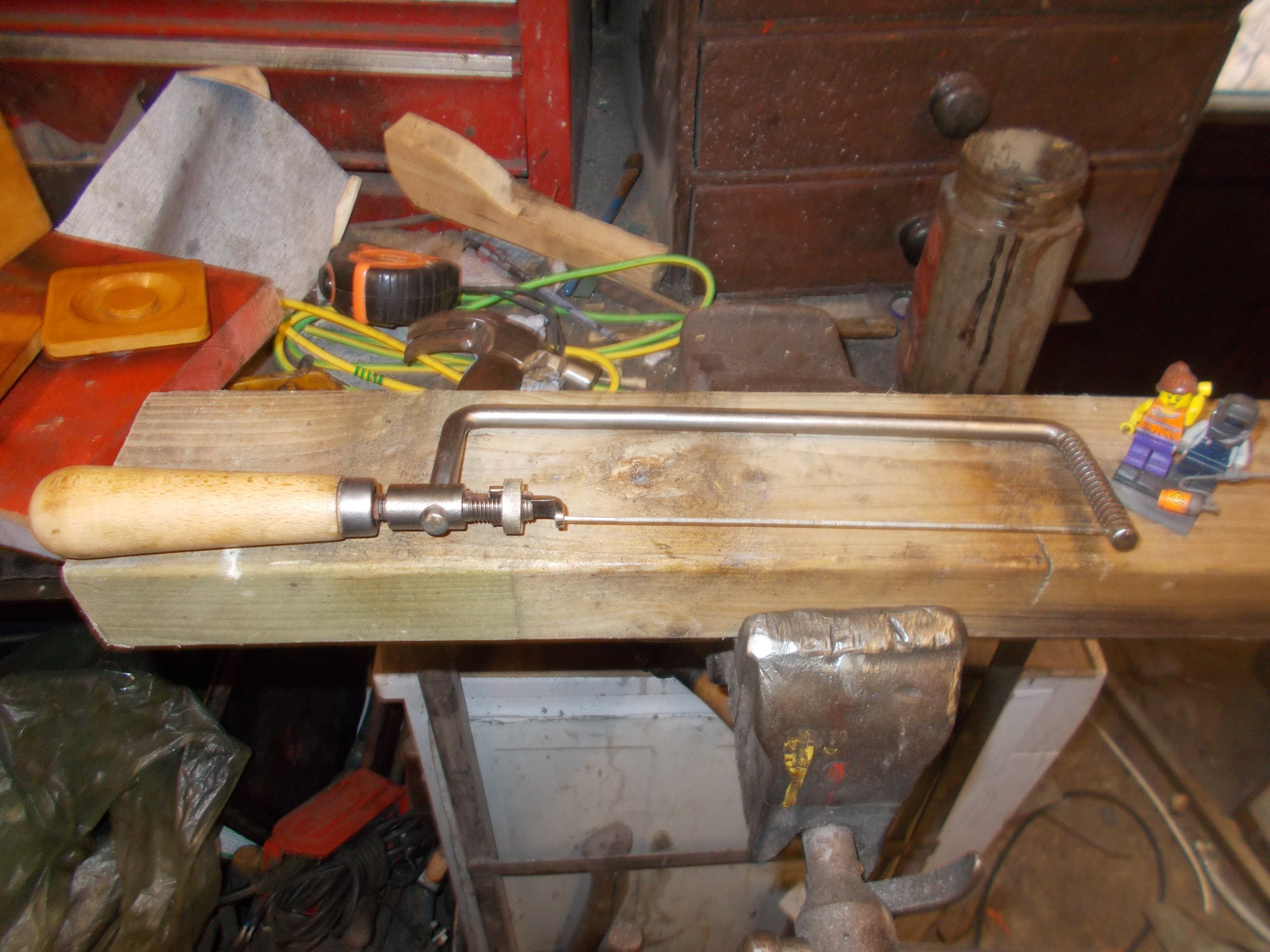

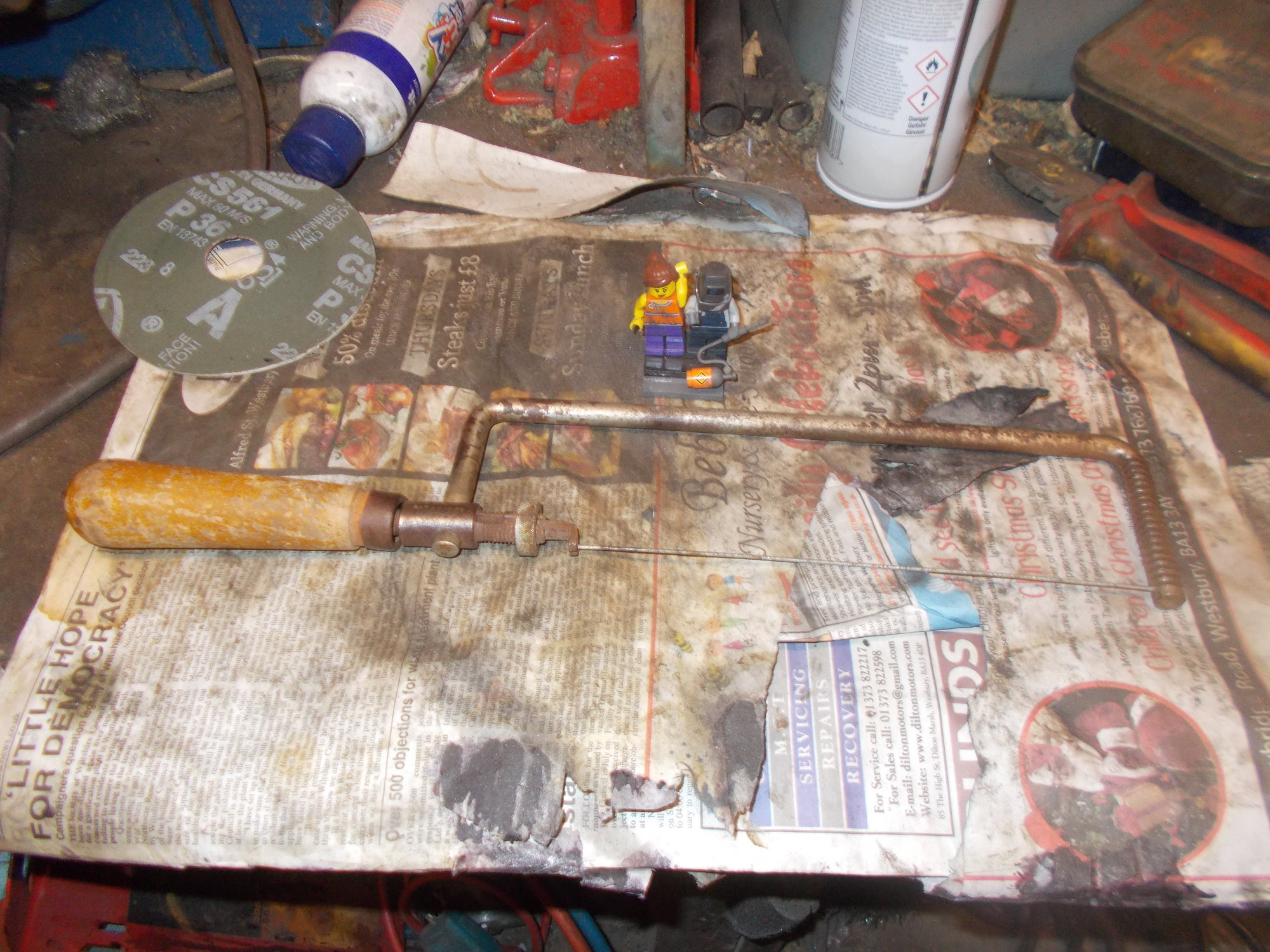

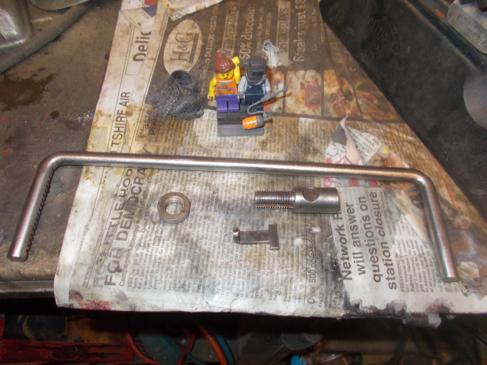

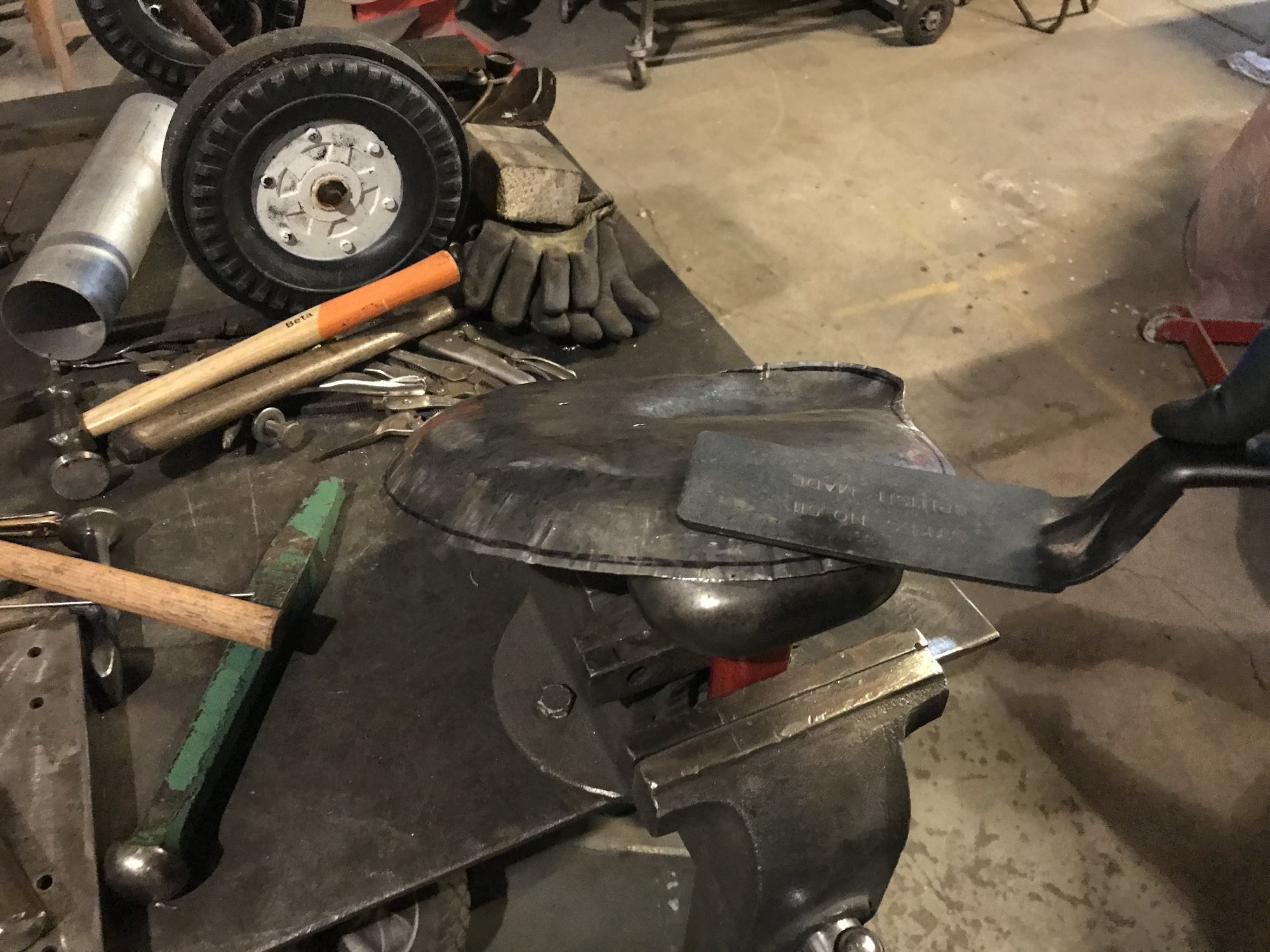

The other day I got this Abrafile saw. For a few pounds.
I knew the handle had 2 worm holes in it, I planed to replace it. What I didn't know the frame was cracked.
The handle was not as bad as it could of been. The worm was old and not active. But It was treated as a precaution.
The frame had some poor chrome plating, more flake than coat. But as I was cleaning it up the crack, in the fixed blade end let go and it broke into two.
Oh Bother. A quick call to a friend and a meet up was arranged. The frame is imperial and my friend had some scrap round bar. So armed with folding money, coffee and Hob Nobs I set out.
Long story short. A bar was bent into a replacement frame. Then the old was cut clean and the new cut to suit. Turned on a lathe to give a step. Then he TIG the 2 parts up.
You can just see the heat bloom on the frame before I cleaned it up.
I know I could of gone back to the place I got it from and got either my money back or a replacement. But were is the fun in that.
