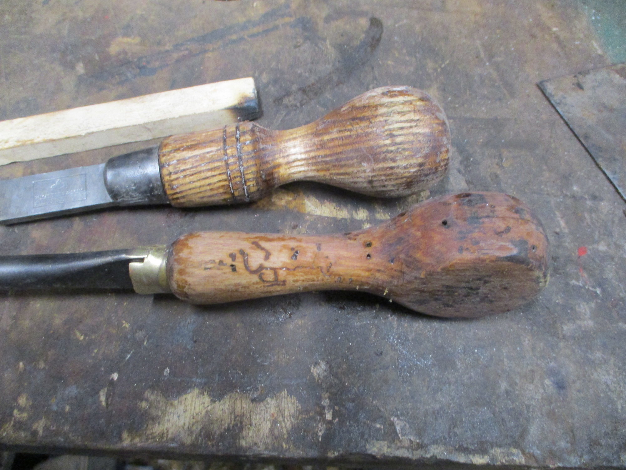

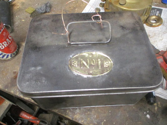

View attachment 221869Made a couple more of these. Ferric Chloride etching after masking off with vinyl stencils usually used for Van signwriting. Sprayed with Enamel and then sanded back before a quick polish.
You've made a fine job of them Rob, well doneView attachment 221869Made a couple more of these. Ferric Chloride etching after masking off with vinyl stencils usually used for Van signwriting. Sprayed with Enamel and then sanded back before a quick polish.
I did wonder if Ferric Chloride would etch brass or Copper.
It sure will do copper, it's what you use for PCBs and they're copper traces. Brass it should do as well but being a mixture of metals I'm not sure how each would react in terms of time needed to cut. Worth a try though - watch for the fumes.I did wonder if Ferric Chloride would etch brass or Copper. Would be nice to 3D etch and then get things chromed. Any ideas?
It's used for PCB manufacture as standard, so copper's definitely okay. I've also used it with Aluminium Bronze and with Brass with good results.

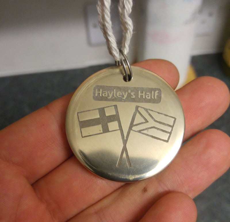

Managed to find a photo - Google Photo search is very clever...
Back in 2016, a friend of my OH's (called Hayley) who lived in Finland was lined up to run a half marathon in her home country (South Africa) and had been doing a lot of training. For various reasons, Hayley couldn't travel and was going to miss the half marathon but she decided to run the race in Finland on her own at the same time as the half-marathon was going on in South Africa.
I made her a medal out of some aluminium bronze so she could be given something when she finished the race. This was my first ever attempt at etching, so while it's not perfect, I was quite pleased with the result.
