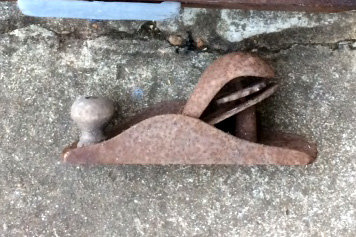

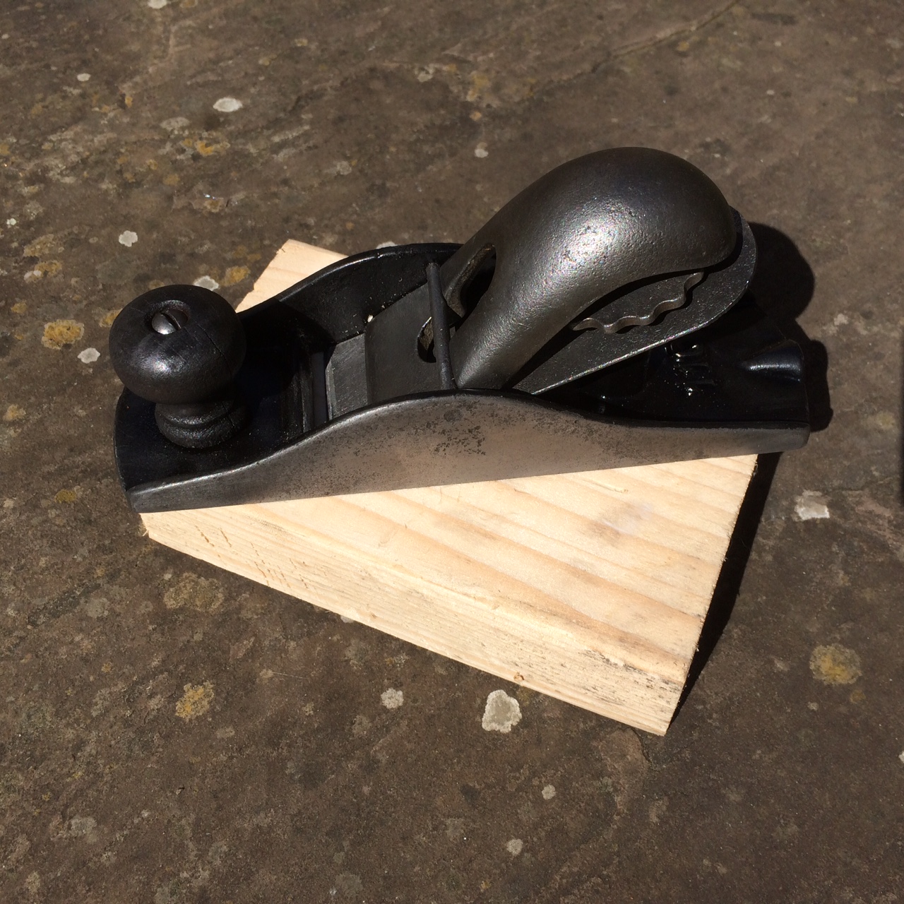

There is no indication of manufacturer cast into the plane just 110
Yep, I guess so.A rip-off of the Stanley 110.

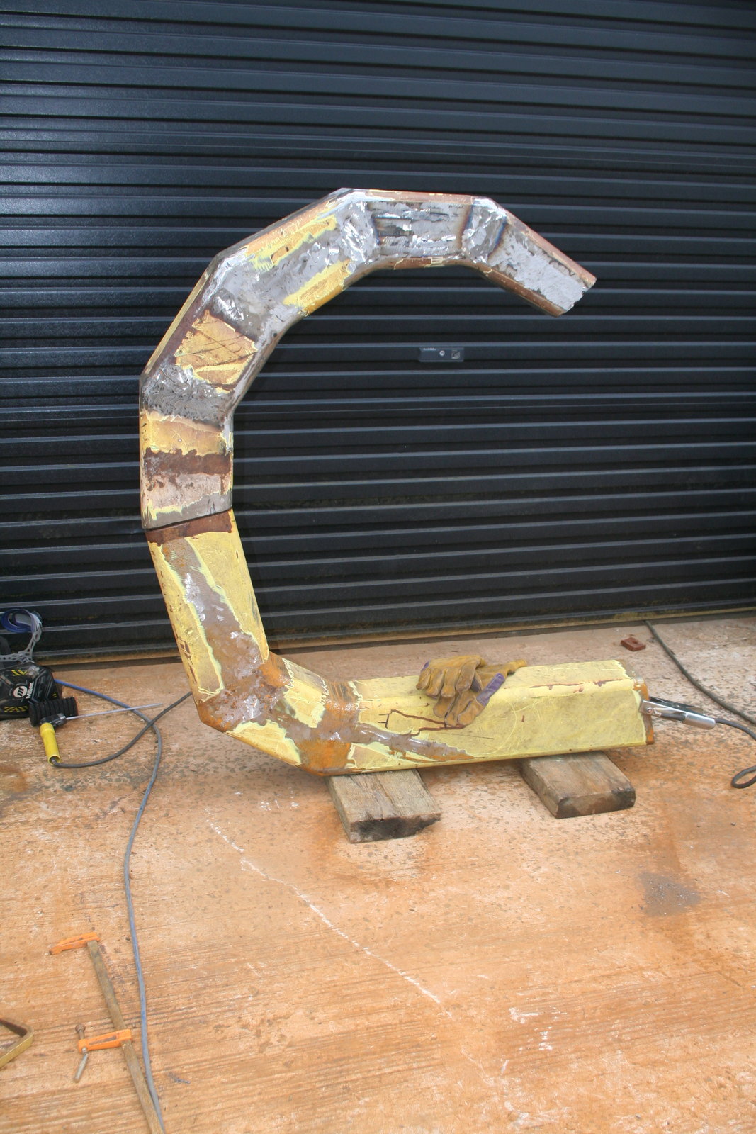

Today I made a heavy duty scorpion's tail -
Blimey!! How big's the finished article going to be?![]()

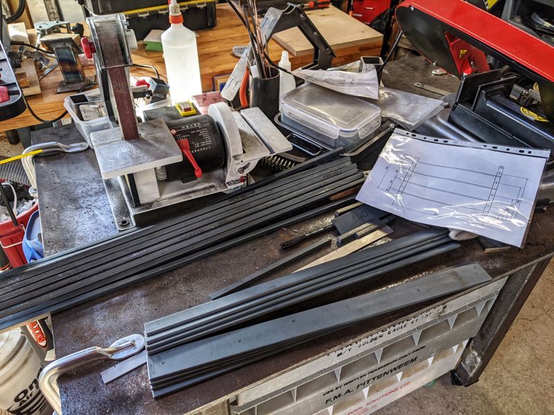

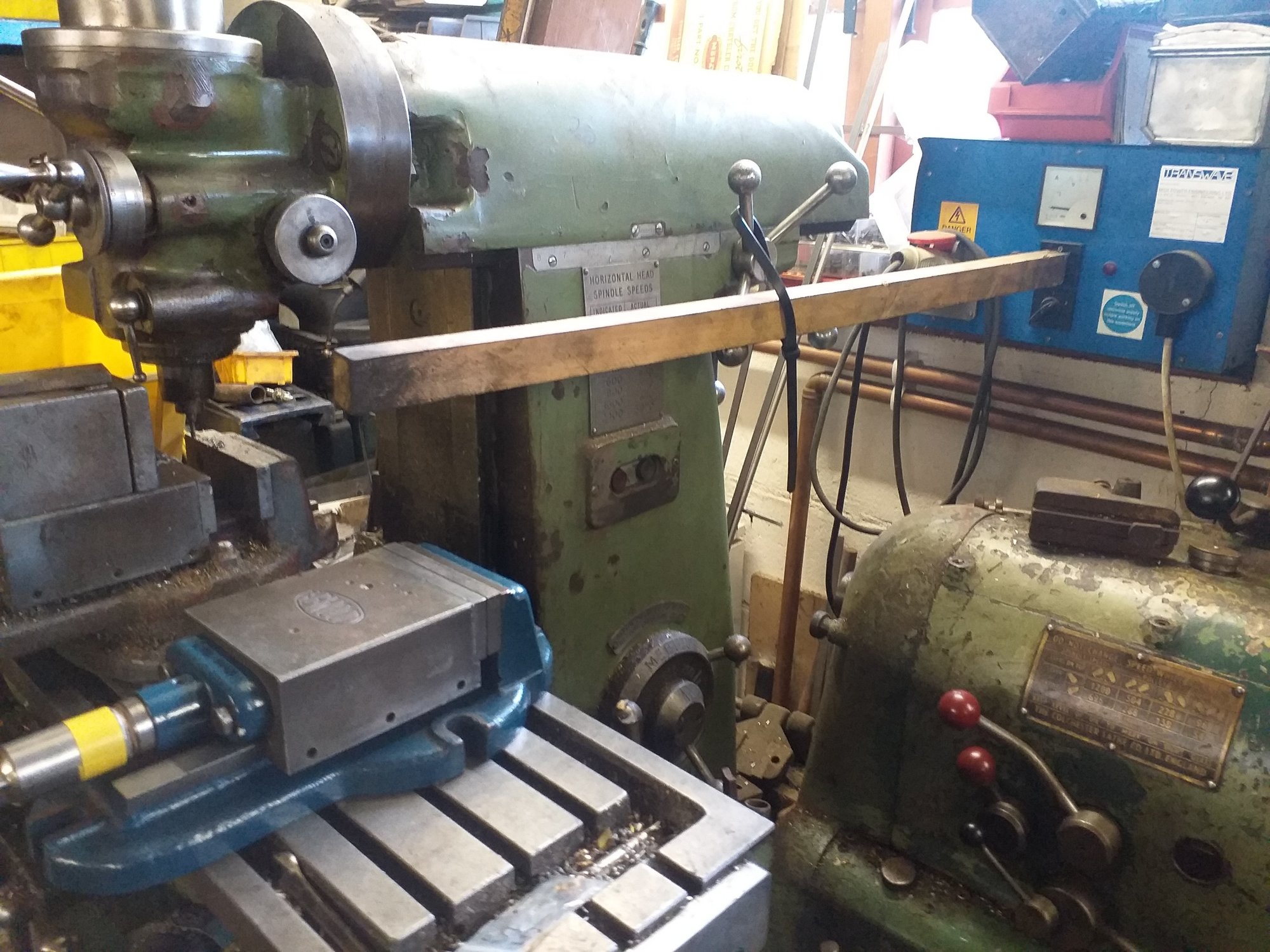

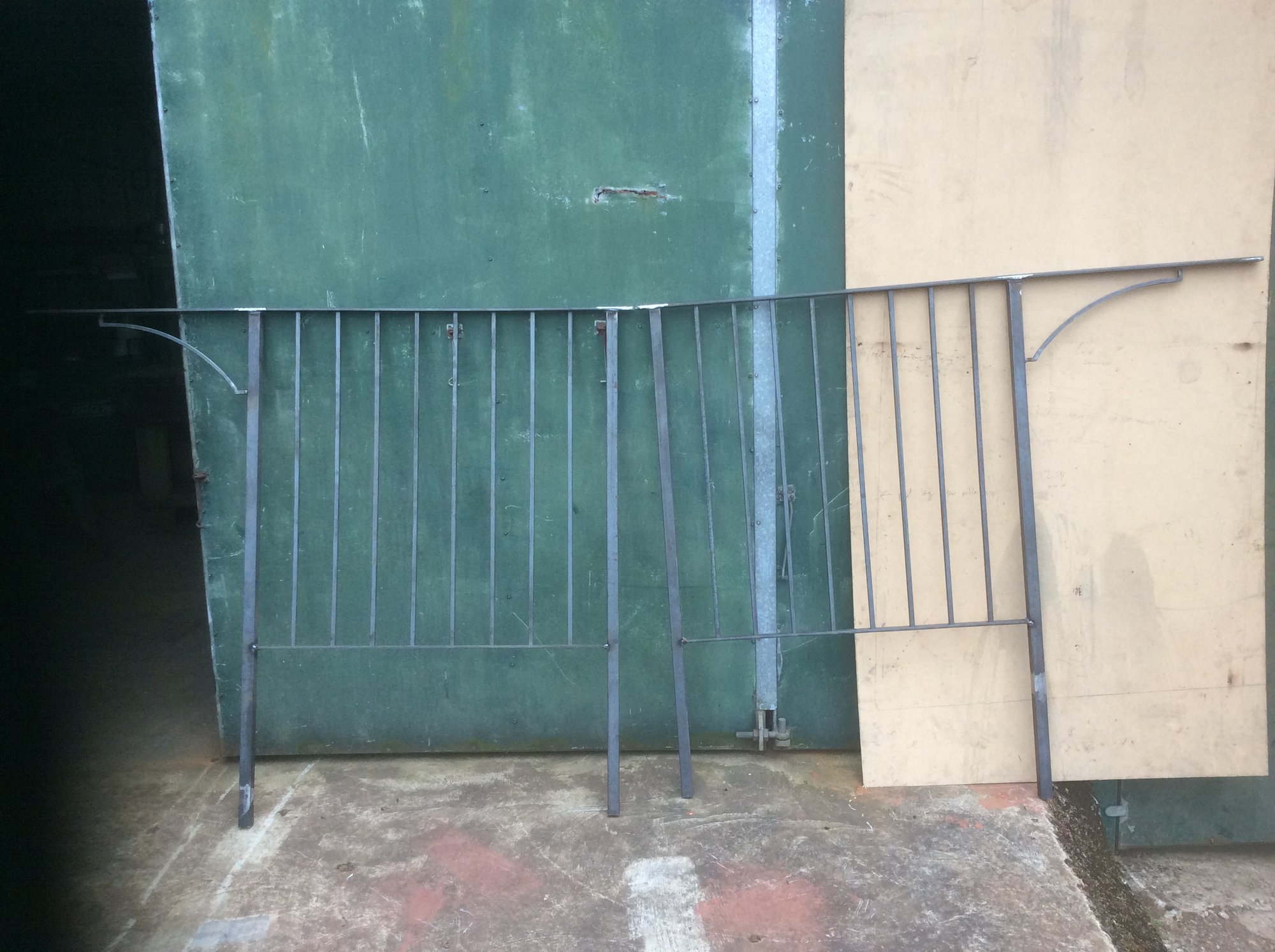

Man, you live in the land of the Fly Fifers, they will just nick the bars as wellAfter an hour or so at the 'puter finalising dimensions I enjoyed a few hours in the workshop cutting and getting set up for the closest I've ever come to a production run! Horizontal bars across the windows in the workshop to beef up security as we're a bit more wary since it seems someone tried to nick the trailer.
